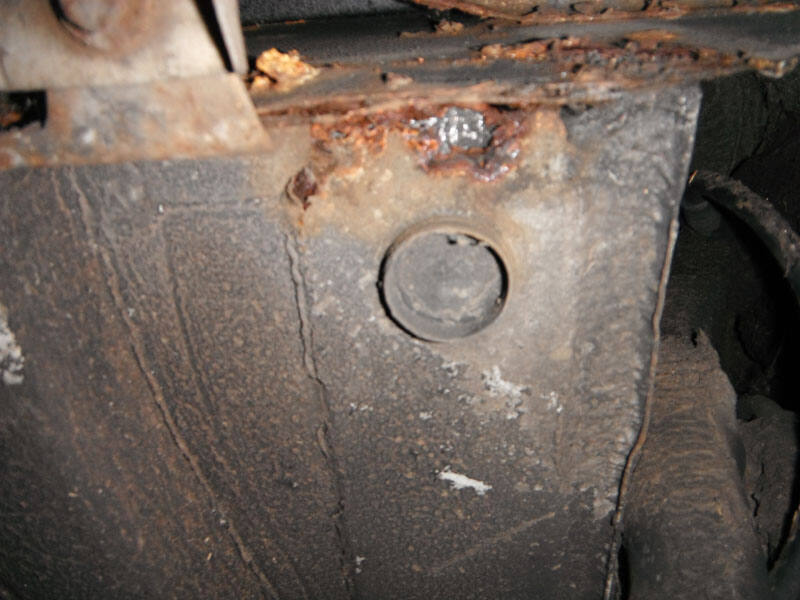

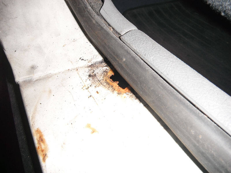

As Tim says rust is the enemy, get a solid shell and half the battle is won, hydraulic pipes can be replaced fairly easily, parts availability is pretty good for the mechanical side of things, if you get a chance look at the rear axle mounting area for rust from under the back seat as this is the area you want it least, a tell tale sign is rust at base of c-pillars and rusty inner and outer sills, probably accounts for many a bx's demise.

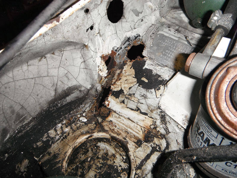

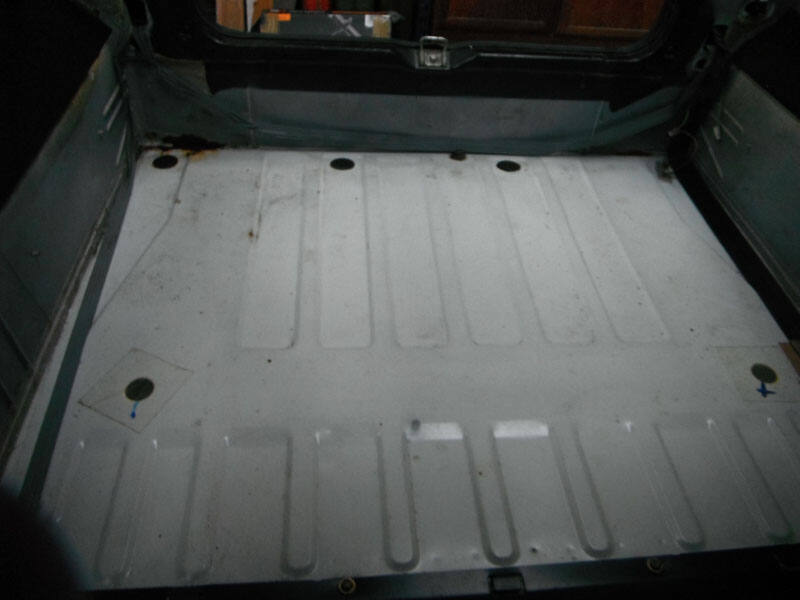

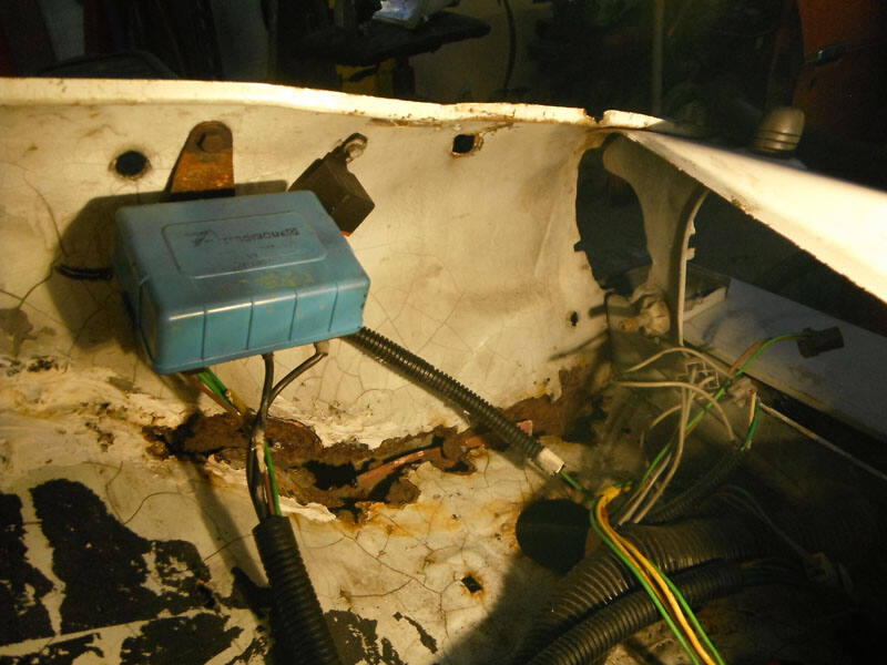

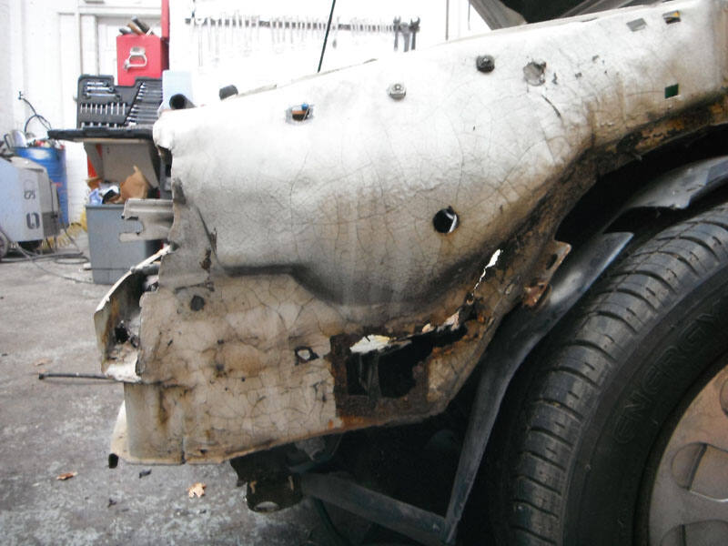

As above, the suspension isn't much of a worry these days, it's rust that's the killer. If you can DIY the rust repair most of the bad areas can be sorted fairly easily, a lot of the shapes are very simple. The one I've got had rot in the usual places.
Boot floor.
Front inner wings.
Front tow hook
Outer sill door step seam, front door.
It's already had the rear end of the sills repaired by a previous owner, and some of the windscreen surround which are also common rot spots. The tricky areas to see is the bulkhead seam that's hidden with the sound deadening panel in the engine bay, and the front inner wing strengthener section that runs down from the A-pillar but if the car is good elsewhere these areas should be in good shape too.
