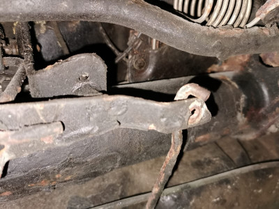

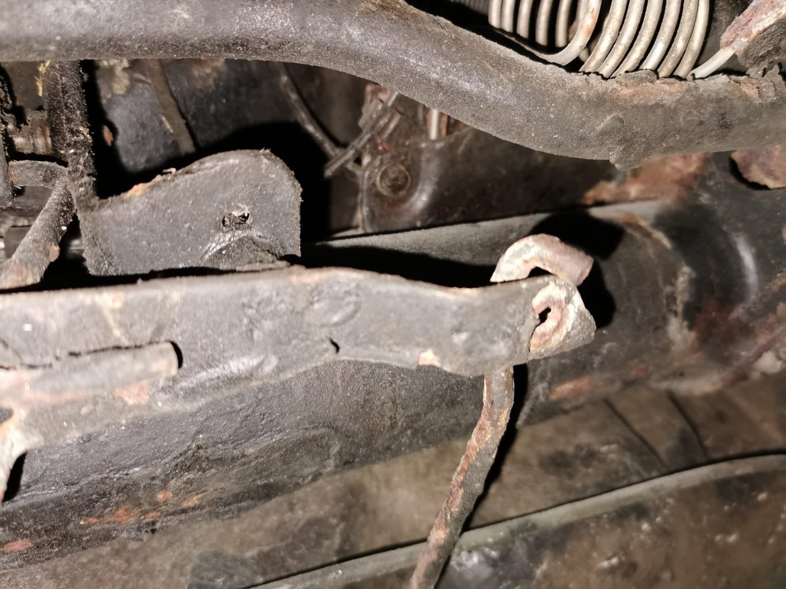

Hello All,
BX GTi 8v - just noticed that the rear height adjuster linkage has come adrift as the little L shaped rod has parted company from the hole in which it should reside (please see picture). It isnt possible to fit it back in - for instance by bending - as the rod goes through a slot in the bracket shown but out of sight in the photo.
Anyone have any suggestions please?

Remove the link. Free the the 13mm nut from between and remove the 13mm bolt. You have so much rustproof on the link so one can't see the end of the bolt..
