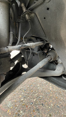

Naturally, she isn't perfect. My defects list thus far :
Passenger side needs new door mirror, as the arm is snapped.

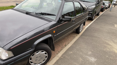

Front bumper not mounted on the return to each wing - as per pictures
The radio is dead. No worries, I need one with hands free anyway.
Small clunk when reversing , then braking. From what sounds like front near side.
The clutch is a little stiff and low.

Btw the clunk when braking on reversing is the front brake pads moving slightly in their housing due to the retaining spring not being 100%. Not dangerous in the slightest as the pads can’t come out, and is just an annoyance rather than something to worry too much about

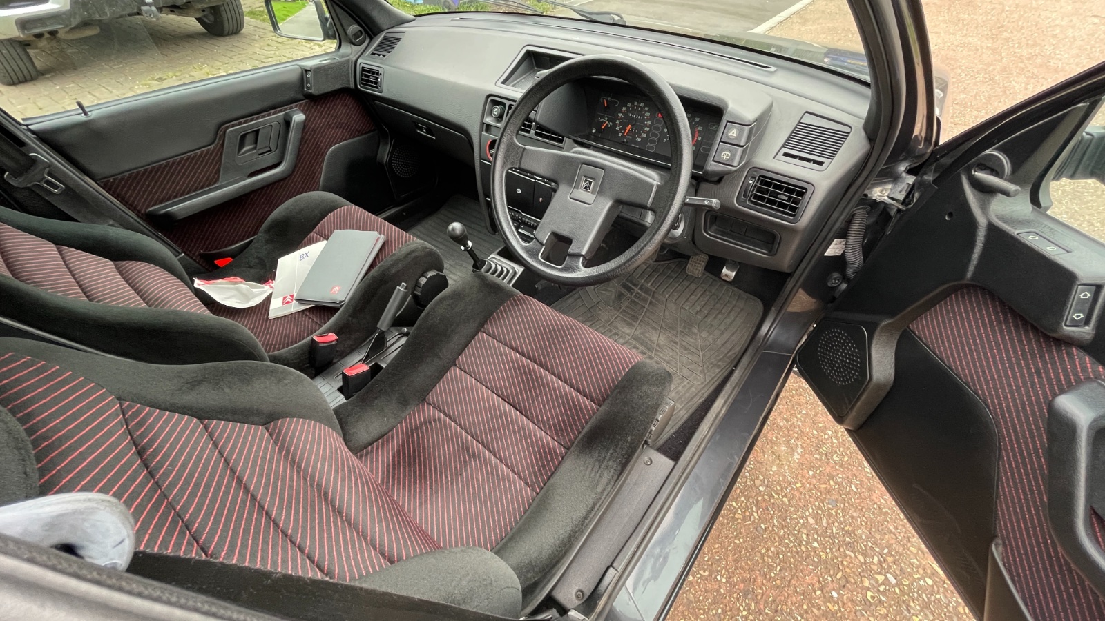

That interior is something! Well done.

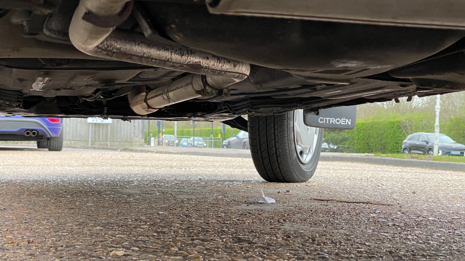

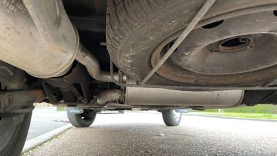

With a car in this condition, if you are going to expose it to the elements, I would strongly encourage you to get cavity rustproofing done by a specialist, before water/dirt/salt start destroying the steel.
I previously recommended Rustbuster https://rust.co.uk , but they have recently ceased their in-house rustproofing services, and are concentrating on supplying products. I would trust them to recommend a specialist in your area. The other thing that they should be able to supply is a diagram of all the cavity injection points for a car, I think there were about 50 for my XM.
