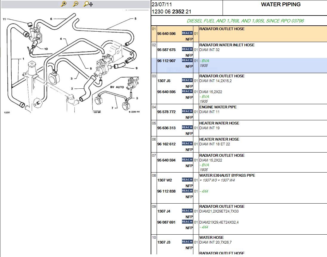

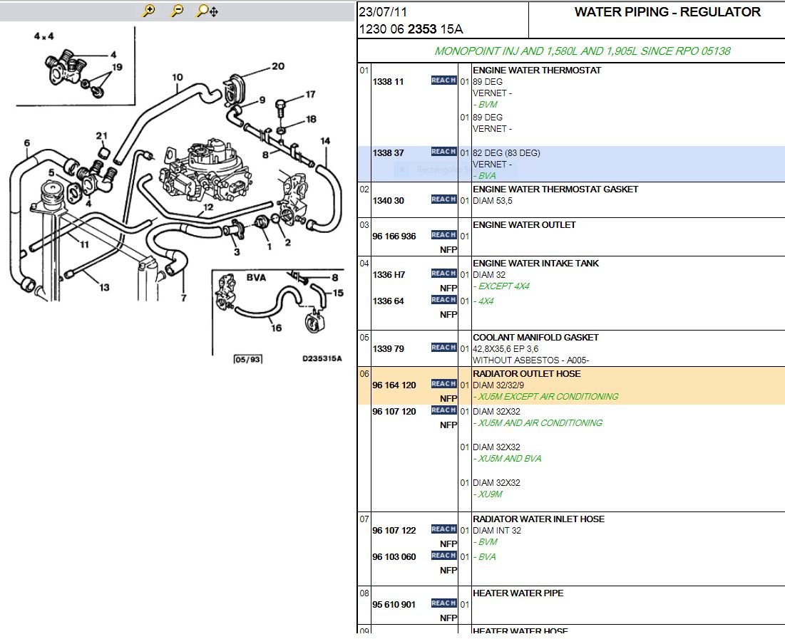

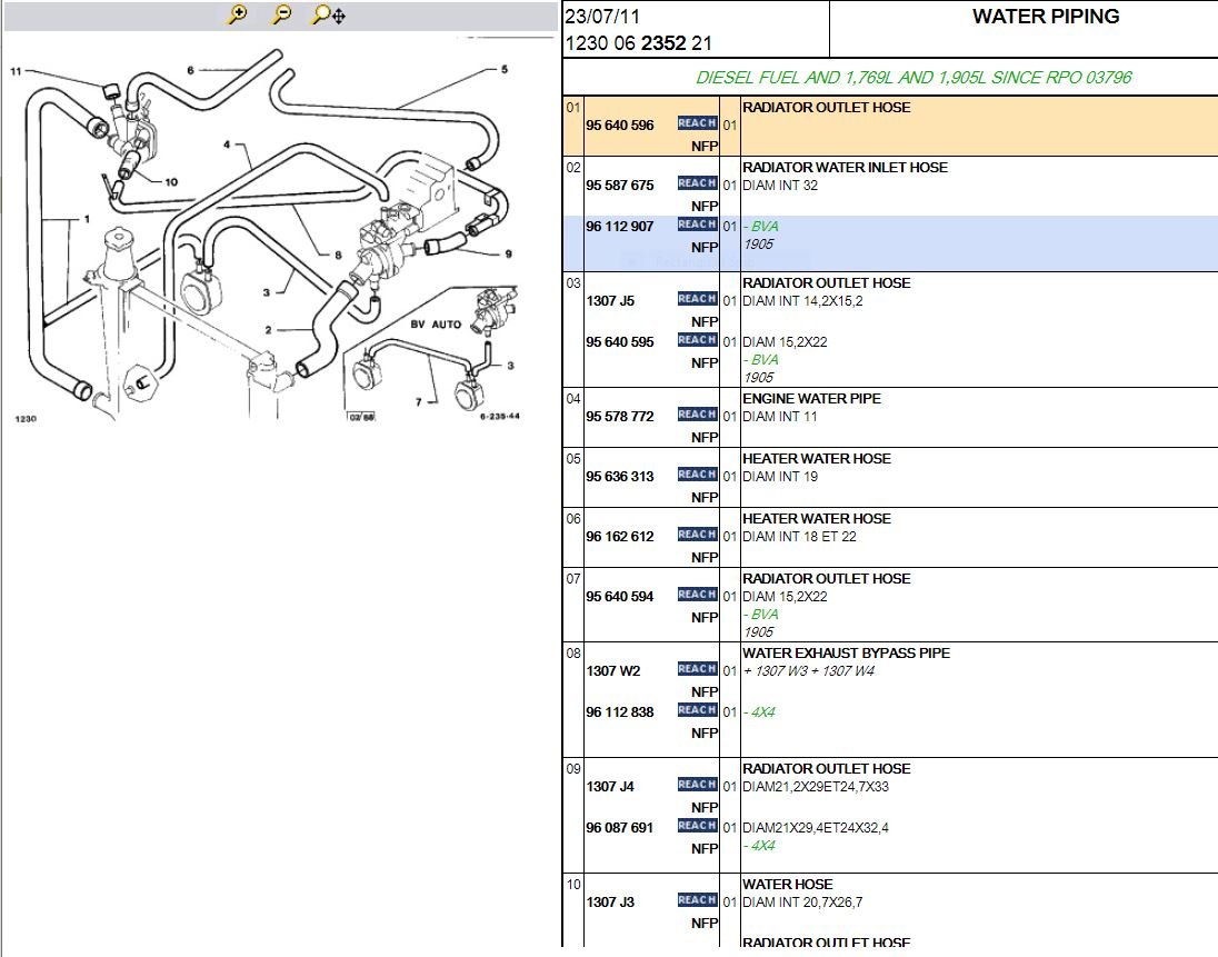

Both are apparently bottom hoses for no air con bx

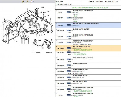

95640596 - this looks identical

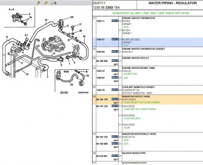

And 96164120 - I believe this is the correct part no for my bx
Are they interchangeable - can anyone assist pls ?
Are these part numbers interchangeable, how can I tell?

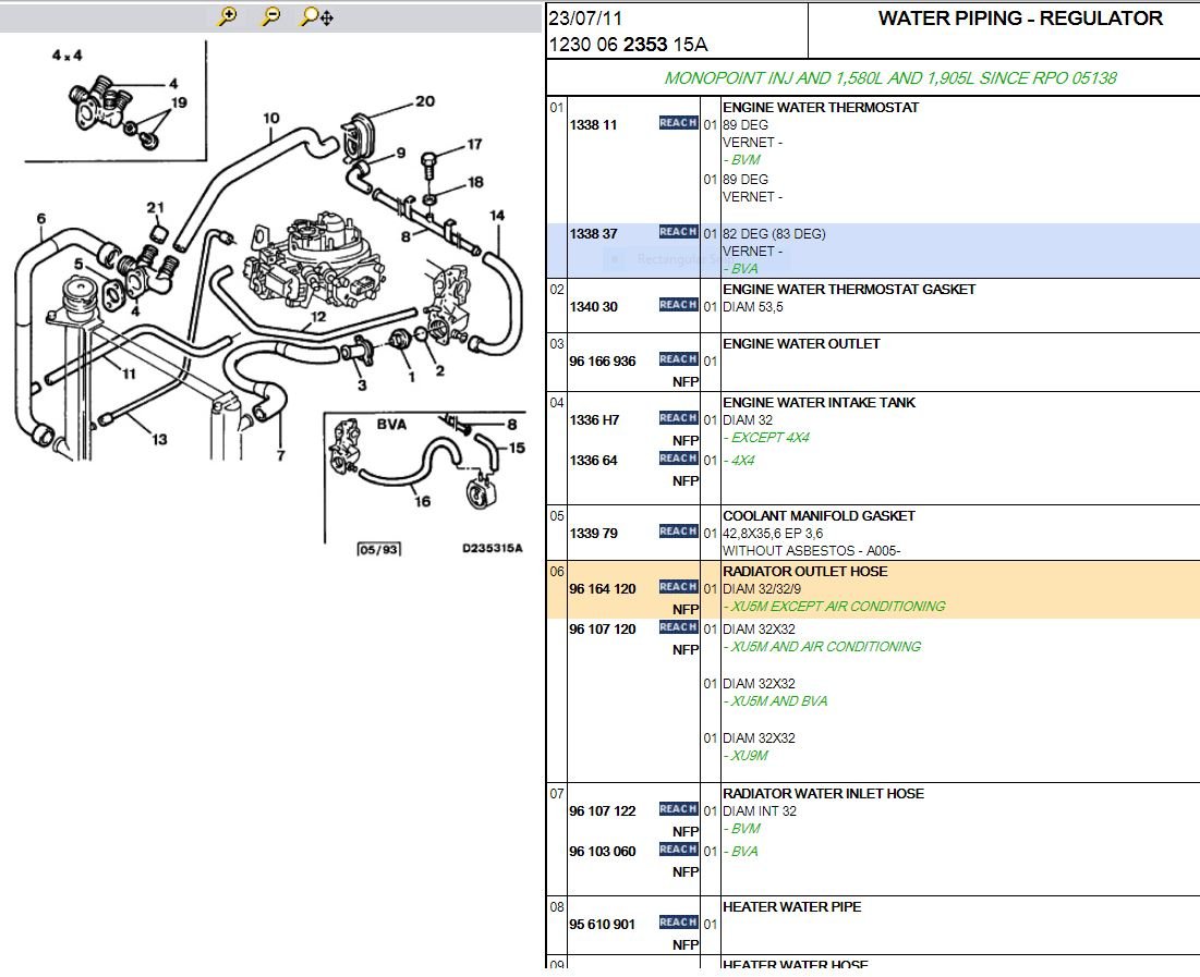

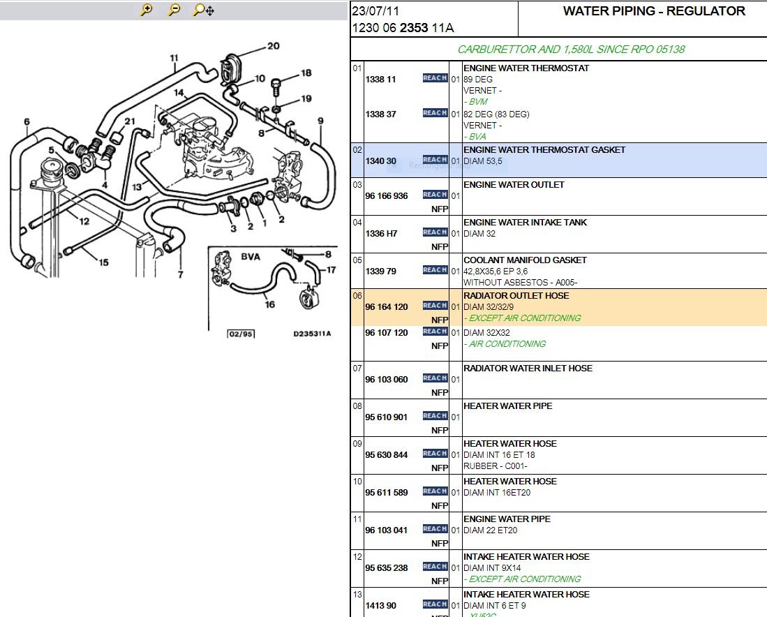

These are the models that those two part numbers are listed for...
Pcheaven
- Posts: 229
- Location: Kent
Re: Are these part numbers interchangeable, how can I tell?
Very helpful - thanks for checking for me
So not compatible
The search continues for a bottom hose.
