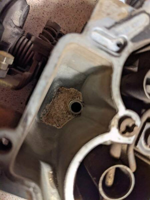

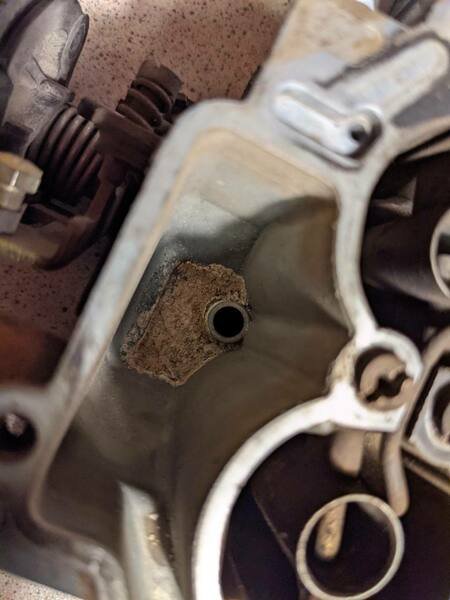

The Solex 32/34 carburettor I installed yesterday came from Spain, which must have been using E10 a fair while before us. The bottom of the fuel bowls, accelerator pump and power valve were filled with corrosion. It also stunk of old petrol, so it clearly was sitting on a shelf for a long time.

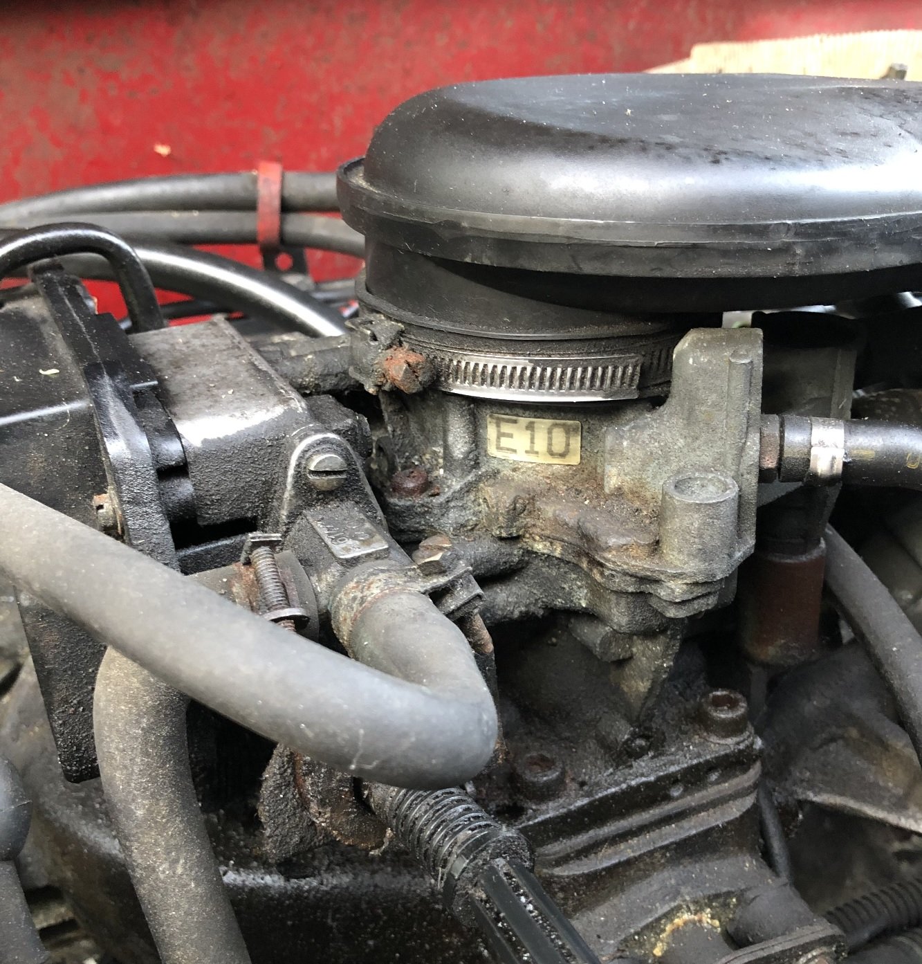

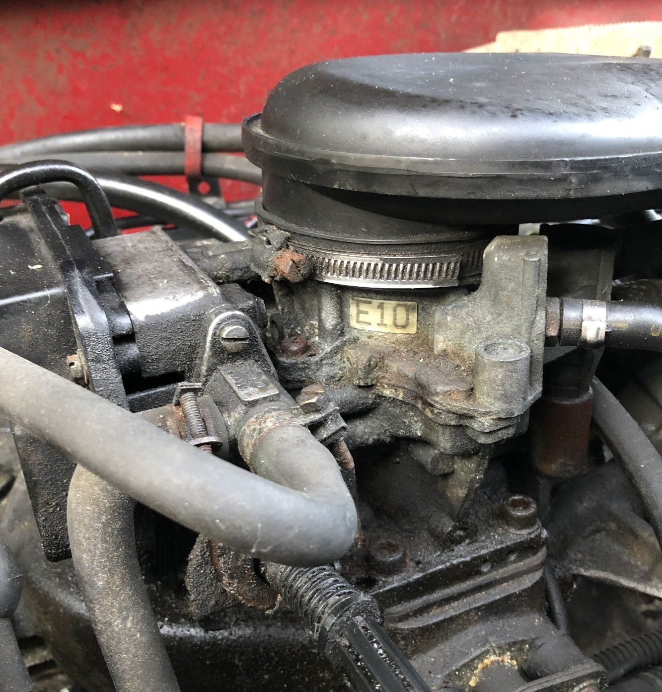

On a somewhat related topic the carb on my BX 16 TGS has a label 'E10'.
Is this just coincidence or were Citroen ahead of the game in 1992 and already planning for ethanol content?

Routemaster wrote: Sun Nov 21, 2021 9:40 pm On a somewhat related topic the carb on my BX 16 TGS has a label 'E10'.
Oh, that's what the silver label is supposed to say! I stuck one of those carbs with a manual choke on my BX 14 a couple weeks ago and I couldn't make out what it said.
Posts: 6437
Re: E10 petrol
Could be, it's been around much longer than everyone thinks.

My new carb originated in Spain, which has had E10 for longer than we have
The corrosion in the bowl was pretty spectacular.
