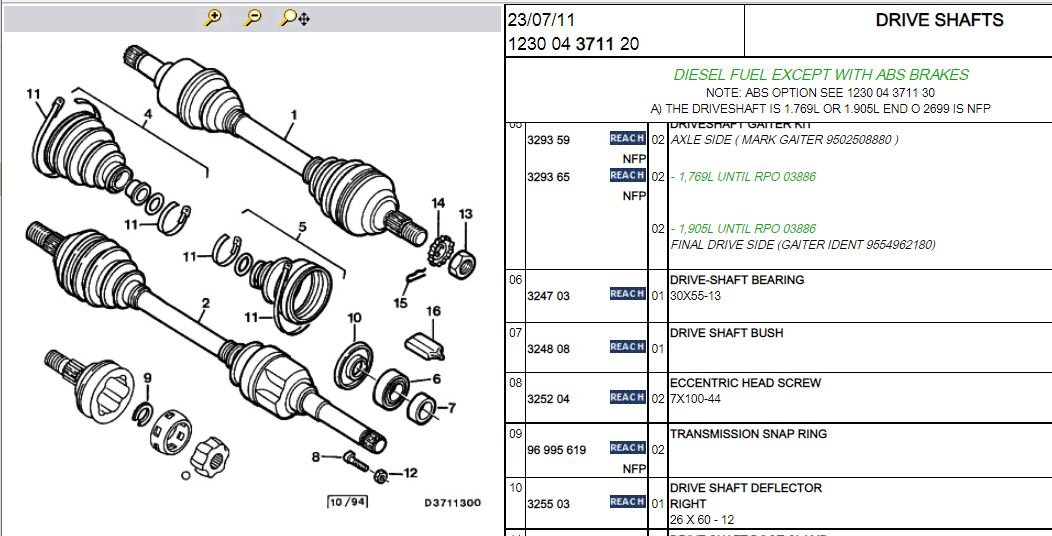

Both shafts on the 19D are knocking still, even after injecting fresh grease.
The r.h. outboard bellows has a small split, and has thrown grease out, resulting in an MoT/ITV failure this morning.
Am going to replace both shafts, and have located most of the parts
- SKF VKJC5303 and ...5092 shafts on Mister Auto
- diff oil seals still available from Citroen
...but cannot find the pt.no. for the r.h. shaft support bearing (and its 'sealing ring') anywhere - not even in Cit. Parts.
Can anyone help with a part number for this?

The bearing is the same as a 4WD propshaft support bearing, if that number is easier to find
