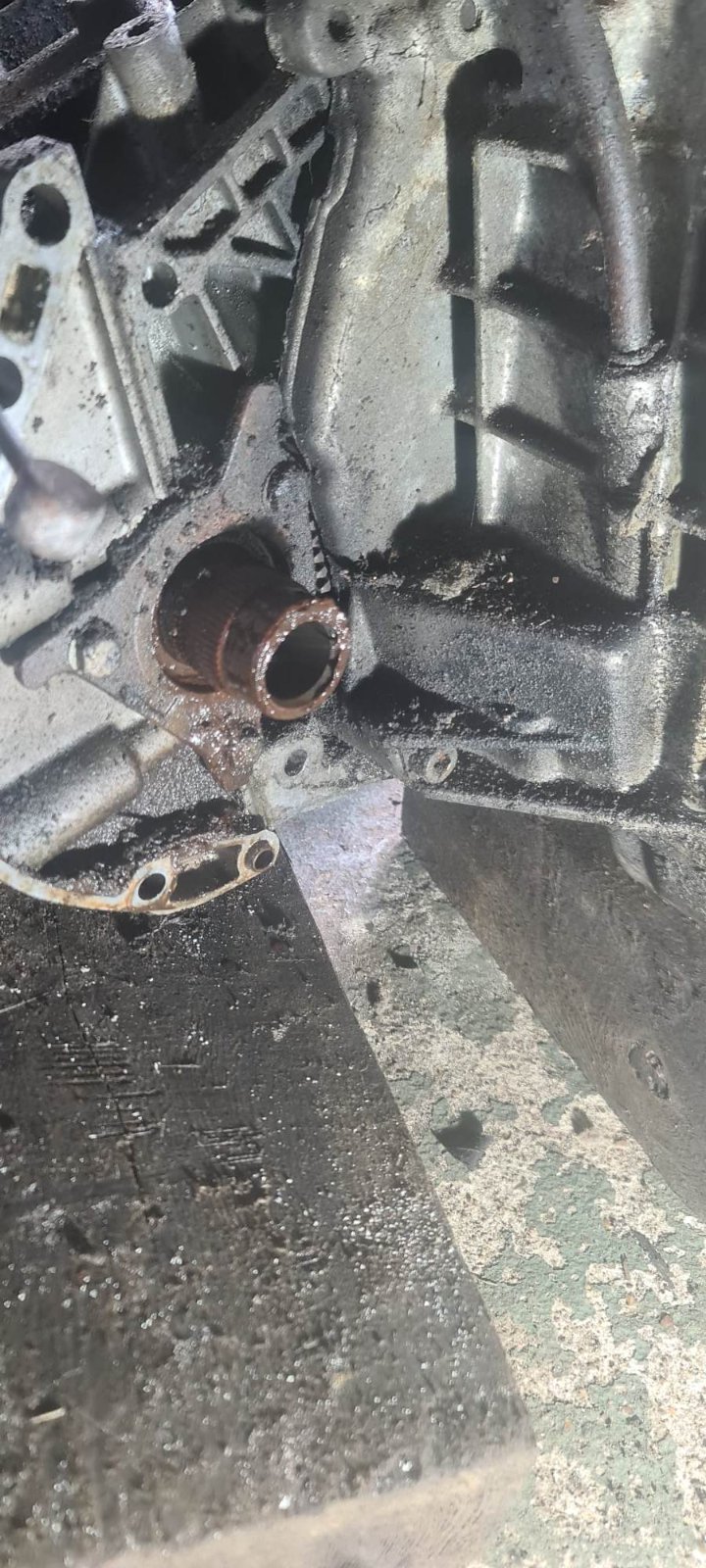

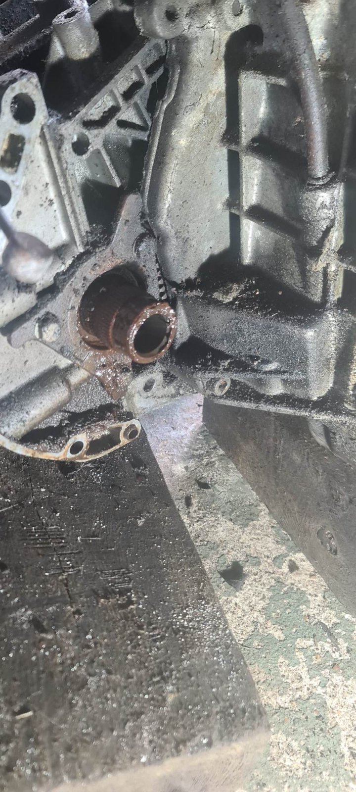

Finally got underneath and it looks like I'm in luck. One or two gently mullered bolts tells me its been done before and from what I could see it looked like that bolt is already removed. But for the time being we just ended up adjusting the clutch pedal, it was very high and not sure why this idea didn't come to us sooner. I've taken a pic and circled what I belive to be where the bolt should be, its easier to see in person.

Re: Tips for a 4x4 clutch change?
I finally got round to it, and turns out I was not in luck. The bolt is in the bottom right, which will not be going back in to this car.
