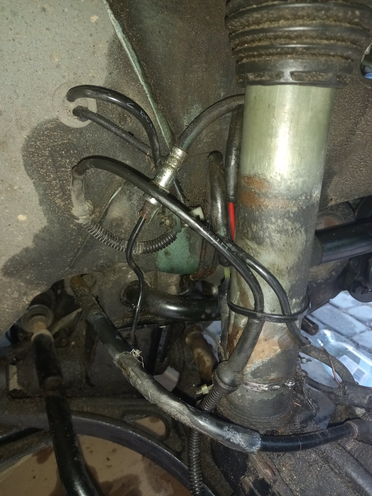

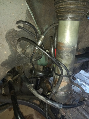

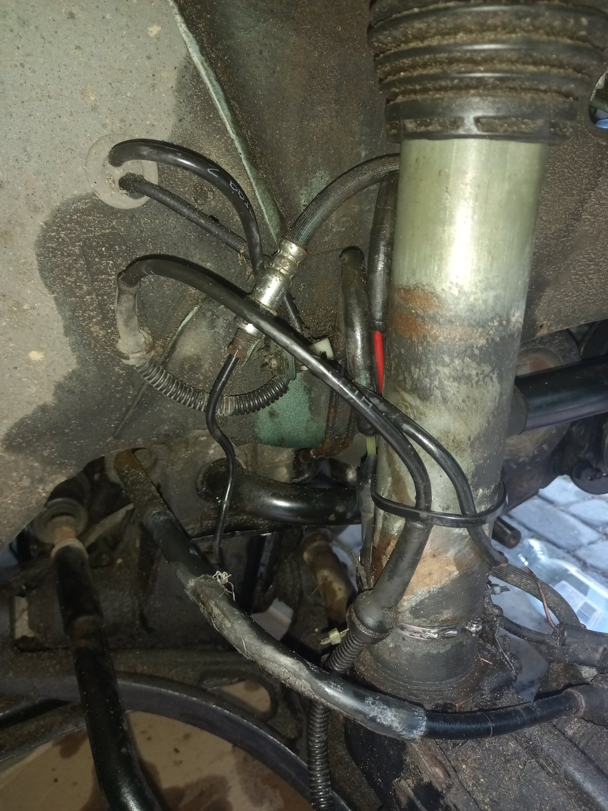

On this topic our BX19 16v developed a prodigous leak from the right hand strut, the car had stood for about 6 weeks and then was driven about 20 miles. Before I drove I checked under the car...no leaks of any description. Next day, put the car on high to further check and soon there was copious LHM on the ground. On removing the wheel it was apparent that, of the two LHM rubber pipes attached to the strut one was disconnected and the pother severed and it was evident that they had been like that for some time. We had not done this so I am very puzzled as to why the car and drove fine without them.
The fix has been to reattach one hose and join the other together with a smaller diameter pipe. Seems to have done the trick, albeit there are tiny leakages from where these rubber lines attach to the hard lines on the chassis. We do have a replacement hose set if needs be although it helpfully came without the clamp that was supposed to be with it. I,ve included a photo as attached. The reason for working on the car in the first place was to replace the bodged hose in the photo (now done).
I suspect that the strut has a failed seal or other issue despite appearing to function as normal.

If you’re getting any significant flow through those rubber hoses then it’s a sure sign of strut seal failure, as you surmise. They’re not meant to have anything but the tiniest dribbles of LHM in them under normal operation.

Suspected as much, thanks
