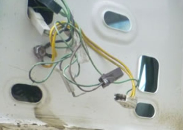

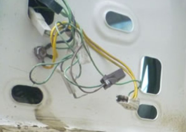

Re: Supply to bootlid
Finally got to the bottom of this and solution was really simple.
As Jaba says the wires run flat along floor to back of car, they run all the way to the drivers side tail light.
On this car the flat loom goes outside the metalwork behind the light and then back in.
Just here as the loom goes back in there is a white multiplug which was the cause of my problem.
Even with this properly connected though without the rear light plugged in on the passenger side there was no earth as there is a small white plug where the main earth for the back end goes into that light and back out to the earth point.
The white plug with yellow wires can be seen on picture Dave posted.
Thanks for your help with this.
