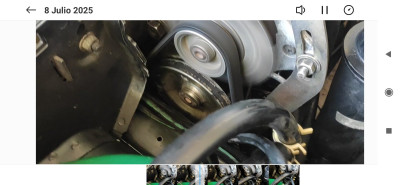

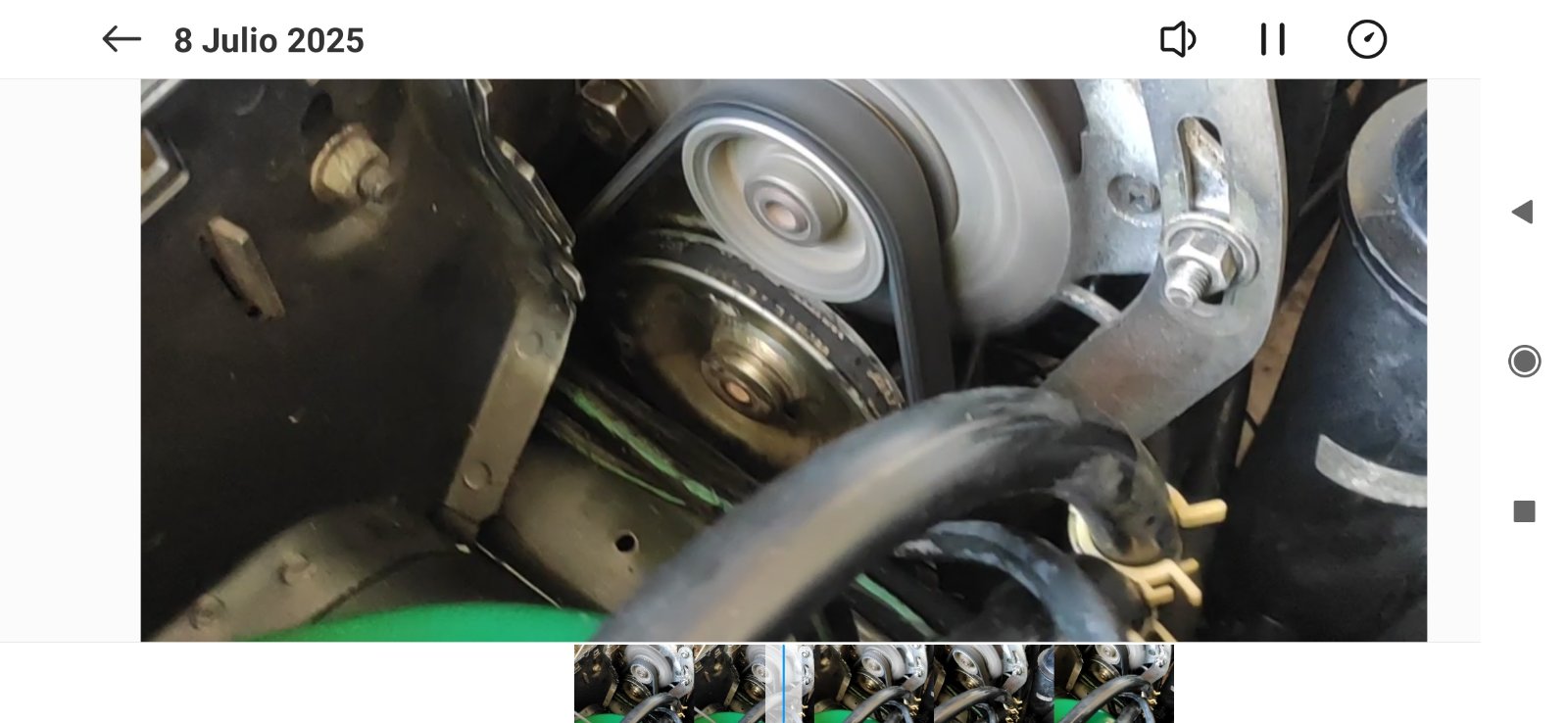

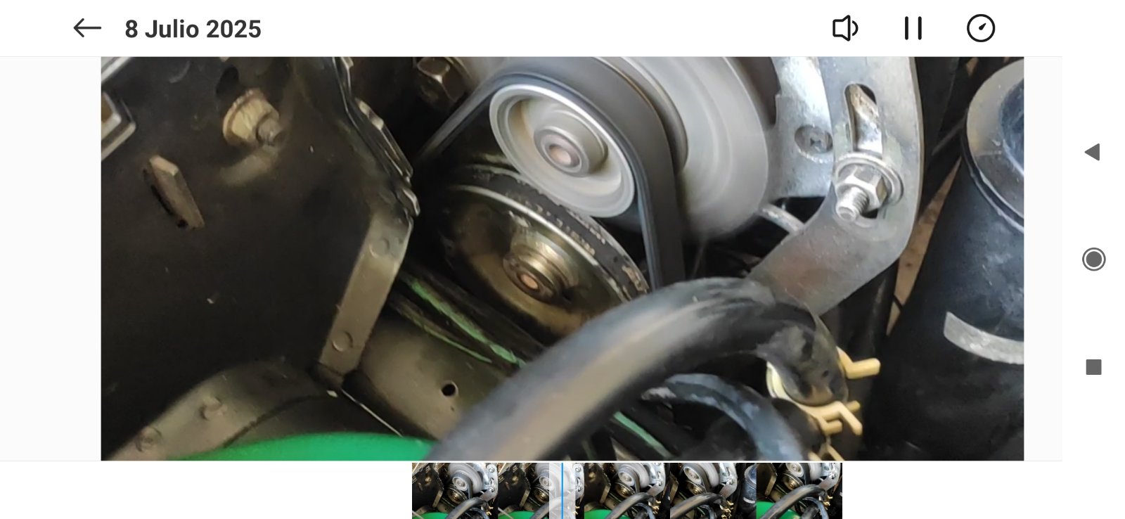

Hello, I have a problem with the system, the pump stops when it reaches pressure.
I changed the pump and the circuit breaker assembly. When it reaches pressure, it doesn't spin and the belt makes a rubbing noise. I checked the pressure tube that runs from the pump to the circuit breaker. I don't know what else it could be. Could it be the safety valve? The central ball? Thanks.
