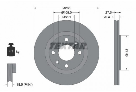

The front disks you'll find on several PSA models, ZX, Berlingo, Xantia, 206, 306, 405 etc.
Ø 266mm, 20,4mm thick rotor, 27,5mm height. Be careful not to get the ones with a 34mm height, they will not fit!
Rear discs are BX specific Ø 224mm 7mm thick, Xantia's have 9mm thick ones.
