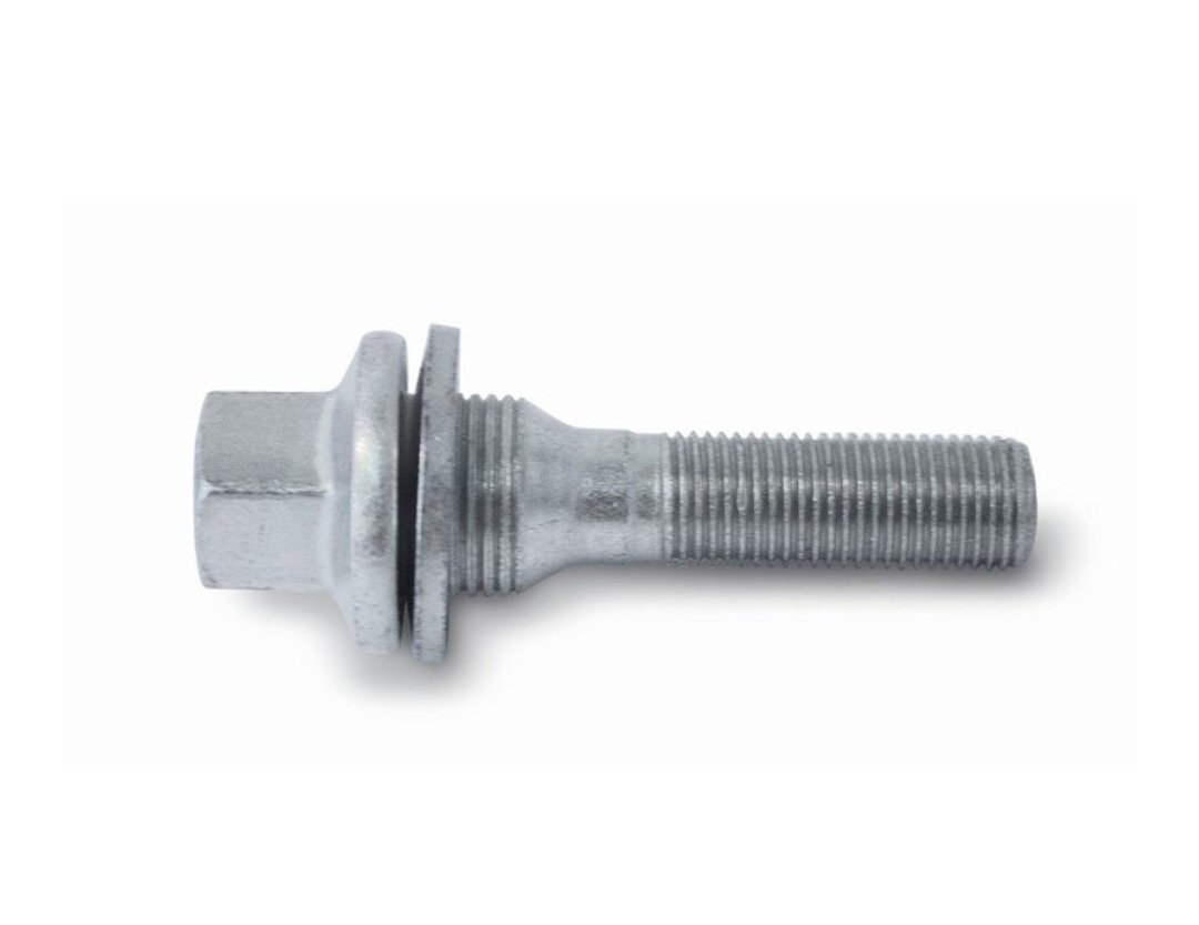

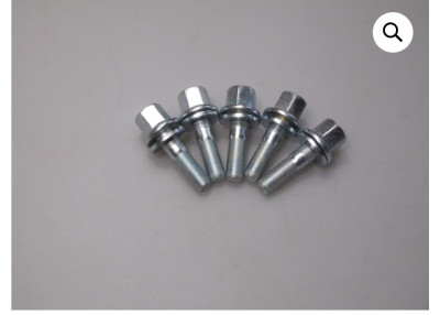

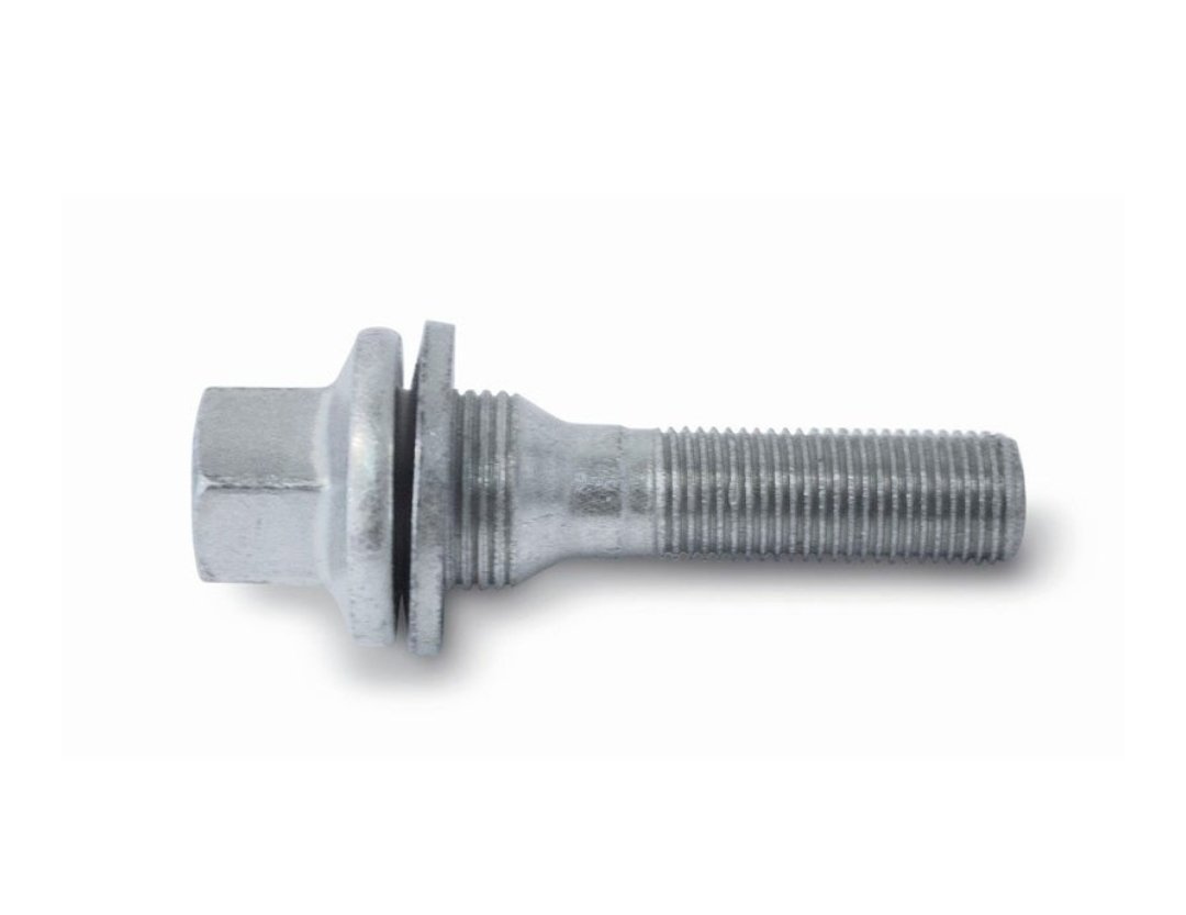

Hello, ive found some potential bolts that will fit.
Thread is 49mm long and is M12x1.25
Only concern is that thicker upper part of the thread, maybe its too wide?
Thanks in advance!
Posts: 2032
x 116
Re: General problems with my Millesime
Its not the correct bolt. Its a lot longer and that top thread may not fit through the wheel and the taper should not be there. It may of course do the job - you could just buy one and try it. Better and safer to have the correct bolt though.

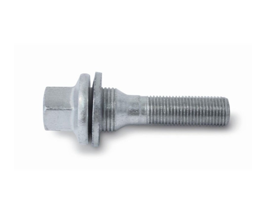

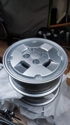

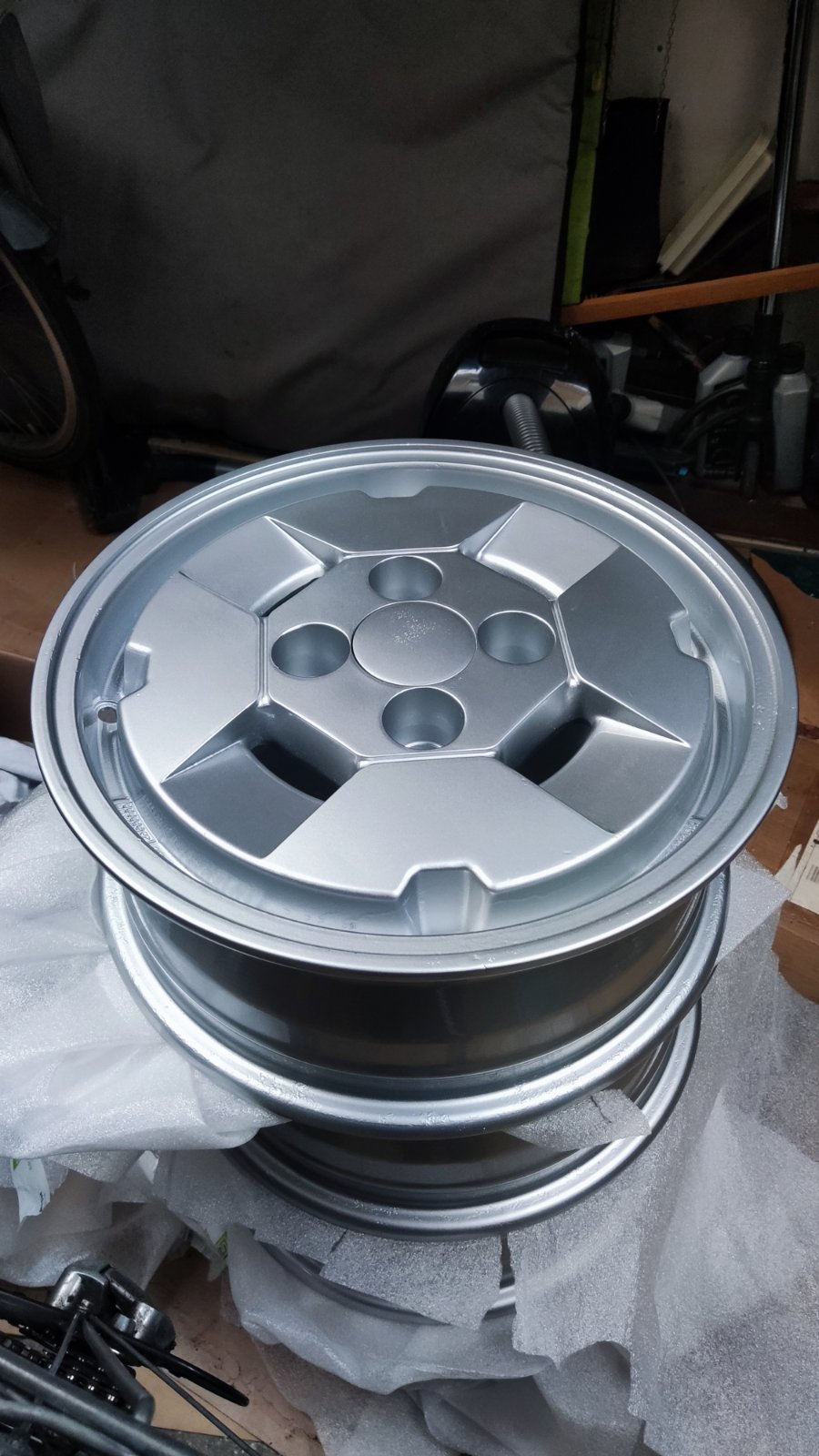

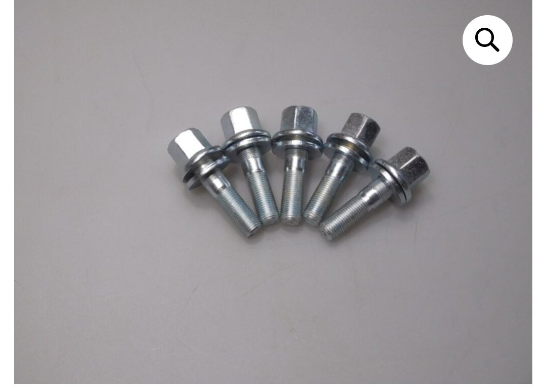

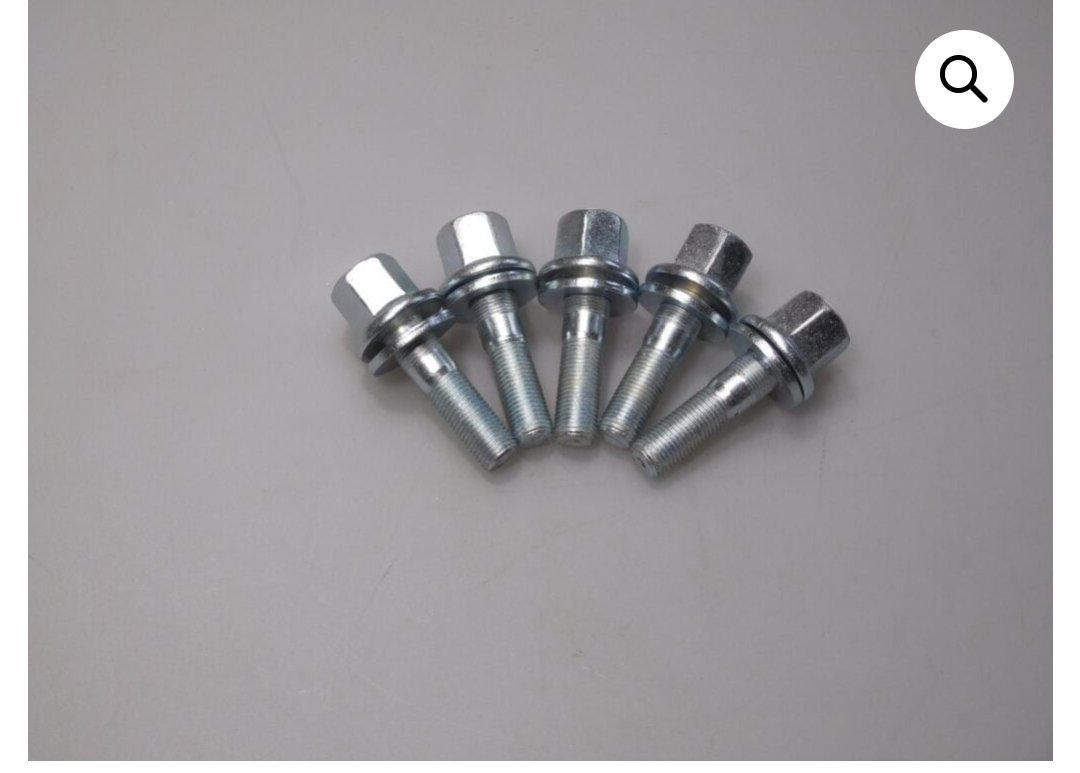

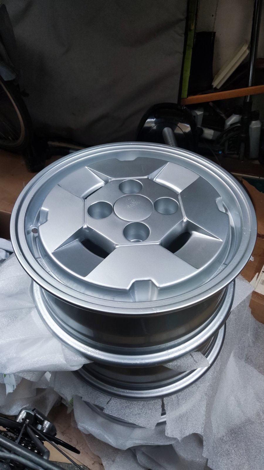

Ive found another option, and i got my wheels back from the painter today!
The bolts on that picture are for a CX turbo, maybe that will work?
Cost around 9€ a piece.
Posts: 2032
x 116
Jaba wrote: Thu Feb 05, 2026 10:01 pm They look like this: https://www.chevronics.co.uk/product/xm ... lt-thread/
CX bolts fit as well. Good luck finding them........
The wheels look great

panky
Posts: 688
Location: Widnes
'88 BX GTi (a long time ago)
x 174
Post by panky »
They do look rather splendid 8)

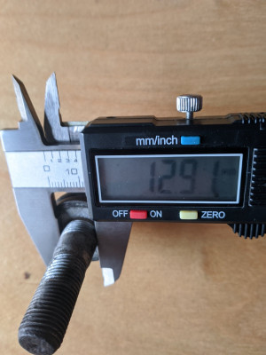

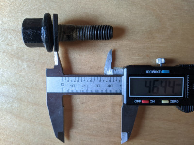

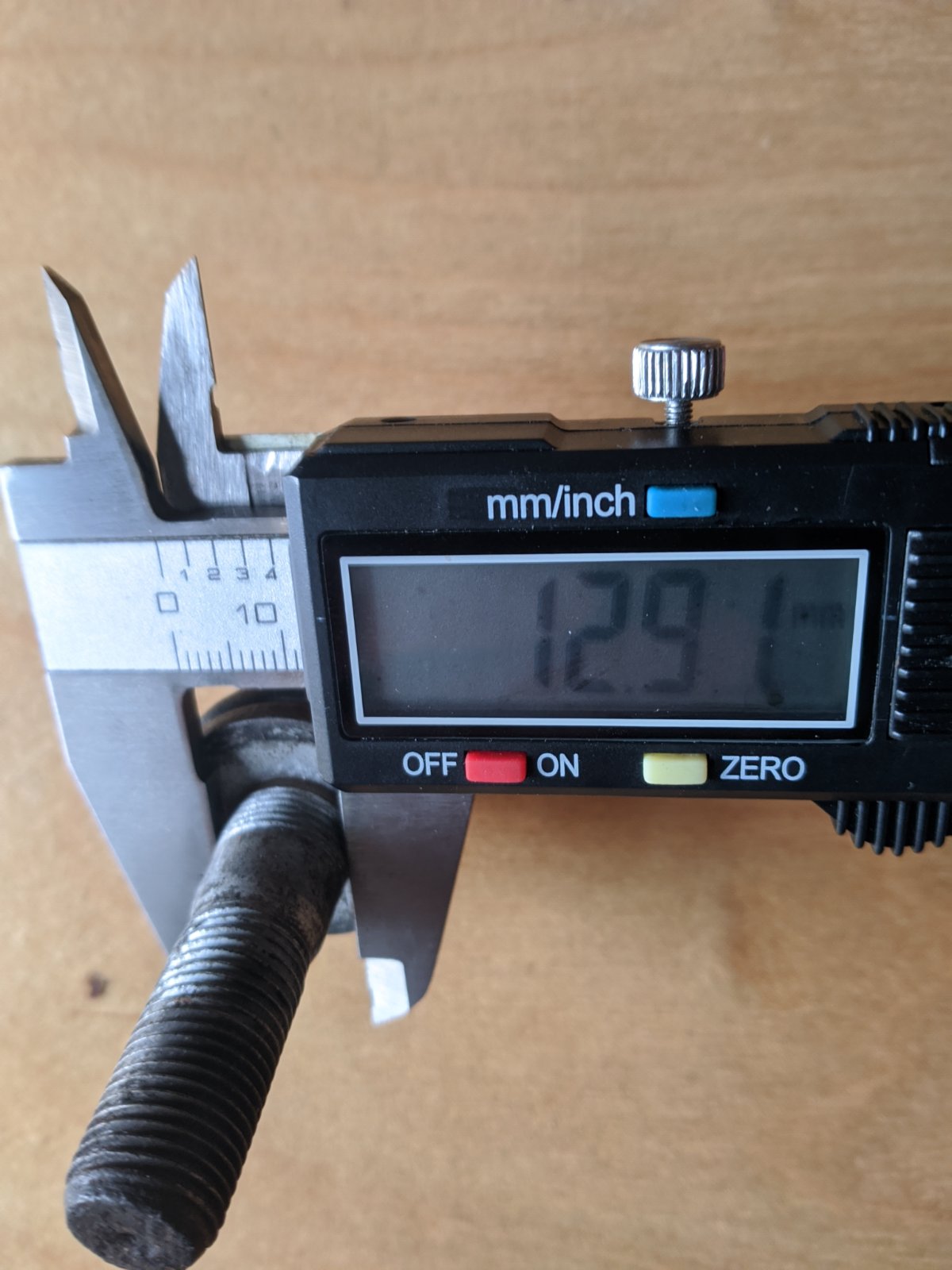

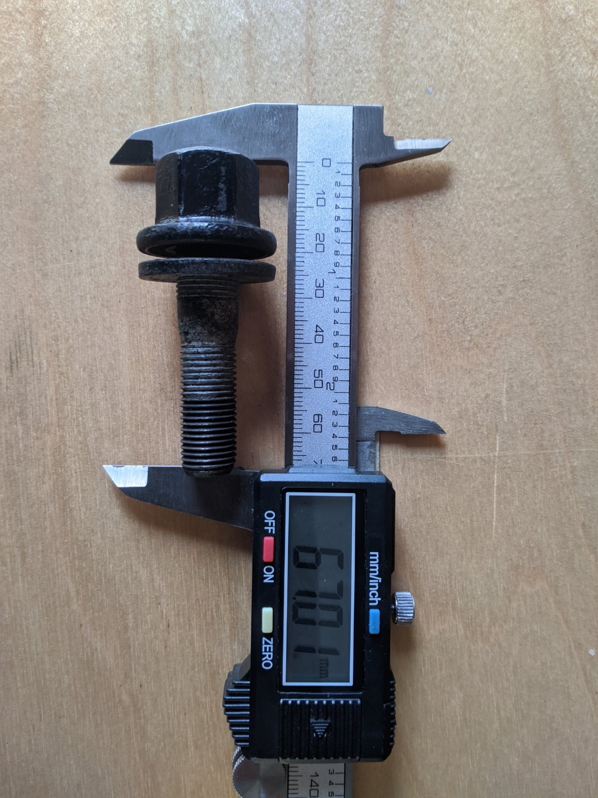

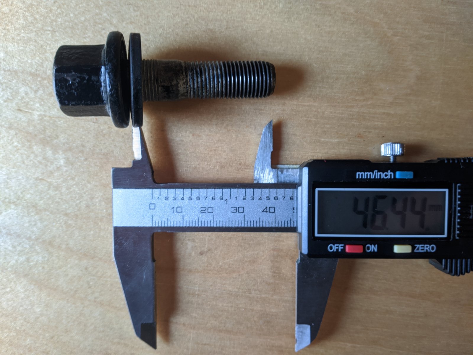

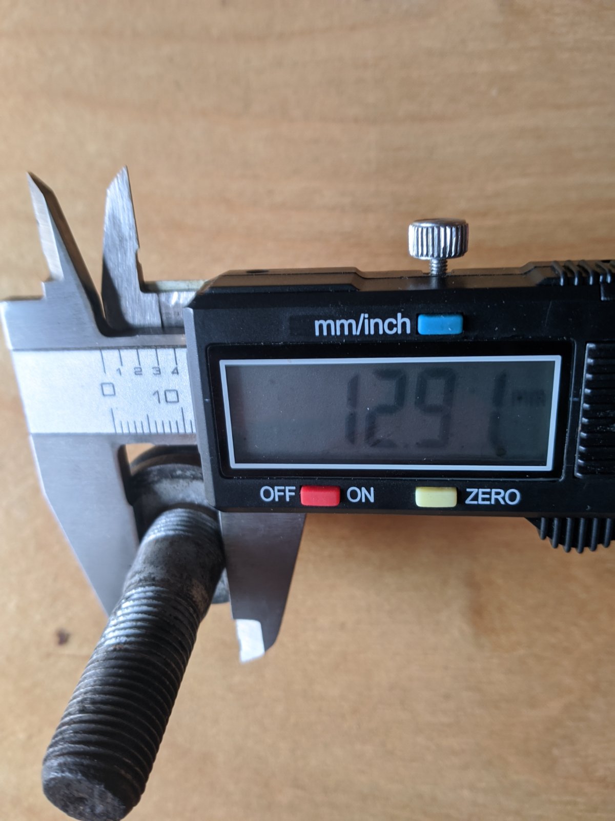

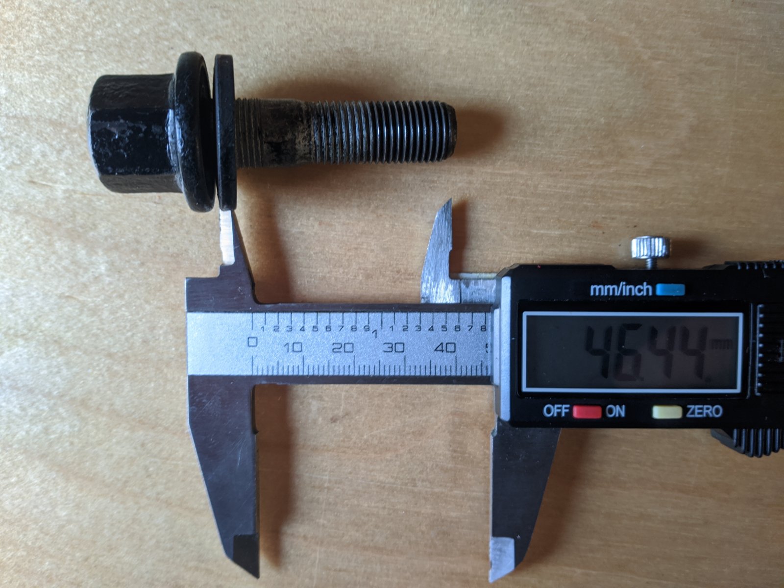

Post by Dave_16v »

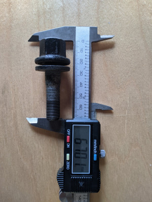

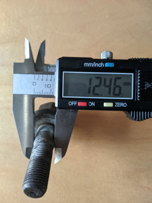

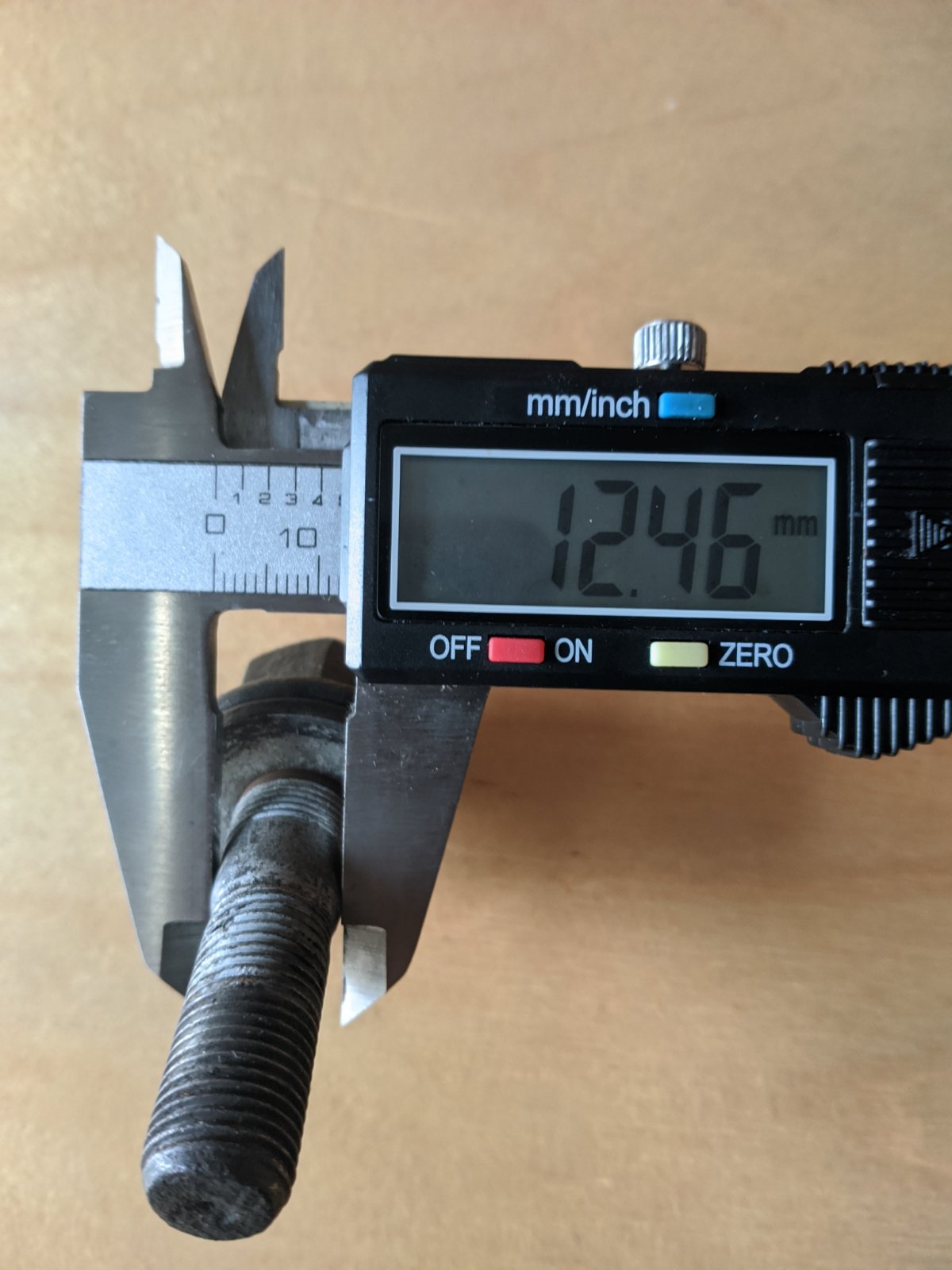

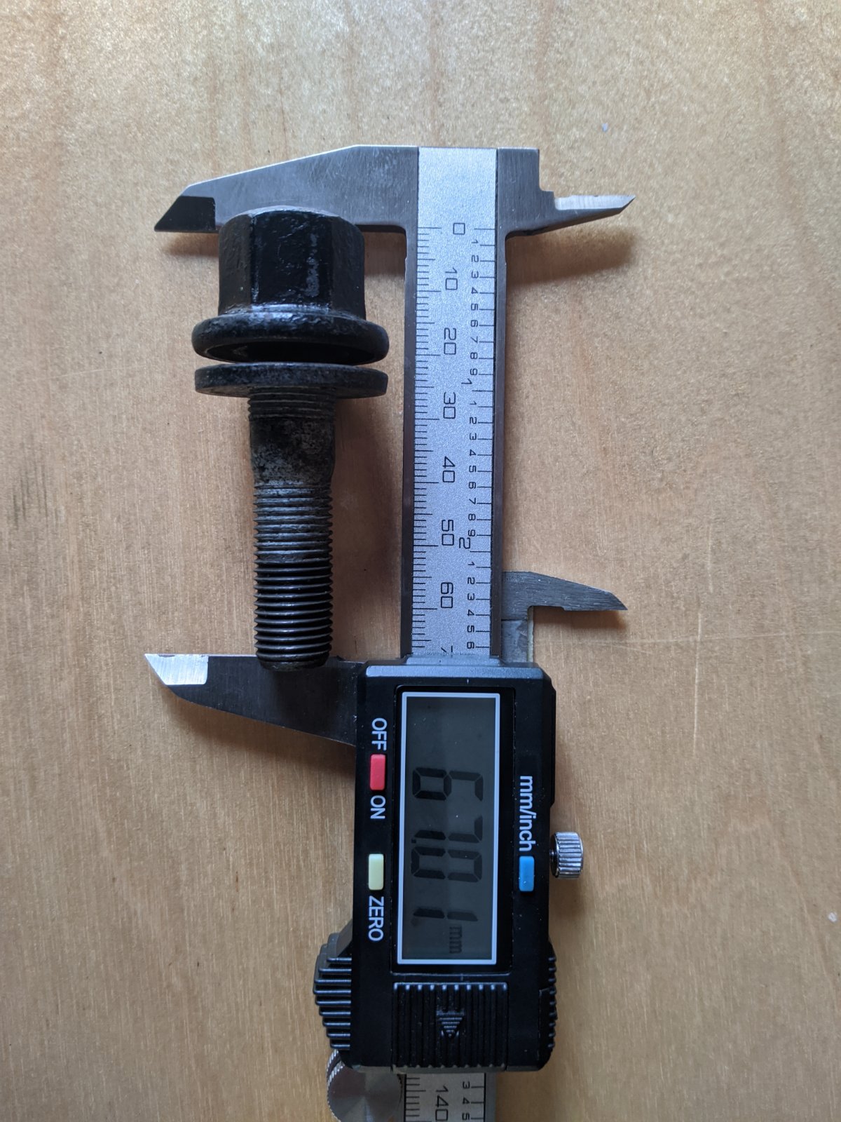

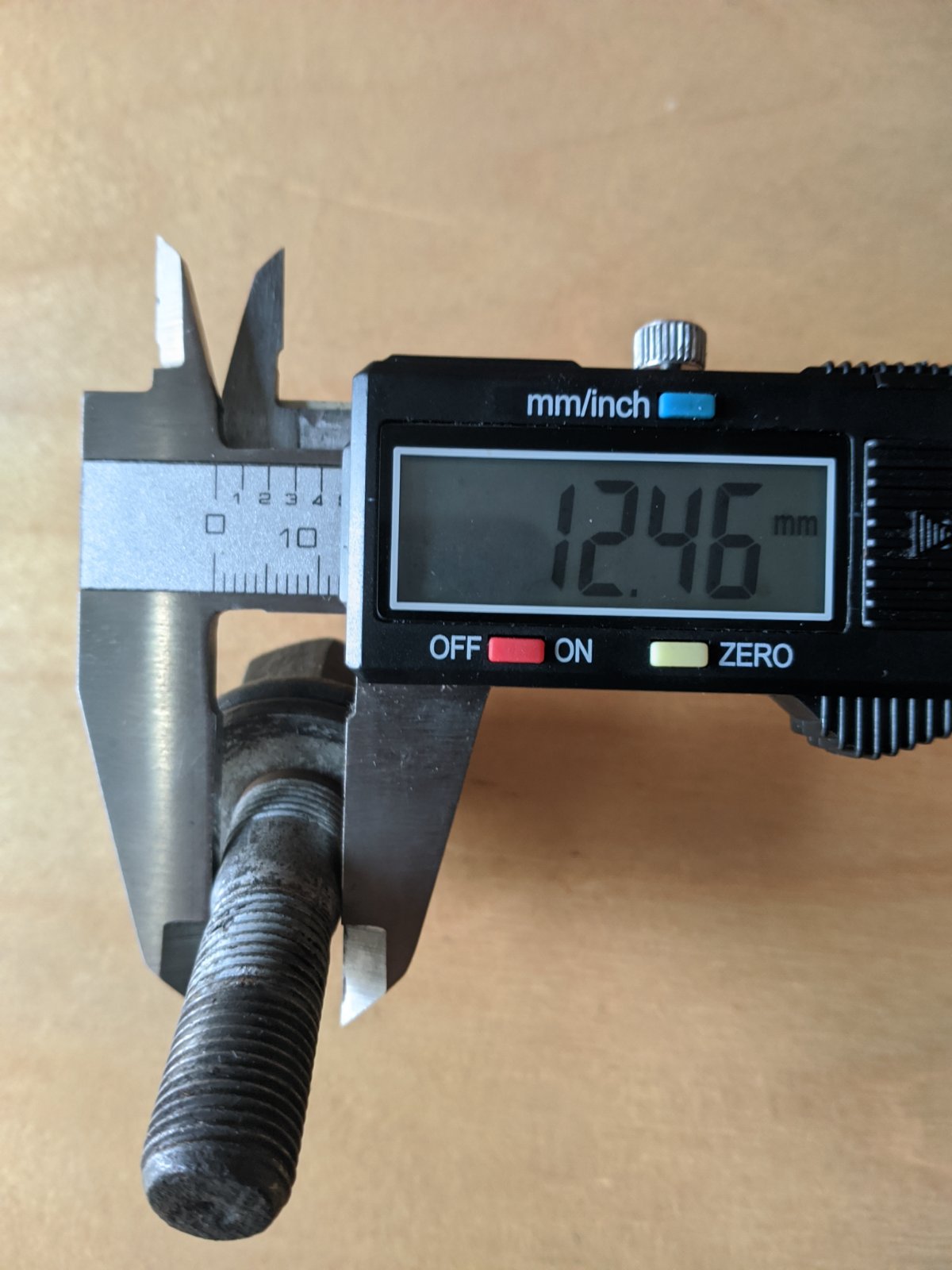

MillesimeEnjoyer wrote: Mon Feb 09, 2026 11:43 am Hello, ive found some potential bolts that will fit.
Thanks in advance!
Maybe these will help.
