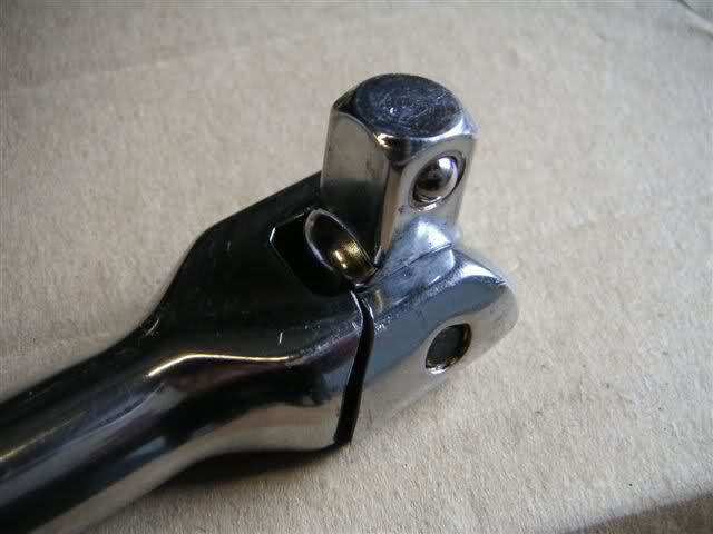

I tried the 36mm after finding it hard to get a 35mm. Ill try looking for an imperial size one. The 36mm resulted in the following:
oops, becoming an expensive job in just tools, not parts!

I regularly twist the ends off breaker bars, then a mate bought me a Halfrauds one, it still breaks but now I take it back and get a replacement one free :D

Halfords ones seem ok value, about £12 for one, but they dont seem very long... like you say at least i can keep returning it!
