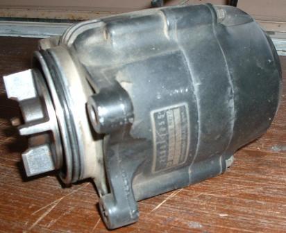

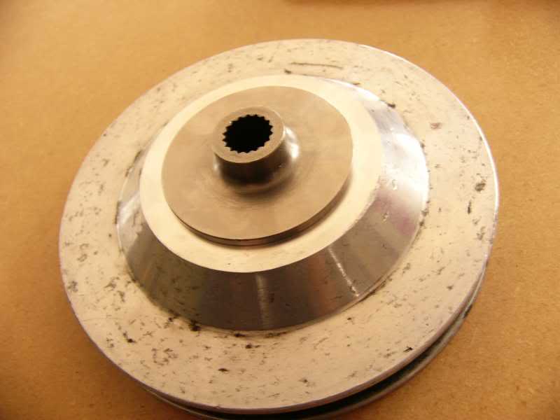

The first bit was the alternator, this has been driving me crazy for a while now, the alternator I have got is a Kawasaki ZZR1100. It is small, will make 35amps, but the connection to the engine on the kwaka is by a rubber muff coupling just like this –

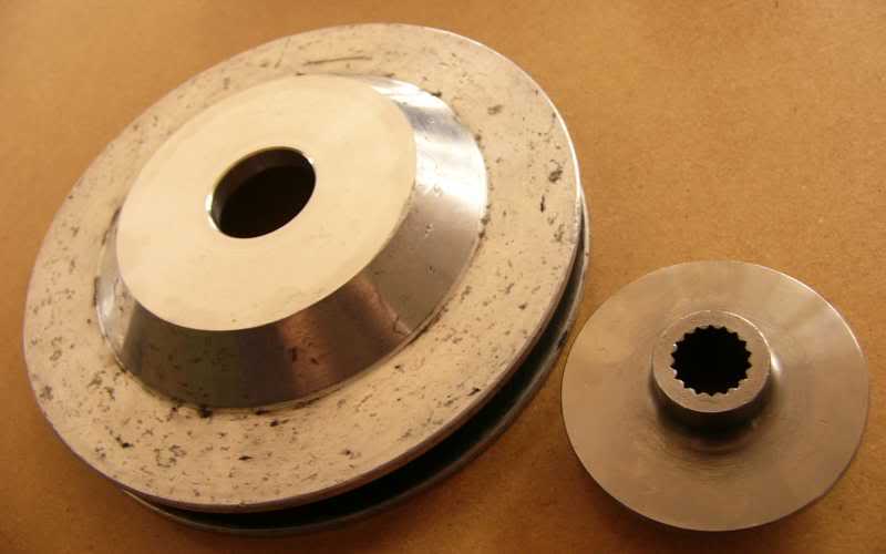

I found the pulley from my old water pump, this is aluminium and the key way was a bit mullered, so perfect for conversion to the alternator. The piece on the alternator with the paddles on it is splined on to the shaft (why are bikes so much better made than cars?), I decided to machine the paddles off and make the pulley a slip fit on, then bolt the two halves together. David Cooper very kindly did this for me as I have a distinct lack of machining facilities.

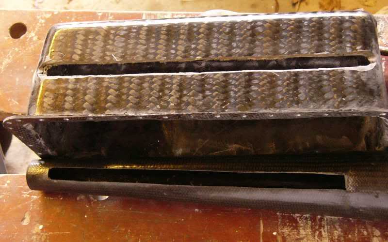

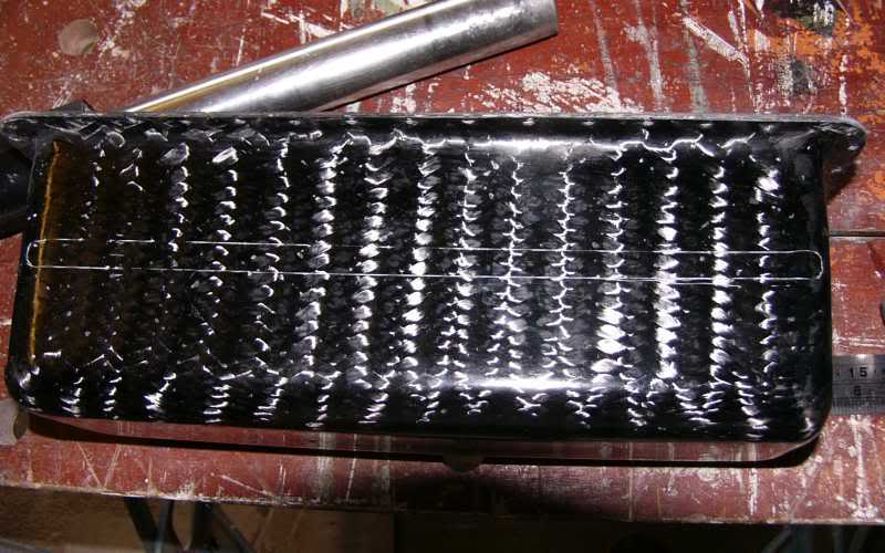

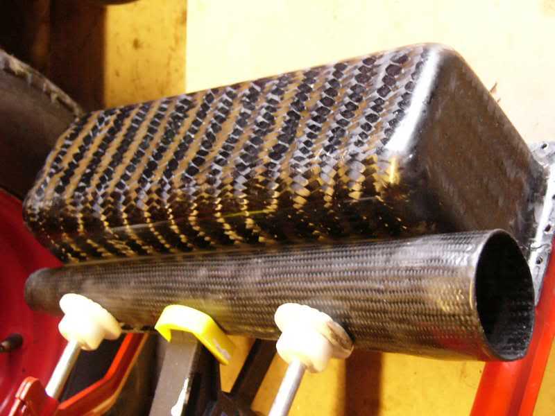

I have trimmed up the plenum and started to polish it, but before I got too far I decided to fit the taper tube onto it, first I marked out the slit that will join the two volumes –
I cut both parts with a diamond wheel in my dremely thing (a very good filter mask was worn, carbon dust isn’t very nice) –

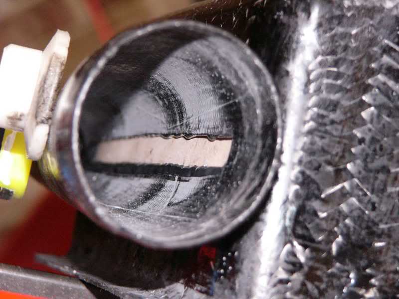

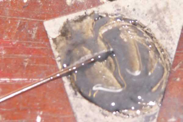

I scuffed up the two parts so that the carbon fabric was showing, this will give a good join, then I mixed some epoxy glue and put some of the carbon dust into it, partly to make it black and partly to strengthen the matrix –
Then the two parts were clamped together, a solid chunk of moulding block was put behind to ensure a straight join. It was all left over night inside in the warm to complete the join –
The block can be seen here behind the slit –

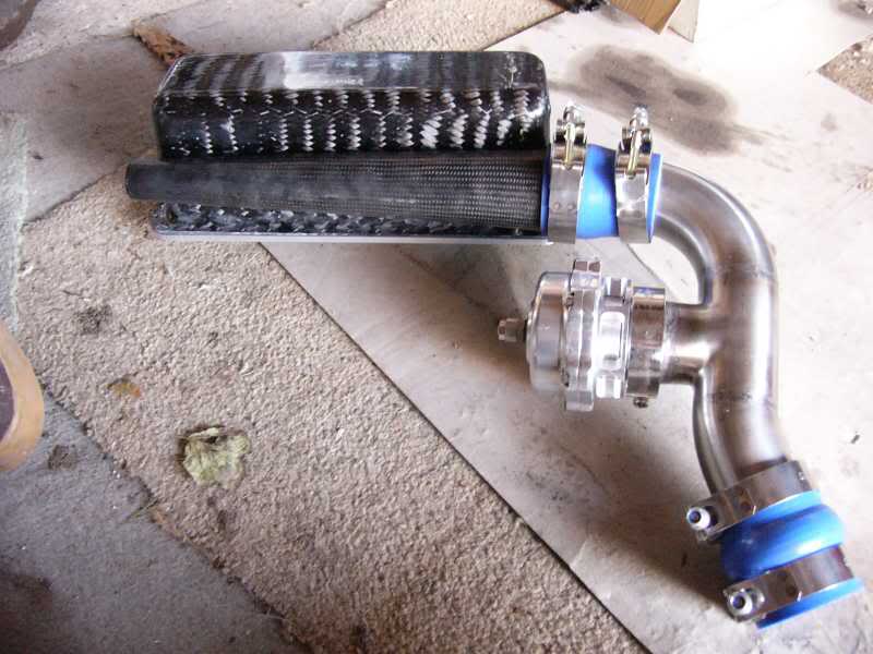

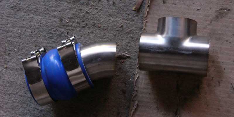

The next day once the glue had gone off, I could align the plenum and make up the final boost pipe, this was not only the most complicated one but also the most on show of all the pipes. It consists of a bend to straighten the outlet from the intercooler, into a T-piece for the bypass valve, then another 90 degree bend to go into the plenum chamber.
I started by putting the two bends onto the intercooler and plenum, I could then see how much needed to be cut from each to line up with the T-piece. I trimmed the 90 back as far as I could without ‘cheating the bend one end, and took about 25mm off the other end. The other bend was taken back to provide about 20 degrees to the T-piece, and the T-piece was taken back as far as possible.
I tacked them together and checked for fit –

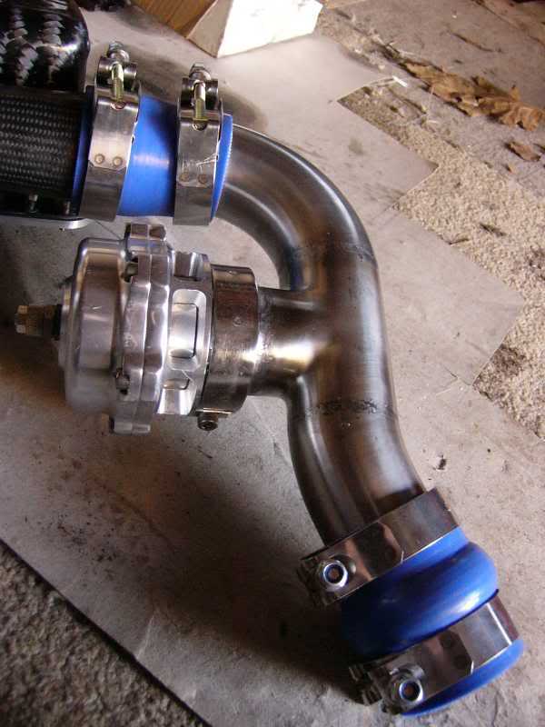

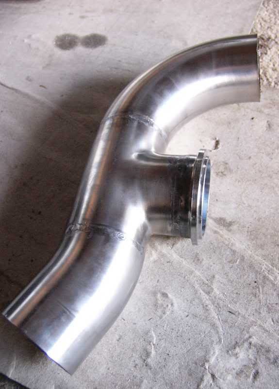

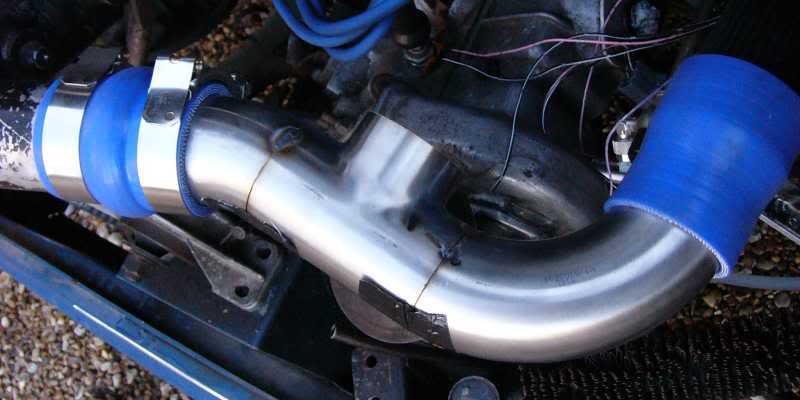

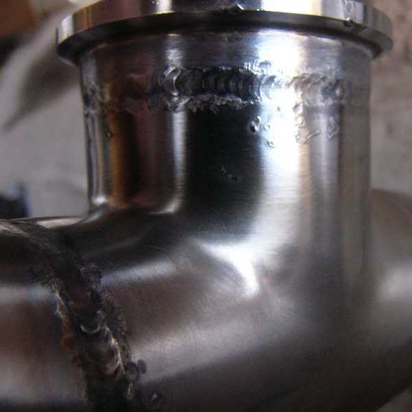

All looked fine so then it was time to TIGarinio, when Mr Cooper was last round he borrowed my TIGinadraw, I watched his technique very carefully and gleaned some knowledge. So this time I ground the tip back to a much finer point, where the join in the stainless was I ground it back so it was virgin metal, and as my machine is scratch start I started the arc on my aluminium vice jaws. All of this combined to create a beautiful weld, it was so nice to do, easy, a real pleasure!!
I also took some advice from Keefy here on Retro-rides.com, and back purged the tube to stop the crusty black stuff I get from weld penetration. I couldent keep a constant flow, but I taped up each end and filled it with gas, sealing it up before final welding.
The flange for the bypass valve was also welded on, it was chromed so I ground that back as it would have impeded the weld.
This is the outcome –

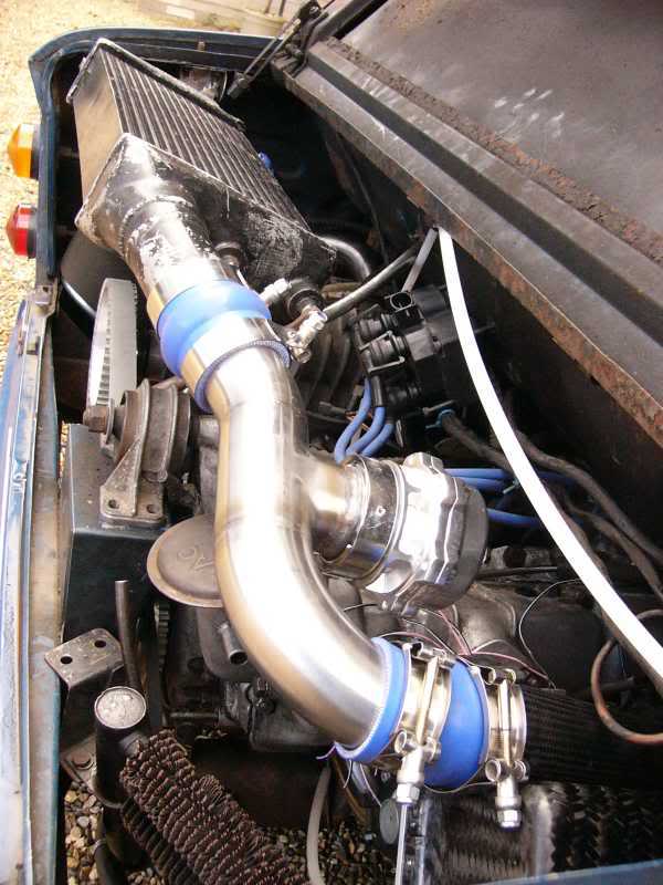

This is it on the car –

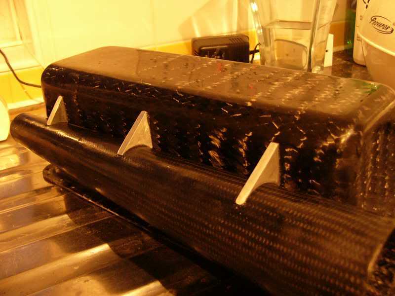

Finally today I decided to make up the supports for the taper tube on the plenum, these were to be made from 5mm aluminium and bonded onto the carbon parts. These should significantly stiffen the whole assembly, making it much more durable. I made up templates for each part, and then filed them each individually for a perfect fit. I mixed the epoxy with carbon again to strengthen the matrix and ground the plenum and tube back to carbon for a good join between the parts.
Here it is curing inside overnight, fortunately it doesn’t smell to much, otherwise my mum would go ballistic!!
