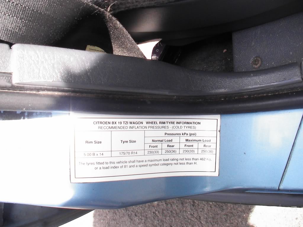

TZi tyres specs
Post by pindimar »
Hope this is readable from the photo, but this is the tyre specifications stuck to the door pillar of my BX TZi wagon
Would the speedo be calibrated to take account of this, I wonder?
Greg F
jeremy
Posts: 2112
Location: Hampshire UK
Post by jeremy »
Some well known British car manufacturers used to enhance their products performance by deliberately using incorrectly calibrated speedometers. The UK requirement is that the thing is within 10% (either way), some European countries stipulate that it mustn't (overread?) - if you search on the internet you will see that there were a number of committees on this subject alone when the last group of countries joined the EEC. (The process is called 'harmonisation.')
Odometers are generally more accurate -I think 3% is usual. They simply count cable revolutions on a BX.
jeremy
Posts: 2112
Post by jeremy »
That tyre pressure sticker is interesting - as a different one is used in UK. Ours is on the drivers side door pillar and has red car symbols - and I think mentions the tyre size. This was to my knowledge used through 89 to 94.
