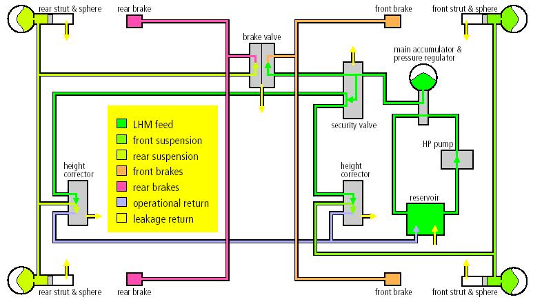

Does anyone know of a decent Hydraulic Diagram be it online or in a book, the haynes isn't that good.
I'm paticularly interested in return pipes
Hydraulic Diagram

Scroll down the bottom of here and all will be revealed.
http://www.tramontana.co.hu/citroen/sus ... ension.php

Also worth following the links on that site to the technical guide.
May be some diagrams in the workshop manual - which can be downloaded from Bob Smith's site.
http://www.rwbsmith.plus.com/citroen2/

From the Japanese site:
http://www.mars.dti.ne.jp/~ynar/bxorg_a ... /m15e.html
Also from the Xantia site:
http://xantiaclub.net/techguide/#chapter2_2
