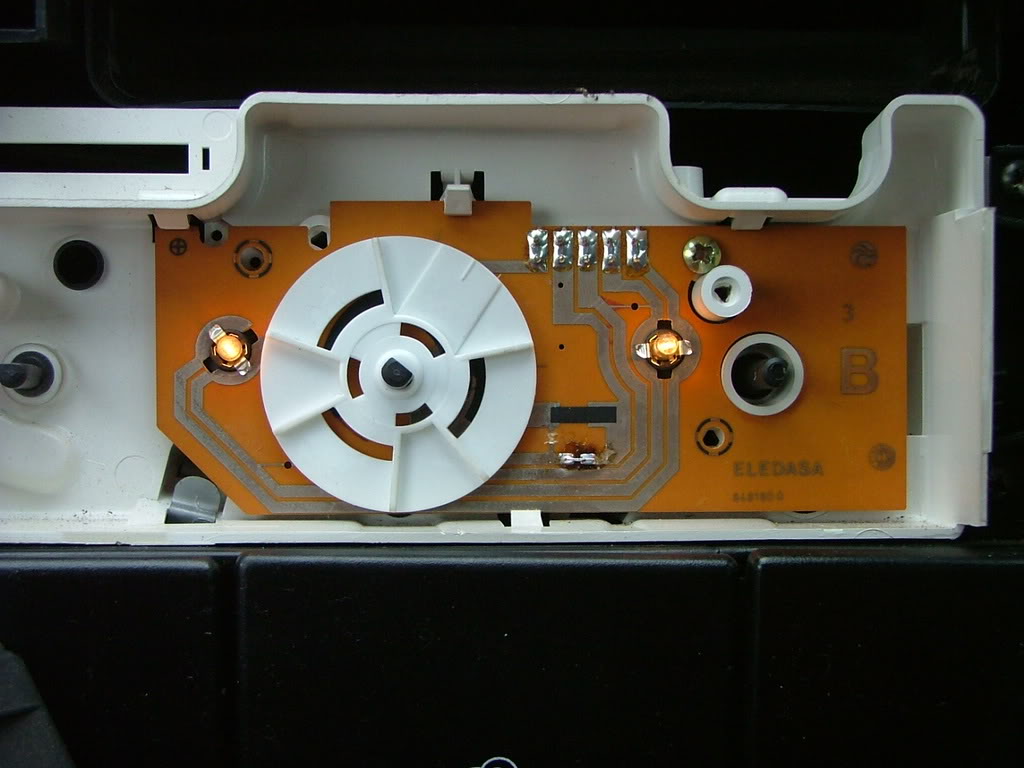

The heater control modification. Enables the fan to run at full speed using the relay already fitted above the steering column.
Whilst you have it apart, clean the track behind the control with a cotton bud moistened with alcohol and the contact strip on the knob itself. Also worth checking/ changing the bulbs.

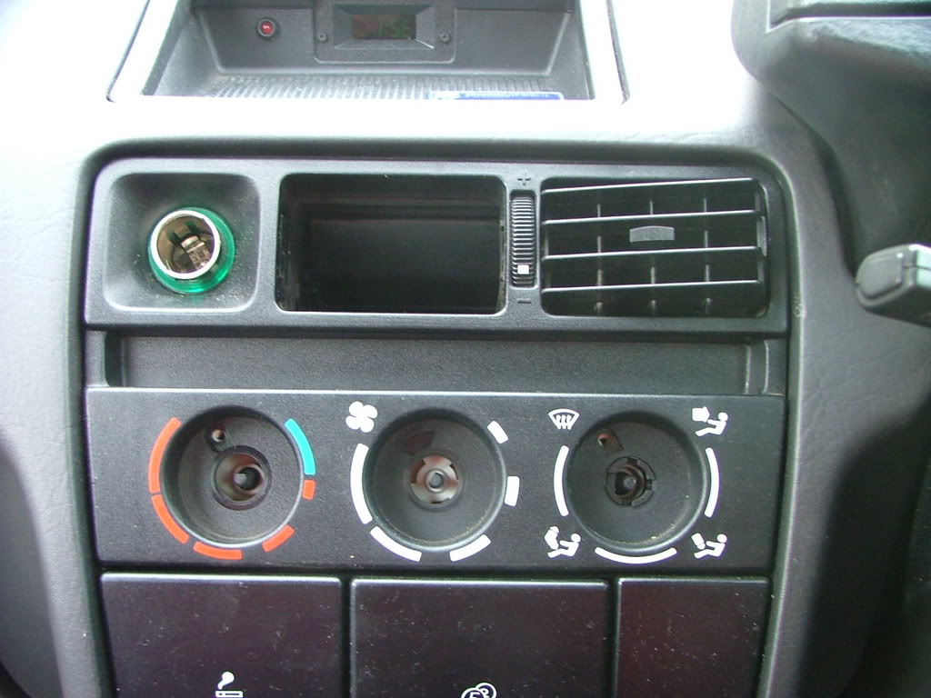

1) Pull off control knobs, and undo two philips/torx screws behind temparature and feet/face/screen knob. Turn air control knob on centre console vents to off (prevents springs from disappearing into the air duct) GENTLY remove vents, catch little springs.

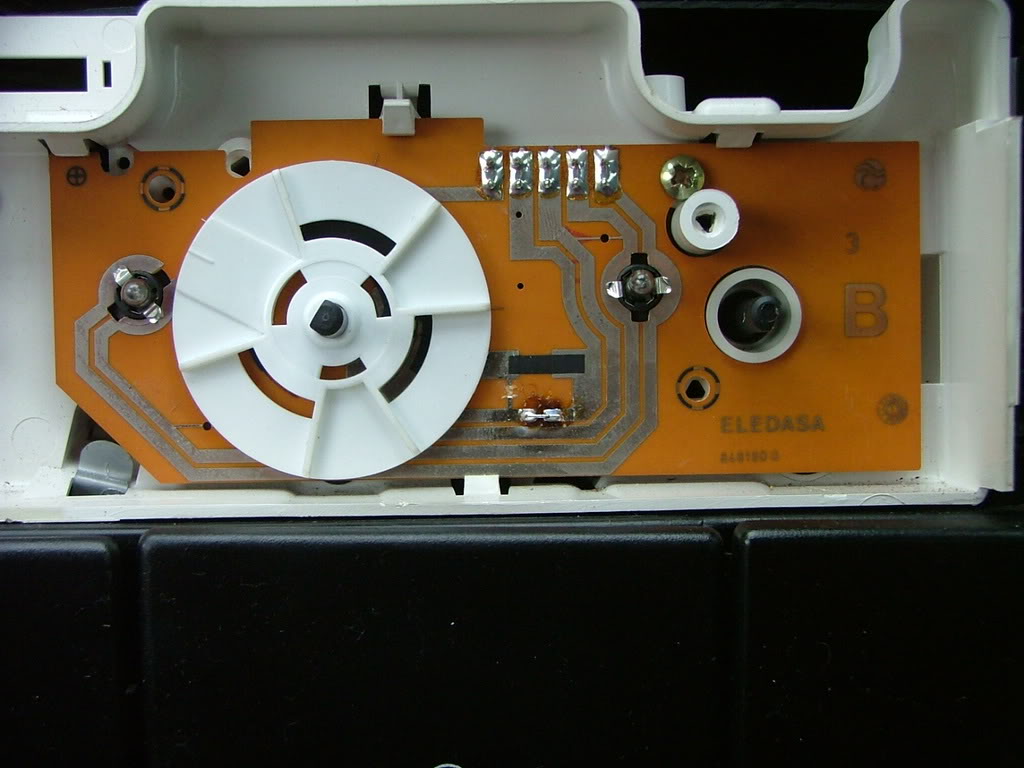

3) Cut the track carefully using a pocket knife or similar (ask an adult to help at this stage!) and solder some wire across the other track.
Your circuit should now look like this:
Switch the ignition on , wind the wind control to max, you should hear the relay behind the steering column click, and the fan speed pick up. Check the bulbs , and reassemble!

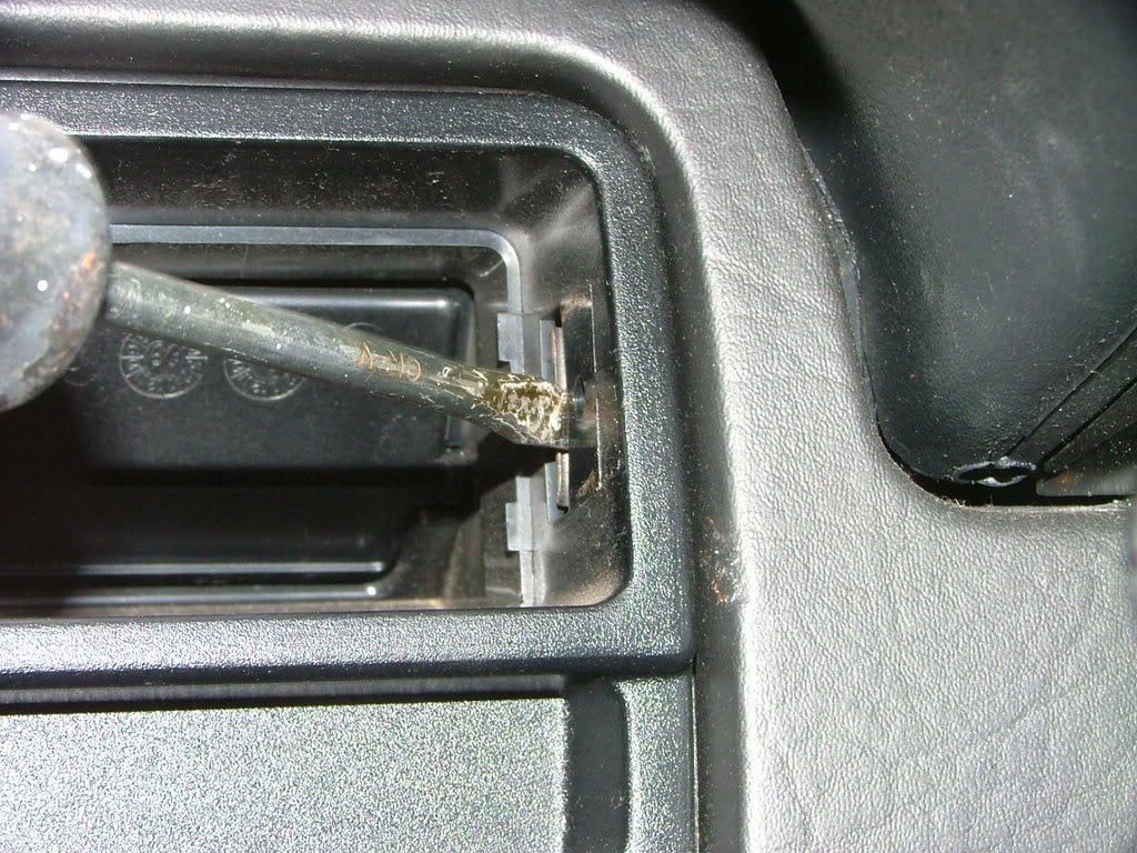

2)Locate metal retaining tags just behind the vent holes to left and right, and hook a flat screwdriver behind the tag and prise it outwards to release the front panel.

The speed control on BX heater fans is achieved by the use of transistors which do a very good job but always have a residual resistance. The system is designed to remove this residual resistance by simply bypassing the transistors to enable full power to be delivered to the motor - and they did it rather nicely using a relay rather than a big switch on the dashboard. The only shame is that someone got the circuitboard wrong!
As for motor life - its designed to work in this way. Its not compulsory to run the thing flat out all the time - and you would probably get too hot anyway! Full speed is only achieved when the knob is rotated fully clockwise, the variable slower speeds remain undisturbed.
