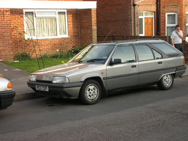

Firstly, I've got a "Silver Machine" - though really it's metallic mid-grey, the "electric lines to Zodiac signs" have been removed (thank God), it doesn't yet "Fly sideways through time" , it has very little chance of being "antiseptically clean" . However, have just taken several rides and am still feeling, well.... (you gotta know what I) mean.

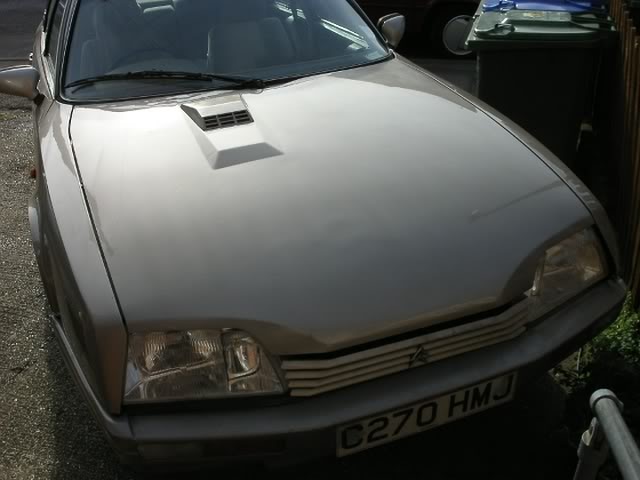

Tom, however, has got himself another beautiful CX - remarkably free of coachwork cancer, which is a considerable coup. On the musical theme, any references to Spandau Ballet will be punished by keelhauling, me hearties.

Dave, do you know what the Citroen colour is officially called for the estate of your`s? I have a TZD estate in exactly the same colour and need to get a couple of touch up aerosols for it.

That looks like a Platinum estate.....thats gotta be a rare combination!

Cavad: I've not yet checked the paint code, which will be on the r/h inner wing as you look at the car with the bonnet open. I'll then check it aginst the excellent colours section on the BX DIY site. Apparently Halfords (for once) do a good job of mixing the right paint up - so long as you can specify the original Citroen colour.
Kitch - are you suggesting that Platinum (if that be the one) is a colour found more commonly on a 16v or suchlike? Jane is hoping that Tom's new CX doesn't take up a permanent residency on the drive - autobox needs fixing/adjusting - but Tom has plans (as usual). It's been very enjoyable just looking at it so far....

Well its hard to be certain, but it certainly looks like Platinum which is "Gris Dolmen", or colour code ETB. If so, its a rare colour on a hatch and I've never seen an estate coated in it before.
BX Bandit has a 16v in that shade, and Capri's TZD hatch is that colour, but thats all I know unless Billy has one now aswell?

Thanks Dave, I`ll have a looky round and see if I can find the paint code. Halfords so indeed do a good job of colour matching and if they get it wrong they`ll do you another one, or least they used to.

My new Camembert Mechanique is indeed finished in ETB - dolmen grey (the dolmen bit goes nicely with the "Silver Machine" moniker), and it is a very fine colour indeed.
Strangely enough, Kitch, if you go to the rather good colour section here http://www.passion-citroen.com/nos_citr ... &coul=gris and look at the example for "Gris Dolmen" it's a BX hatch that seems to be a TGD or TGD-based special edition by the look of the wheel-trims. Plenty to browse through there, including the gloriously-named "Beige Sloughi" I came across in a paint-code book the other day.
Cavmad - for that code, open the bonnet and check the inner wing to the engine side of the blue glow plug relay area (or ABS unit if it's so equipped). Unless there's been welding/repainting in the area, the code is written there in large black letters.

I've suggested to Tom that he checks the level of the ATF in that CX of his before he starts ripping the box out.
If the level gets low, it will do exactly what his does and as it was supposedly just done up prior to his purchase which might lull him into a false sense of security that the level has to be correct, but there may be a story on how the level got down. (ie) repaced a CV boot and didn't top up correctly afterwards is a common one as is checking the fluid with the engine stopped.
IIRC, that box is also back from the era where they had bands which were adjustable but I think he's already aware of that. Looks a nice car....both that is. :wink:

Tom's done the bands before, has a shiny new tool-toy to do the adjustment, and when I went over to drool in the general direction of the CX there were some new bottles of ATF in its general vicinity. However, the gearbox bolts weren't playing by the Queensbury rules that day (it is a CX after all) so the adjustment is in abeyance until next weekend.
It's a dangerous business, just standing next to a decent CX - gives you unnatural urges... However, the chances of finding a sound one in the UK nowadays are miniscule, though Tom's seems so far to be the exception to the rule.

Firstly thanks to the Doc for the setting up instructions. Work stopped on good Friday as I was off to France for a week and I am now back in London as prisoner of work. I'll be back to the CX this weekend and see if the 'box can be adjusted. BCXM, hang onto that 'box, I might be needing it! The structural audit found no horror stories, a couple of small patches being required, one about the size of a penny in the middle of one sill when provoked and another being a small crack around a jacking point.
The big blue relay needs rewiring and the ignition switch wants a looking at before it will start reliably and there are lots of minor issues but I'll get on with those as and when .
