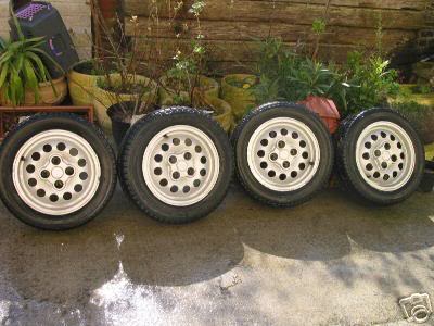

With a bit of luck Monica will soon be driving around the North-West with something like this.......
Unless any BX Anthracites turn up :wink:
Thanks for the info on the nuts too...much appreciated!
Dave
A nice set. The anthracite ones are very good too, but once these are on, unless you are an authenticity nut, I doubt you'll want to change.

What are they from, mountainman? They look like Pug 205/309 GTi wheels, but I don't think they are.
mountainmanUK
Post by mountainmanUK »
stuart_hedges wrote:What are they from, mountainman? They look like Pug 205/309 GTi wheels, but I don't think they are.
Yep...they are original Pug 205 GTi equipment! (Not sure what year).
They need special bolts with a flat washer, but I THINK I can source a set of them locally, for not too many beer vouchers! :wink:
Dave

I guess they just look different off the car! My first reaction was: "They look like Pug GTi wheels... but they've got too many holes."
Difficult to identify off the car!
mountainmanUK
The middle four usually have bolts in 'em!!! :lol: :wink: :D
