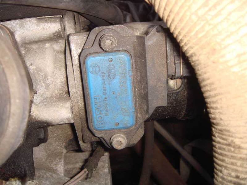

Just got back...I returned to the car with a screwdriver and torch. Keeping the choke flap open did not help. I had to call the recovery again (the 4th time in a year). At first I was worried by the speed the lady from the recovery truck was pulling out pipes and roughly handling the stuff. but then the car started, she suspects the ignition module, or even only the plug that goes into it....maybe it just needed a wiggle. It is a blue ignition module, I think it is from Bosch but I will have a closer lock tomorrow in daylight.
cacaolat
Posts: 365
Location: London
Post by cacaolat »
Next Day: of course the car started without problems today...I am still confused wether it is the carburator or the ignition module or just the plug to the module. The ugly old air pipe is sort of pushing the plug a bit....see photo.

Why not simply remove the plug from the amplifier, apply some WD40 to its contacts, and then push the plug on and off 2 or 3 times to clean the contacts. It looks like the lady may very well have found your problem. I had a cold start refusal which I traced to the amplifier plug, and another member (doz) recently reported a misfire problem which he cured by cleaning this connector. http://bxclub.co.uk/forum/viewtopic.php?t=6873
I don’t think it’s very likely that your autochoke is the problem. The autochoke performs several functions, but the particular malfunction which could cause cold start refusal is very easy to check. The choke flap is the one which stands straight up when the engine is fully warmed up. With the engine cold, you should check that it is fully down in the completely closed position. You should now be able to push it with your finger into the full upright position. It should feel reasonably free and when you remove your finger the flap should spring back to the fully closed position. If for some reason it does not fully close, then this could cause cold start refusal.
