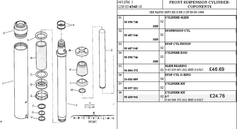

Seems a bit expensive but compared to the price of a new one :?

The complete kit from citroen cost £50.35 + Vat i know because i bought two kits and did the struts on my old TGD the hardest bit is getting the bronze slide bearing undone. :lol:

Just looked on PR net (revised) Strut kit now is £24.76 inc VAT. So cheaper from Citroen for this one.

It looks the £24.76 kit is part number 95 650 941 which consists of items A+B+C+D+E+K+L+M+N but does not include the slide bearing.
The slide bearing costs £46.69 inc vat.

i thought 24 was a bit cheap considering the bronze slide bearing was 30 something on its own and about 20 for the other kit.
