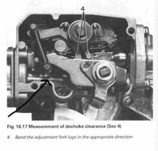

2. It doesn't run very well when cold. I'm assuming this is a problem with the automatic choke. Any guides on setting these things up properly?

2: Throw the autochoke in the bin and fit a manual choke.

Re. autochoke: take the black box off the side of the carb and spray all the linkages with carb cleaner and then lube with Comma spray grease or 3-in-1 oil. Clean and lube the horizontal pull-down control rod at bottom left which enters the choke diaphragm chamber at the rear of the carb. Move it to-and-fro with some needle nose pliers to ensure it moves freely.
Mine was sticking, causing all kinds of trouble. Also check all the usual things: plugs, leads, dizzy cap, timing.
