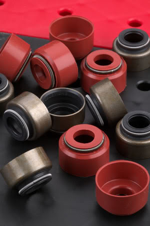

How does this oil business work, anyway? I've been told I've got slight valve oil seal problems, but that there are things to use which might slow the problem down & stop it from developing (1990 1.9 petrol engine). I've been putting in 20W50 recently - is this the most sensible oil to use?

You'll probably have noticed that when certain chemicals come into contact with rubber - it swells. This is the theory of additive sealers - they simply make the seals swell up - whereupon they do their job again.
Try chucking some rubber components in cellulose thinners! I did it many years ago when I was overhauling someone's trailer brakes for them. Chucked them in a bath of the stuff - and next morning various covers which would have been very difficult to replace were about half as big again! - fortunately they returned to normal over the next couple of days!

If a petrol BX is using oil it's usually from the valve stem seals. This means that it uses oil but doesn't smoke under harsh acceleration or heavy load. Commonly they don't smoke at startup either as the oil has usually subsided back to the sump beofre it seaps through the seals.

Modern sealing additives have nothing to do with rubber swellers ...
Its a lot more elaborated process that slowly seals up an engine from inside all over where the engine oil flows around.
Besides - how many rubber seals do you have inside an engine that would cause smoky exhaust because of leaks ?
Most seals are provided to avoid external leaks, i.e. dripping etc.
Valve stem seals are no more simple rubber seals. Its a couple of engine generations - including the BX engine range - ago rubber was abandoned here.
Ever heard about heat hardening plasticide ceramics ? Thats basically a rough explanation to how it works.
I've been using this modern additive stuff in my 19tri engine, which was a notorious blue smoker when it entered my BX herd. It really works like a small miracle now after some 1k km.

AndersDK wrote:Valve stem seals are no more simple rubber seals. Its a couple of engine generations - including the BX engine range - ago rubber was abandoned here.
Are you saying that BX (XU/TU) engines don't have rubber stem seals? Certainly every single XU/TU engine I've ever stripped has rubber seals. In fact, ever single engine I've ever worked on ever has rubber valve stem seals. Granted, they're a modern form of hard rubber, but they are rubber none the less, with a small garter spring to hold the sealing surface as it wears.
Thus:
Also, This list of manufacturers of stem seals shows them all using elastomer (IE Rubber), or some blend of rubber/ptfe etc.
AFAIK all engine "stop smoke" additives are essentially seal sweller, and if used a lot will soften the seals so badly that they fail to work at all. If an oil seal leaks, there's only one thing to do. (well two I suppose; you could just ignore it.)

Not at all... I'm only going from my own experience. If there IS an alternative to rubber valve stem seals then I'd be very interested to know about it, as I've never heard of anything but rubber, and can't find any other reference to anything but rubber.
... as it has to be said that rubber in a valve stem seal doesn't tend to last too well in the environment it's being asked to work in. The ones on the classic race engines we build at work go nice and crispy in no time at all.

It began to use oil and the cause was put down as leaking valve stem seals. She approached the chemists/engineers at the company concerned who told her to go lighter grade.......lighter grade? :shock:
The theory was that if a lighter grade was used immediately upon finding that it was using oil, that this allowed the oil to drain off the valve stems and not slowly all drain down into the cylinders as heavier would tend to do. She reckoned it cured it.
I can't see it myself, but she had no reason to lie and was pretty switched on as regards cars.
As far as 1.9 petrol engines using oil is concerned; if it's the DFZ engine then better than even chance it could be stem seals but a DKZ, can quite easily be incorrectly fitted rings which aren't all that expensive to replace.
