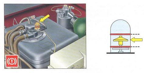

Picture from the Xantia owner’s book, not identical, but still the same. :roll:

/\ That shows a LOW fluid level on a BX. The next ring down on the float must be within the 2 red marks.

I can confirm that the diagram is correct for the BX as well.
The bottom ring is infact the metal disc that forms the electrical contact between the contacts for the low level indicator..

Brian wrote:I can confirm that the diagram is correct for the BX as well.
Sorry Brian, you're incorrect as the diagram for the BX (From the Citroen Handbook) shows the indicator as the second ring. If you are operating to the top ring your resevoir is lower than it should be.
Brian
Posts: 441
Location: Bedfordshire UK
Post by Brian »
Way2go wrote:
(Sorry Brian, you're incorrect as the diagram for the BX (From the Citroen Handbook) shows the indicator as the second ring. If you are operating to the top ring your resevoir is lower than it should)
Hi, I don't think so...I think you have a handbook with a fundamental error printed for the level diagram.
I have two handbooks and the level diagram is similar to that shown in the thread that Clogzz sent..
But as it has been said, the level is not that critical, but if over filled will mist out over time and the good news - it will combat the effects of corrosion, but will also make a fine mess..
The bottom disc is in fact made of brass, and is the switch contact for the low level light and not the indicator marker...
