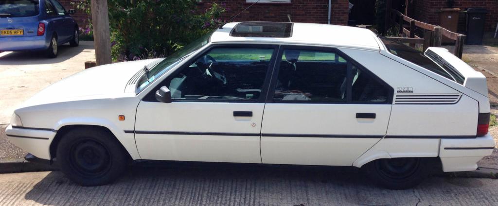

Took the opportunity of a break in the weather to give the TZD a bit more of a check and the news is pretty good.
Starting from the front end the bumper's all there bar an end car/blade and will come up a treat. The spotlights don't work and look their age, so it's probable we'll (when I say 'we' I mean me and Kermit) replace them with Hellas - complete with covers. Headlights are pretty new but I'll want to replace the indicators. The engine bay is ok and there's nothing untoward there; only a small bit if rust starting behind the LHM reservoir which I've now cleaned, treated and waxoyled. Under the water bottles is clear and rust free.
There's a new battery and the oil filters pretty recent. The air filter on the other hand was well dirty so I fitted a new one, although it'll eventually be replaced with a cone. The pump belt's new.
The car's going in next week for cambelt, seals, water pump etc as well as coolant flush and oil/filter change.
The accumulator sphere needs replacing I think and the spheres possibly need a regas. I'll wait for Dennis to give it all the once over... An LHM change might be a good idea. There's a small drip from a low pressure pipe repair; that'll get fixed. FDV is dry.
Generally I've found no rust to concern me. It's new MOT came with no advisories. The boot floor's fine as are the inner wings and pillar bases.
Other points: Exhaust looks old but works fine, the brakes work OK but I suspect new discs and pads all round might be needed at some point soon. the sunroof drain holes must be clogged as it's letting water into the driver's side rear passenger footwell. It's not looking like this has caused a major problem yet but the rain we've had recently hasn't helped.
General note: I am not restoring this to show standard and non-standard upgrades will find there way into it. But what I do want to do is have it performing well with typical BX reliability... And I might even replace the trims I have with black ones the same as I have on the ZX until I obtain alloys (if I go that route)....

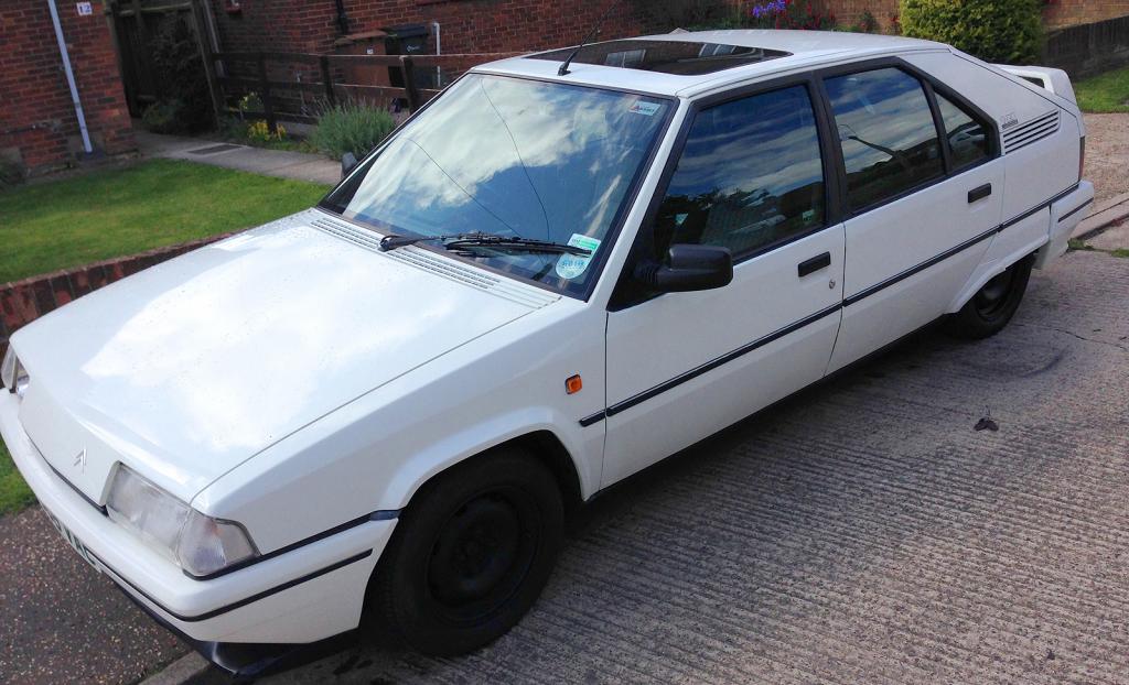

The work's begun. New cambelt, seals, (waterpump, tensioners fine), brakes checked - discs and pads good for 10k plus miles yet - plus drivers window mended - not long term fix but secure, bodywork in good shape. N/S strut top a bit rusty, but have a new replacement one - which will be done when the rear arm bearings are done as the system will be all depressurised for that. LHM so-so, and I'm considering a flush. Most other bits in good order considering. Sunroof drain tubes need clearing as have slight pond-thing going on behind the driver's seat, boot leaks too (might be related)... Front wiper washer doesn't work, but Kermit has plans to fit improved set up. Needs the tailgate repairing and new badges - (anyone got the generic Citroen badge available? I've got the BX TZD TURBO one), paint's a bit flat and there's some cosmetic tidying needed here and there, but essentially it's good.
Tyres and wheels - still having a think.
- Posts: 11591
Re: Talking B____X
Needed a new battery - went for a calcium one 540 start up/60amp jobbie. Not the cheapest but should be absolutely fine for the winter and onwards...
I've decided steel wheels are what I want so will put the same trims as I've put on the ZX for now (I'll then have a spare set for the ZX when I 'upgrade' the BX's). As for tyres: My head tells me to go for either Continental Ecocontact 5 or Goodyear Duragrip; both tyres with excellent fuel efficiency ratings and good all-rounders. But my heart wants Michelin Energysavers ... Might have to go on price in which case the Goodyears have it...
Anyway, before rain stopped play I managed to at least clean the car, polish the bonnet (which is great now and suggests the rest of the paintowrk'll come up well) and get the front bumper tidied up...
