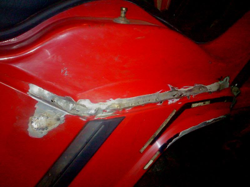

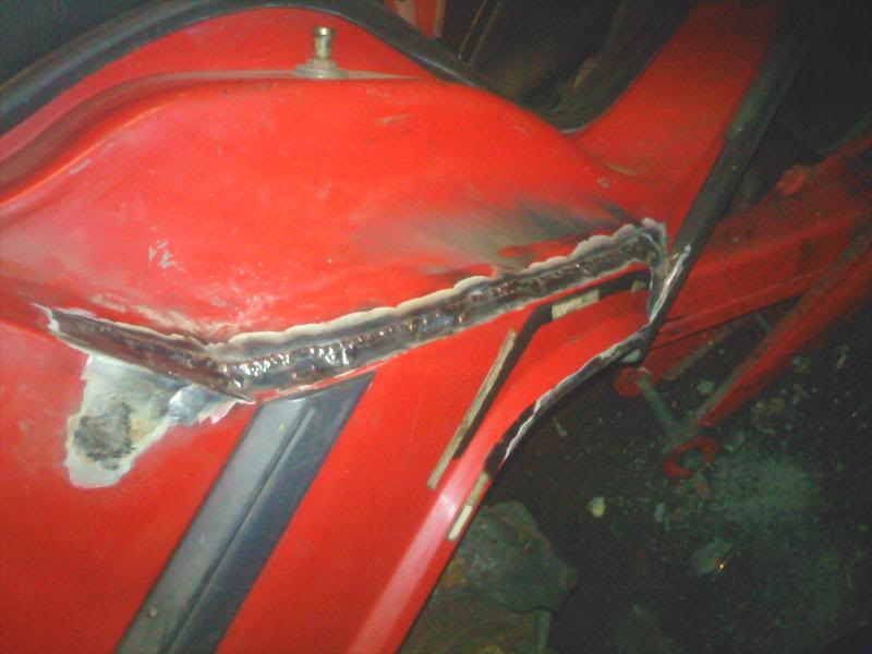

Did a spot more welding tonight - with mask! I'd split the C pillar seam some weeks ago now, and the Deox gel had got to work removing the rust between the layers.
I then ran a bead of weld all the way down the outside. This should keep the seam more rigid and prevent cracking of the sealant and consequent water ingress. I did consider welding both sides, but feel that I wouldn't be able to do a great job underneath due to the access. Plus there would be no way to protect the metal between the two layers. This way I can get galvanising paint right into the seam, and then seal it all
It's now primed, but I didn't get a photo.

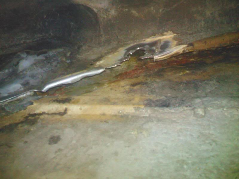

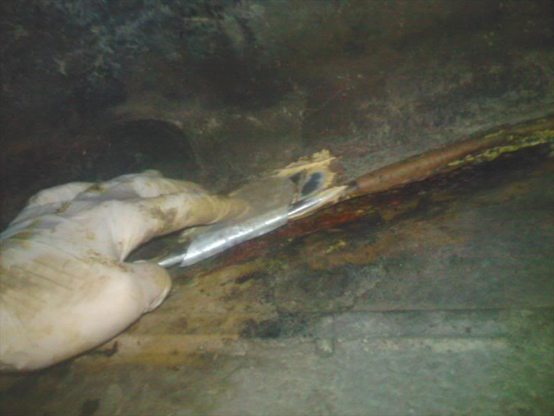

More weldy weldy tonight - there was a small section of rot on the inner wing. I removed all the crumbly bits, and let the rust remover do its job:
Then cut a piece roughly to shape...
...and welded it in place.
Far from my neatest ever job, but now solid at least. If the paint dries tonight (got the fan heater on it!) I should be able to seal the seam properly.
