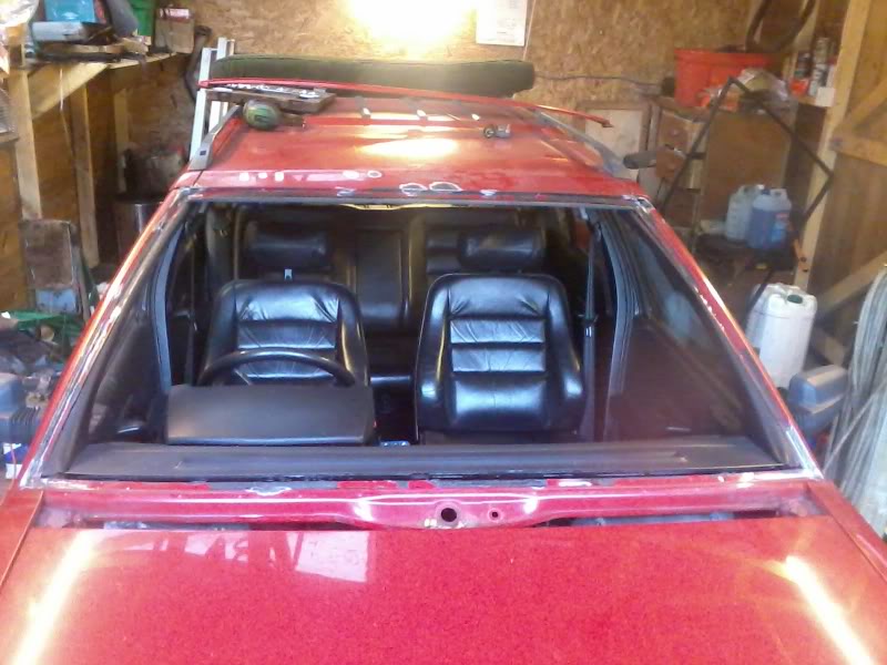

I too was surprised at the extent it had spread behind - I knew there were a couple of areas which had appeared over the last 2 years but had not yet broken the paint on the pillars. The heavy salt the last 2 winters was probably a large factor. I'm not suggesting that everybody whips their windscreens out for a check though, but I suppose it can't do any harm to peel back the seal lip and have a peek if you plan on keeping the car long term.
Having said that though, once the screen was out the whole job (before top coat) only took about 3 hours. And only one piece of welding was strictly necessary - the others were more because Zinga can't be painted on rust or converted rust, only shiny bare metal so I had to get rid of any trace of rust. If you were using conventional paint then you could probably get away with a grind back and simply treat the rust that hasn't penetrated. That should still last for a good few years.

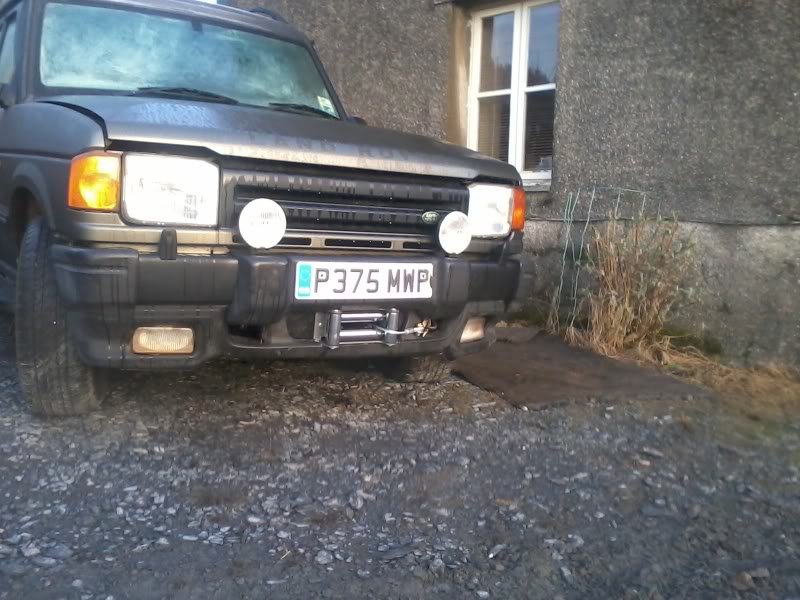

Still not got the screen in - got sidetracked fitting a winch to the Disco...

My thoughts exactly. Most of the time it's going to be sitting unused (just an insurance policy but the main use is for felling and moving logs around), so it makes sense for it to be low down and out of the way, rather than hanging off a great big heavy winch bumper. Any mods I do to help off road need to NOT compromise the use on road - which limits it to a winch and maybe locking axle differentials. No lift kits and monster tyres for me!
Must admit. If Landies had a lockable or limited slip rear diff, they would be bloomin' difficult to stop. I had a Mk1 Trooper with a limited slip rear diff. Had crap axle articulation, but that didn't matter as even when it was waving wheels in the air, it'd just keep going!

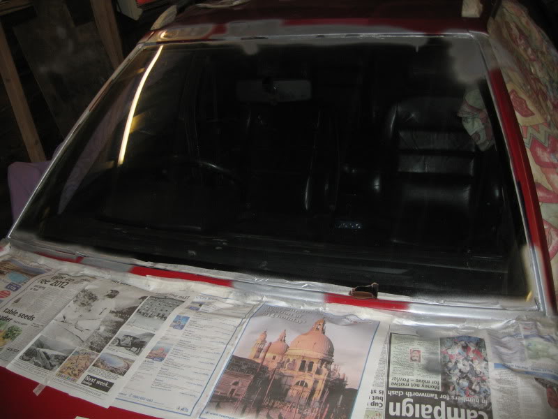

This afternoon I managed to grab some tinkering time, and temporarily put the old windscreen back in the BX. This saved a lot of newspaper and masking tape!

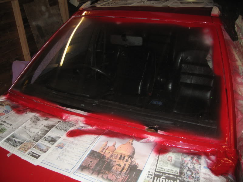

Repaired areas now primed...
...and topcoated.
I'll hopefully get the new windscreen and seal fitted later this week - the fitter has been keen (understandably) to get the job finished as he's already bought the new screen!
