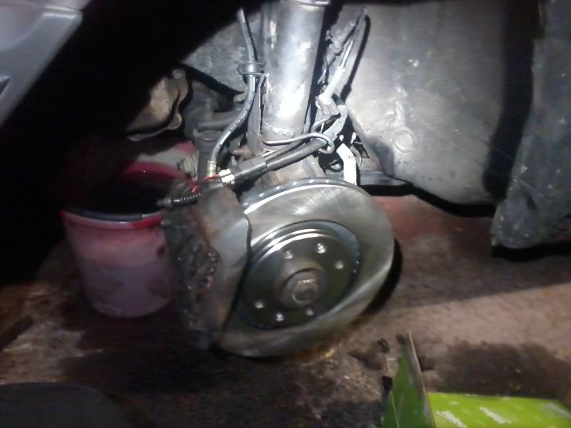

Ball joint and discs arrived
But I then noticed the intermediate bearing on the 'good' driveshaft span rather noisily. Fortunately, one of the others was perfect, so did a spot of mix 'n matching to get the best of all of them. Gaiter should be in tomorrow morning, so once that's in the front suspension work should be complete.
Doesn't look much different, but hopefully should drive differently!

Yes, I've had them for the last 60k miles, so it was time for a set of new discs. Quite pleased to find Valeo discs for £10+VAT each, cheaper than most of the bargain basement stuff on eBay.

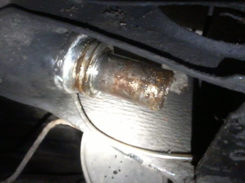

The front end is back together now, so moved my attention to the rear. The rear calipers were a little bit sticky, so cleaned them up and freed them off. Cracked open the bleed nipples too and will bleed them tomorrow if I can find a willing assistant. I wanted to sort out a small weep from the O/S rear suspension cylinder; when I too off the boot this is what I found:
It seems like the boot has had a small split in it that I had not spotted (looks more like damage rather than age, as the rest is not perished). Water has got in and rusted the piston so it no longer seals fully. Fortunately I have a spare almost new cylinder assembly which I had kept when the rod snapped, so I'll pop the piston in tomorrow.

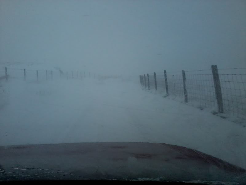

What a morning. I woke up to a little bit of snow on the ground, but had to take the BX rather than the Disco as the MOT is booked for today. The higher I get, the worse it got and very rapidly!
Not easy to see where the edge of the road is, so just trying to keep it inbetween the fences.

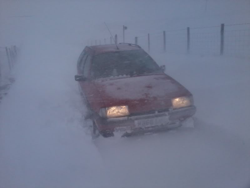

Stuck in a drift, so decided that it's time to put chains on.

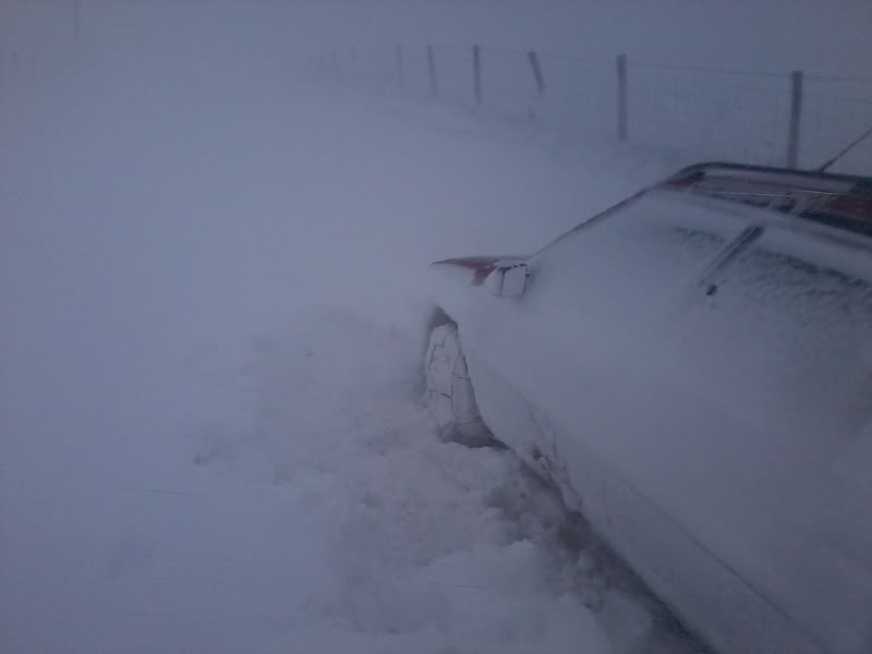

This is after about an hour and a half trying to put chains on, had to dig out around the tyre and then a link broke as I tried to drive away. Fortunately I had a spare link but still had to take them off and it was not easy replacing the link without a vice.
This is what I looked like afterwards, my damn hat kept slipping over my eyes due to the weight of the snow! Made it over the hills and down to the MOT station, but only after another link broke and I had to continue (very carefully) without chains. Fortunately downhill, otherwise I'd have probably struggled to make it.
