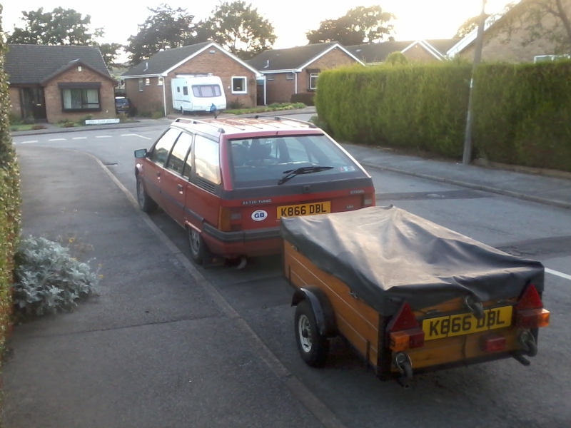

In other news, my Dad gave me a trailer when we were over there yesterday!
I repaired it for him about 20 years ago (bent chassis) and he's barely used it since, so he said I might as well have it. It's not been used for 10 years, so he put a set of new tyres on it (including the spare. Bonus! I was pleased to find that the wiring I did back then all worked first time, and nothing fell off on the way back :)
Re: Mat's BX Blog
I bet Lana was a bit draughty on the way home. :)
Re: Mat's BX Blog
Loving the castors on the back,I'm guessing so you can store it on its end or you could attatch a sail to the tow hitch and...... Nah I guess not
