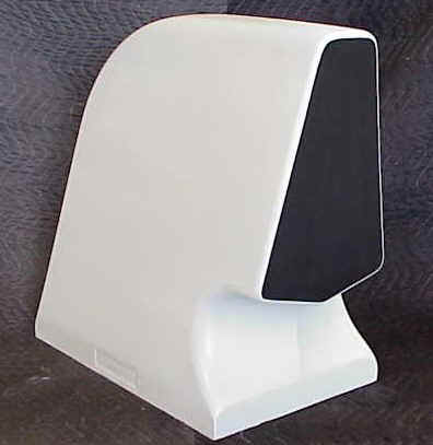

As for an intercooler I will be using the standard one for the moment - I know that the position of it isn't great, but I'm not sure I can easily fit a front mounted intercooler with the air con condensor sitting in front of the rad. I am wondering about a scoop though if I can find a sutbtle one. (Not like this one!)
