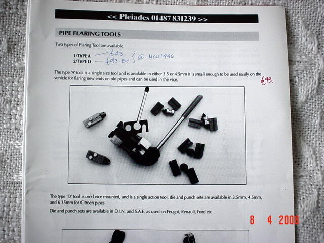

Anders, so far there are three tools that i know of
1) pleides compact
http://www.pleiades.uk.com/products_3.html
small ahnd held unit, bit fidly but can get into some brilliant locations for patching on the car.
From and Email in 2003;
2) pleides universal
big unit that is mounted in a vice and does nearly all the work at the swing of a lever
from an email in 2003;
Theres also a Type D pleiades tool on ebay with all the bits, but there seems to be some strong bidding (i've been the highest bidder, but i can see it getting expensive!).
As for the piping etc the rest of the email from 2003 is as follows;
Oh GSF also seem to have stopped supplying unions, pipe and large LHM containers! But i'll call and see if they have any left!
Service.Citroen seems to be down so i can't check the pipe price, but i think i've just been suitably put off!
Oh this will be fun
Jonathan, i'm meant to be competing in a big canoe polo competition this weekend, so i wont be here either, but i need to sort my own transport and REALLY dont want to go in the Corsa, so might have to see about a weekend long test drive from Citroen!! We will see! I do have an R-reg fiesta, a diesel Corsa and possibly a diesel AX to borrow, but a C-Crosser would be more fun (especially given the fuel is paid for!)
1) pleides compact
Type A flaring tool costs £45, and is available in either 3.5 or 4.5mm.
3) this tool i'm not too sure about operation, but its a name that has popped up many times, apparently MC Lockwoods can supply a tool (01274 640 590) going to call them (and Pleiades tomorrow)Type D flaring tools is £93.80, the split die and punch sets are available
in 3.5,4.5 and 6.35mm costing £23 each.
Obviously these prices are 5 years old, but i hope they havent changed too much! I'll update this tomorrow!3.5mm pipe is £1.30 per metre,
4.5mm pipe is £1.50 per metre
6.35mm pipeis £2.50 per metre.
3.5 and 4.5mm male fittings cost 30p each,
6.35mm male fittings cost 40p each
3.5 and 4.5mm female couplings cost 70p each
and are not available in 6.35mm.
3.5mm LHM seals are 15p each,
4.5mm LHM seals are 20p each
6.35mm LHM seals are 25p each.

The man from Pleiades, he say Yes! (acutually he said a lot of 'no but),
Type A tool (3.5mm and 4.5mm) £56+VAT but they have NONE they are in production but might take a while!
Type D tool - no longer stocked as amazingly they didn't make more than about £5 profit per item and where a swine to get hold of!
3.5mm pipe (rolls are 25m) £1.60 a metre
4.5mm pipr (rolls are 15m) £1.90 a metre
3.5mm and 4.5mm male fittings 35p each
3.5mm rubber seals 15p
4.5mm rubber seals 20p
They've had someone in last week who has practically wiped out there stock so availability at the moment is sketchy at best! But i've put a large order in for me, might as well stock pile a little!

Cit specialist down the road from me had one of those pull the handle types - he made up new rear brake pipes for me for a Xantia - it worked extremely well and quickly, if I was considering buying one, I would splash the cash for one of those, rather than fiddle around with one of the screw on types (unless you wanted to do on-car work).
Just don't forget to fit the unions to the pipe BEFORE pulling the swage

Richard, re fitting the union before flaring, thats one of those mistake i make EVERY time
you'd think by now i'd learn, usually by extra connectors while i'm at it.
