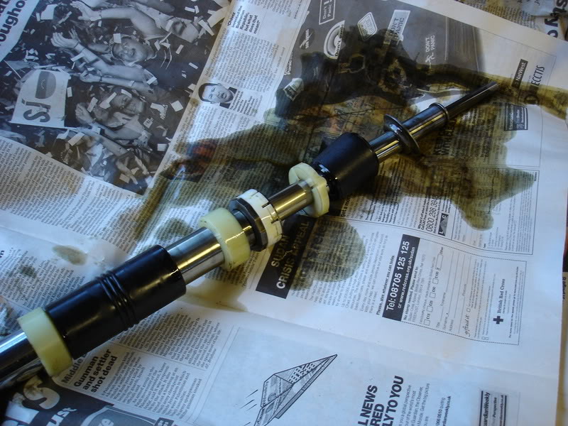

I have rebuilt two in the past. The difficult bit is unscrewing the top cap. It is stiff all the way off due to the hard setting sealant cit. used.
I borrowed a cut down front hub from Bob Smith to clamp onto the strut and just hammered it round while holding the other end in a vice.
If you dont polish out the wear grooves on the inner piston it will still be jerky and a bit stiff despite the new seals. Easy job though.
The Japanese site archive of the rebuild can be found here: http://web.archive.org/web/200101100131 ... /m05e.html
