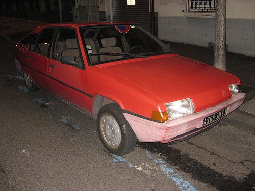

Here's a pink/white one - it is the bumpers that go the most

Dayum! The bumpers on that Mk 1 are even worse than the Red Shed's!
