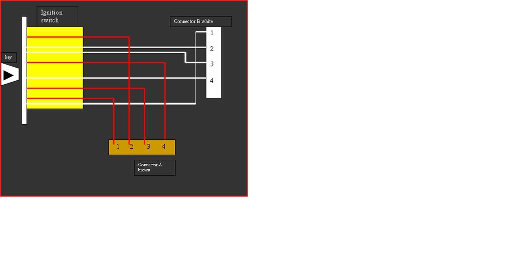

Thanks for the directions, Have now found these, now trying to match the diagram to the replacement Valeo ignition switch steering lock supplied by AEP, must say not having much success. The old and the new look completely different.
If i could work out how to post the different diagrams????
This is the new one followed by the old one!
any ideas anyone?
any ideas anyone?

They are directly interchangeable - despite the layout and design differences.
Its obvious that the number of cablings have been reduced in the new harness (to save on production cost), but they still provide the 4 switchable positions on the key.
Note that in your RHD UK BX the ignition switch harness uses an extender chord to reach the fuse box in your LH passenger side. Lift out the old cabling and you will find the 2 connectors under the carpeting.
All connectors in the BX are coded by cutouts and taps on the plastic housings to avoid wrong connections.
Final notes :
The old white - and the new black - connectors are the feed points. All 4 possible fitted connector pins are connected to the same point in the fusebox : +12V live. The use of multiple pins & wires are to spread out the electric load, thereby avoiding possible overheating of the connector. On later designs this has been left out as the load never reached the limits anyway.
The old brown - and the new white - connectors are the switched circuits from the various key positions. Again these circuits have been simplified on your new switch harness, but all functions are still there.
Warning : do NOT tap any of these wires as it may lead to a fire. These live battery wires are NOT fuse protected.
They do connect to fused distribution points inside the fuse box though.

hello again, just not clear on one point and would appreciate help: the extra floating green single wire which is connected to the white connector at socket number 1?
I can't see where this needs to be connected?

Thanks for the tip, I've been looking everywhere for a male connection to mate with it.DLM wrote:It's a feed added to later Mk2 switches to feed the ABS circuit, and as such, you can ignore it. If you are can get hold of a Revue Technique for the BX14 there will be goodies there.

Just to add, job done. veleo part went in v easily. didn't have to reshape fitting
Thanks for the help everyone who chipped in.
