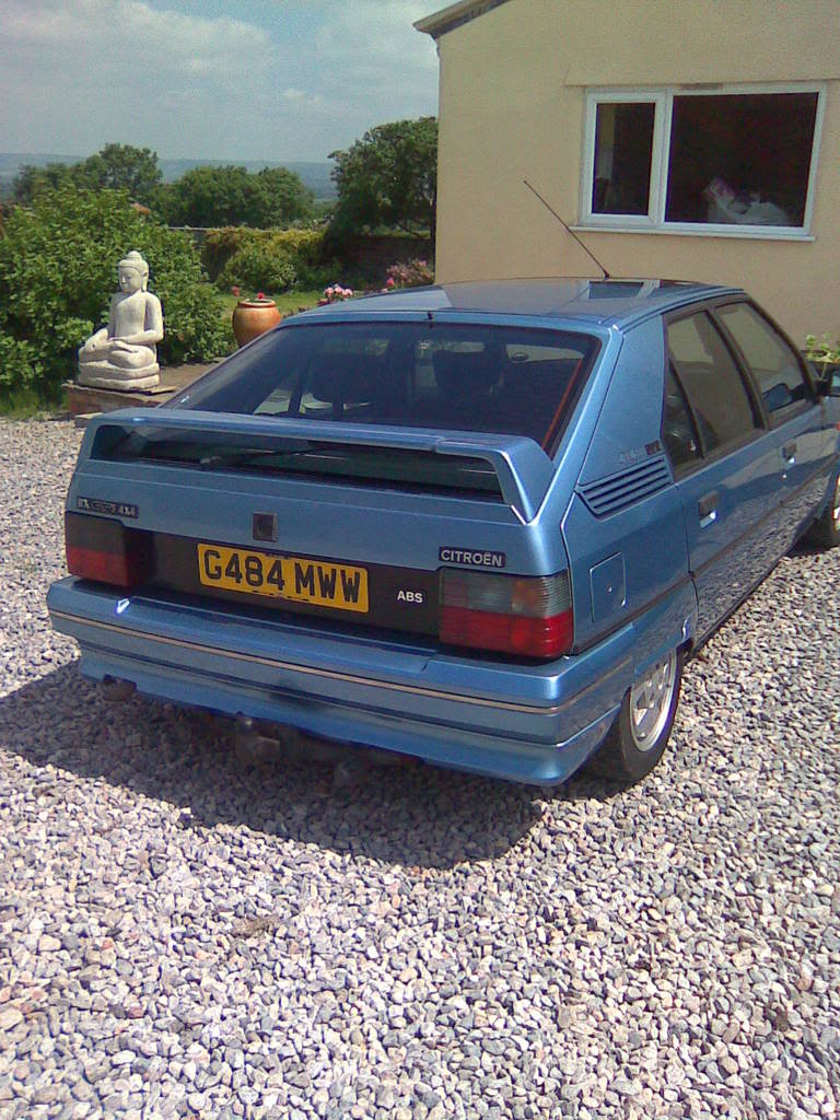

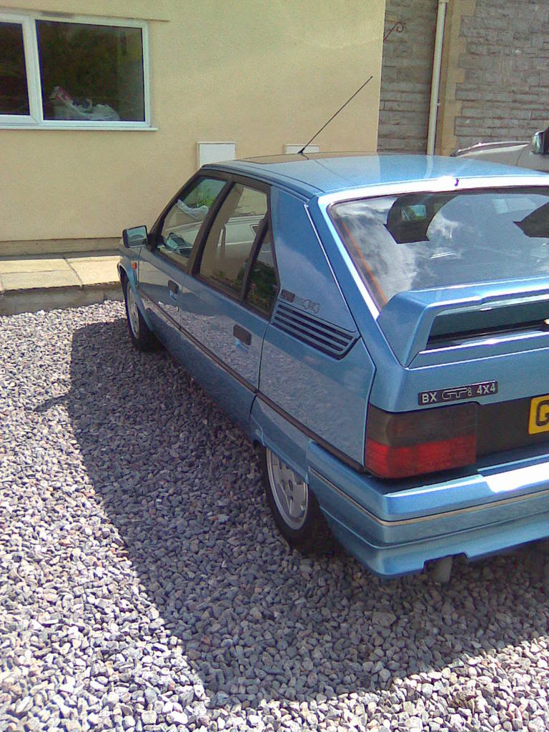

Lovely condition and a nice colour to boot.
