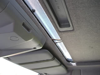

The sunroof is shot and it looks like somone's been playing as the cables are poking out! Exhaust is rattling but I don't think its blowing. Electrically everything appears to work apart from s/r. Even the heater controls are ok!

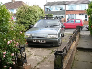

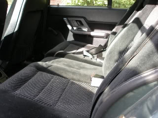

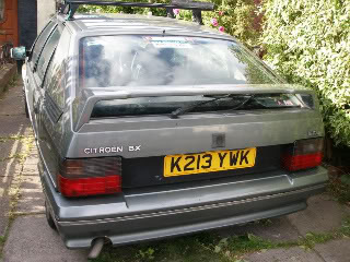

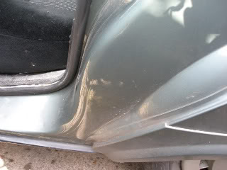

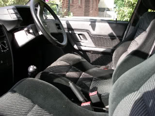

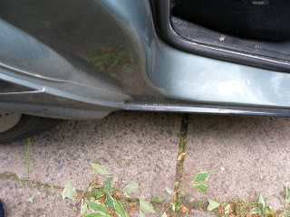

Piccies of new motor. Notice the Xm peeping round the hedge. Fiat Cinq in front of the Xm for sale if anyone's interested. Ok ok there's no need to get abusive! :roll:
Image Image Image Image Image Image Image Image Image Image Image
Not brilliant as can be seen but its something to go at. The front inner arches have been patched but the rear shuts look perfect.
Dave.
1990 Bx TGS automatic.
Looks good to me! I've got a steel bonnet on my '85 TRD by the way, who knows why?
Ive got a steel bonnet on the TXD & a plastic one on the turbo, both K reg.
Nice colour that car, same as my Gti :D
demag
Posts: 720
Location: West Midlands
Post by demag »
The pictures make it look a lot better than it really is. There are little scrapes and marks all over it which is a shame. Its only had three owners so was probably looked after for a good while. The person I bought it off was driving it round with flat suspension saying what a good laugh it was over the speed humps!! :evil: Its a wonder its still got wheels on! I reckon its had a tough time over the last year or so. Still I'll put a bit of time into it while the sun is shining. I've got two front spheres so will try and get it standing up properly asap.
