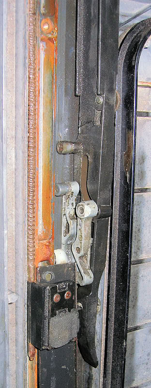

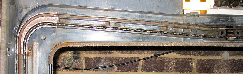

Don't know how rhetorical this question is but...demag wrote:Sunroof cables? Don't know how they fit but mine are hanging out.
The bit on the right-hand side is where the sunroof motor attaches in the centre...
...and at the other end the cables are attached to the black plastic bits at the sides of the sunroof. The whole cable run is under black steel covering, from memory about 3 sections per side.
These are 'before' images of mine, complete with rust and loads of crud. A good cleanup and lashings of grease works wonders!

Oh yes!!! Although you can see some of it with the sunroof open.
If you do drop the headlining, don't make the mistake that I did - take the sunroof glass out first. Can't remember exactly how but basically it's a case of tilting it up then undoing the screws around the inside of the glass (one of those flexible screwdriver thingies helps). From memory the black plastic runners fixed on the side of the glass can then be unclipped from the whitish sliders shown in the 2nd picture. All pretty straightforward really and I think I since saw it in the Haynes BOL.
Taking the headlining down is easy, albeit heavy in an awkward sort of way. Screws at the sides, visors, interior lamps/sunroof motor all out. Might have to take the pillar trims out as well (don't break the brittle interior lamps and careful with the trim clips).
On mine, the drain tubes were glued at each corner and were a bit of a fiddle freeing them and supporting the headlining at the same time. However this was helped by a large amount of sticky goo that was applied to the sides towards the front and which also needs to be removed (or at least the seal broken).
Then it's to work with a camera first (to remind you which of the many small bits went where!), then a wire brush, rags, tub of grease... then as they say, reassembly is the reverse.
Result - beautifully smooth operating sunroof which, one of these days, the sun will be out long enough to make use of!

As far as I recall from my sunroof-dismantling days (Ah, the joy of having an estate now) the cables sit under covers which have to be removed carefully for access. In fact I see BaldBazza's mentioned this in his post. Do you still have the covers over the cable runs? Without the covers in place there's not a lot to stop the cables springing out of those runs.Sunroof cables? Don't know how they fit but mine are hanging out.
