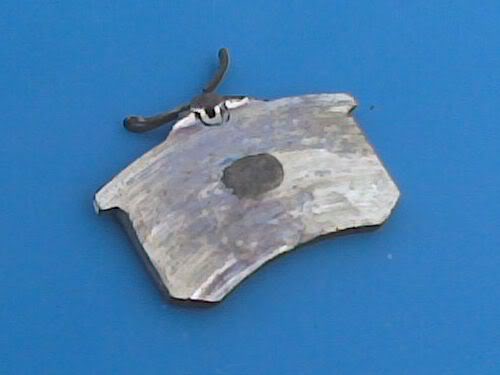

mat_fenwick wrote:one side of the vented disc was almost down to the ribs.
Makes this passat rear brake pad look in good condition then:

Hmmm, yes - that's lost its newness. In my case the pad backing was so thin that I could (easily) break it with my finger. The whole thing made me quite angry at the time, as she was probably only weeks away from the piston jamming in the disc ribs and locking the whole thing solid. :evil:
