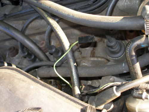

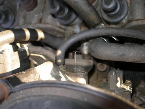

I stopped the engine and opened the linkage fully to check secondary throttle operation which was ok. I've taken some pics to show a loose wire and an unconnected connector which is directly at the back of the carb and is arrowed in the picture. Sorry I'm not very good with "paint"
I assume these two should be connected but I don't know their purpose.

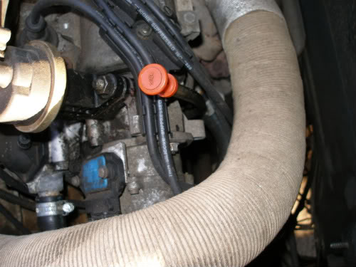

In the third picture I took a shot of the dizzy and noticed two black marks on the flanges which I would have thought should be lined up.

This is looking better now. After verifying the carb didn't seem too bad and noticing the marks out of line on the dizzy I've just been out and lined the marks up. David you were spot on with your diagnosis! I started the engine and immediately noticed it had a bit of "kick" when it fired. Revs went up to about 2000 on choke and after a few minutes settled to about 1800 then dropped to about 1500. As the temperature rose the revs eventually dropped to normal tickover and blipping the throttle produced a sharp crisp pick up. I didn't take it for a run but will report back when I do.
As I said in another post I don't think this car's been looked after for a while but now it's starting and sounding a lot better I'm feeling a lot more hopeful for the future.

I must try that on mine as its still a bit of a pig to start when its warm.demag wrote:This is looking better now. After verifying the carb didn't seem too bad and noticing the marks out of line on the dizzy I've just been out and lined the marks up. David you were spot on with your diagnosis! I started the engine and immediately noticed it had a bit of "kick" when it fired. Revs went up to about 2000 on choke and after a few minutes settled to about 1800 then dropped to about 1500. As the temperature rose the revs eventually dropped to normal tickover and blipping the throttle produced a sharp crisp pick up. I didn't take it for a run but will report back when I do.
