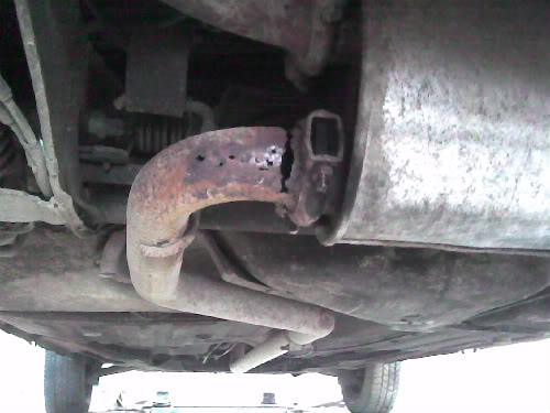

It looked like this to begin with:

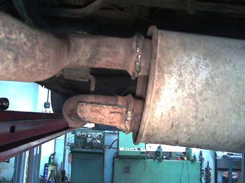

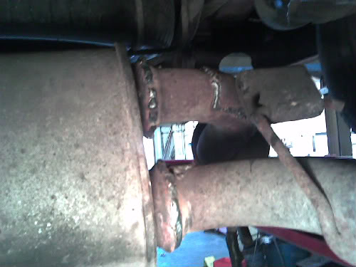

And eventually looked like this:
Although I did have nice easy access to it, as the car was up on a hoist.
It did only take me an hour or so to fix, but it would have been a lot easier to just sling a new one one it.

That looks like quite a nice repair, especially considering how rusty it looked in the first place. Did you do it all with the exhaust still attached to the car?

I didn't. It was far easier to remove the exhaust, weld it together, and then re-fit as a one-piece exhaust.Rob_e (UK) wrote:David
I now weld every single one of my joints up on exhausts. It's just so much easier, and so much less likely to leak. Granted, you have to be sure that you can remove and re-fit the exhaust in one go!

Lovely job there David, methinks that's exactly the perforation situation the man was referring to (minus the big crack). I think that would also explain the lack of blowing noise you would have with a holed silencer. However with no hoist and even less skill with a torch I guess my choice is limited to a visit to Kwikfit esq.

JKW has waved his magic mig wand and given a sadly corroded exhaust a new lease on life
Pity I never took before and after pics of the reconstructed flange
