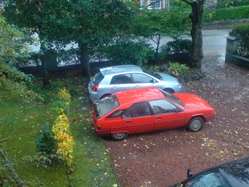

Mine also sinks at the rear
This was it the morning after I arrived home with it
However, that was 2 days ago and now I have already rebuilt the front height corrector and its linkage. So what? well the rear end still sinks down but now the front end sinks too - previously it stayed propped up.
If the rear end is sinking quickly, often it's caused by extra pressure loss through the brake doseur valve in addition to the normal leakage of the struts and height correctors.
