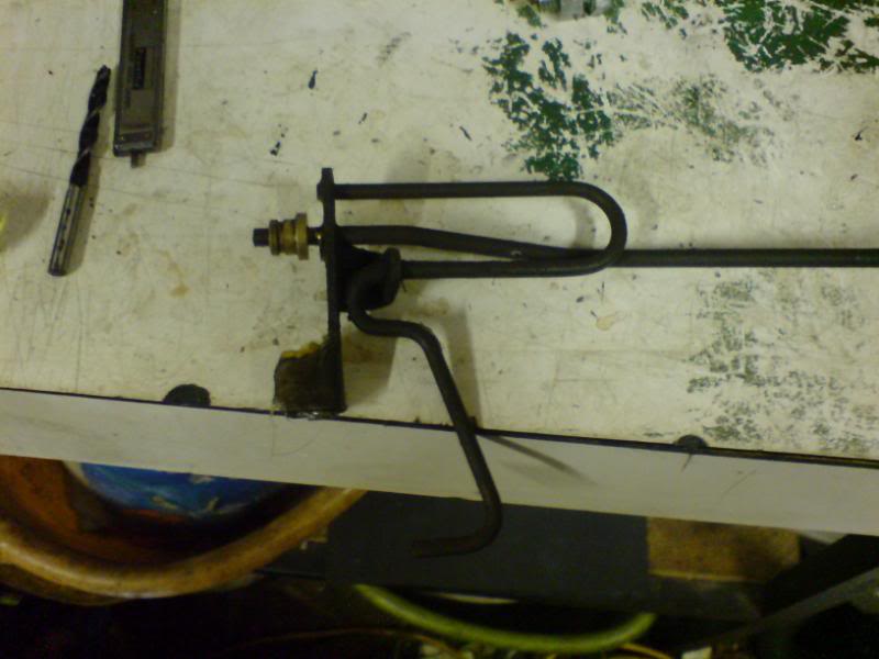

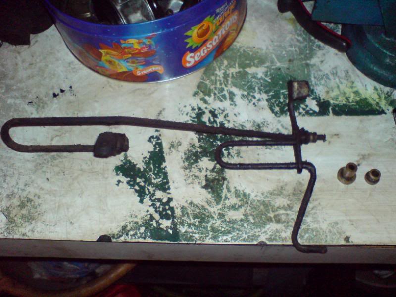

After doing the job on my CX and previous GSA, I set about repairing the height corrector linkages to make the legendary self leveling working up to scratch.
The linkage comes off easily on the BX and CX, the GSA is a different arrangement. Here's the BX rear corrector linkage:

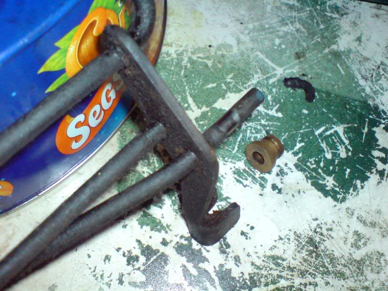

On the left is the familiar clamp to the anti roll bar and at the other end is a brass bushing that fits into the sub frame. This bushing wears over the years and gives excess play. Worse, the rod of the linkage wears in the bush giving more free pay. Add to that a sludgy height corrector it'll cause suspension that's too high some times and too low at others (also makes the intermediate height position a bit vague) Also in the picture is the modified brass bushing I had made with closer dimensions to fit the sub frame and to use a different part of the linkage rod to bear onto. There's also a spare original type bush pictured.

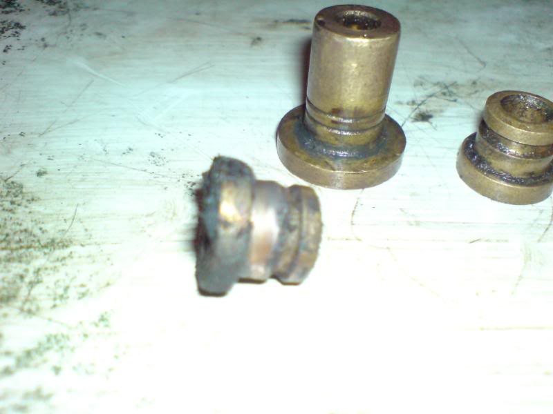

Here's the worn bush - can just make out the worn area (shiniest bit)
Here, the rod end part and the bush.
If you look at the rod there's a wee blue paint mark on the end and about 1/2" in from that you can see the corresponding wear on the steel rod. My new bushing attempts to get the rod to pivot on a different unworn area nearer the blue paint.

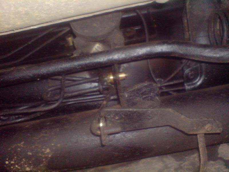

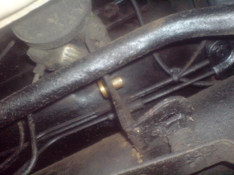

Here's the new bush fitted in the subframe, on this and the old one there's a steel clip secures it in the bush's groove - I made the groove slightly closer to the subframe so it was tighter but it wasn't needed as the new bush was a stiff press fit in the sub frame.
And here with the linkage back in place and plenty of grease in the bush and the fork that fits onto the ball joint on the corrector unit.

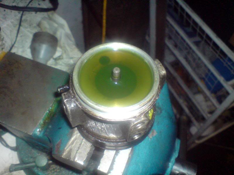

Height corrector had been full of black LHM
The ball joint of the corrector can wear too as can the fork end of the linkage lever on the rod above. These can be fixed too. The ball of the corrector can be carefully turned in its fixing using some good grips and a vice. It only needs a slight turn to move the worn flats away. The fork end has corresponding wear, the excess gap can be reduced after doing the previous ball join fix by taking the newly fixed ball joint and fitting it in the fork while on the bench - then getting your mole grips or vice to squeeze the fork around the ball - it'll bend that tiny amount needed while leaving the tiny clearance necessary not to jam up.

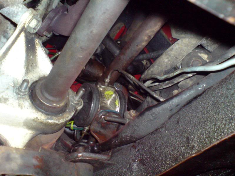

I was able to remove the two retaining bolts and the hydraulic pipe going to the struts, but this other one is killing me! So frustrating.
- there are actually TWO pipes on the other (hard to reach) side making 3 in total. The easy one to feed the struts, then the 2 on the other side of the corrector, one it the high pressure from the security valve and the other is the pressure return pipe from the corrector valve.
I am not certain if your car being a Mk2 has extra plastic covers/ things in the way (but I wouldn't be surprised :roll: ) but on mine, I found that I could get a spanner into the furthest forward pipe at a long reach and unwind it in careful and annoyingly small turns. The third pipe that's beside this one, it is the return and it joins straight onto the rubber return pipe junction 'octopus'. I found that you can't undo this pipe using the spanner but you can LOOSEN it. If you loosen it then remove the 2 mounting bolts, remove the corrector linkage (one 11mm bolt and pull along anti roll bar then turn 90? and route it out) and then remove the other two easier pipes it leaves the corrector disconnected from everything except this last return pipe that is now loosened.
There is enough room around the corrector now to hold the pipe union still and rotate the corrector itself to unwind it off the pipe.
This worked for me! Be careful not to put too much force/tugging on the rubber pipe as this might very well split or split the octopus.

Thanks for all the advice. Unfortunately I have yet to manage to get this feeding pipe off.
After another hour of fiddling, I had completely obliterated the screw which holds the pipe in place, I can't believe how very DAFT these screws are made. Utterly weak metal, abysmal quality. It's so stupid that they are actually hollow at the top end, more hollow then necessary. Why did they do that? :|
What you can't see on the picture is that I actually managed to split the screw in half somehow at the top, so besides being completely round instead of 6-edged, it's also split. So there's no way I'll get it off, and as there is no space at all to do it using calipers, I thought of undoing the pipe at the other end, at the LH octopus, where I actually have quite decent access from the wheel arch. I think the pipe would lift out nicely together with the height corrector. But guess what, the screw came off without problems, but the pipe is stuck in the octopus, can't get it out, not with all the force I was able to apply. :|
I'm exhausted, I'll give it another try in the evening maybe. I was able to remove the linkage, the bush is still in though, hidden behind the height corrector.
So either I've got two left hands, being unable to complete this task, or I'm just having bad luck :|

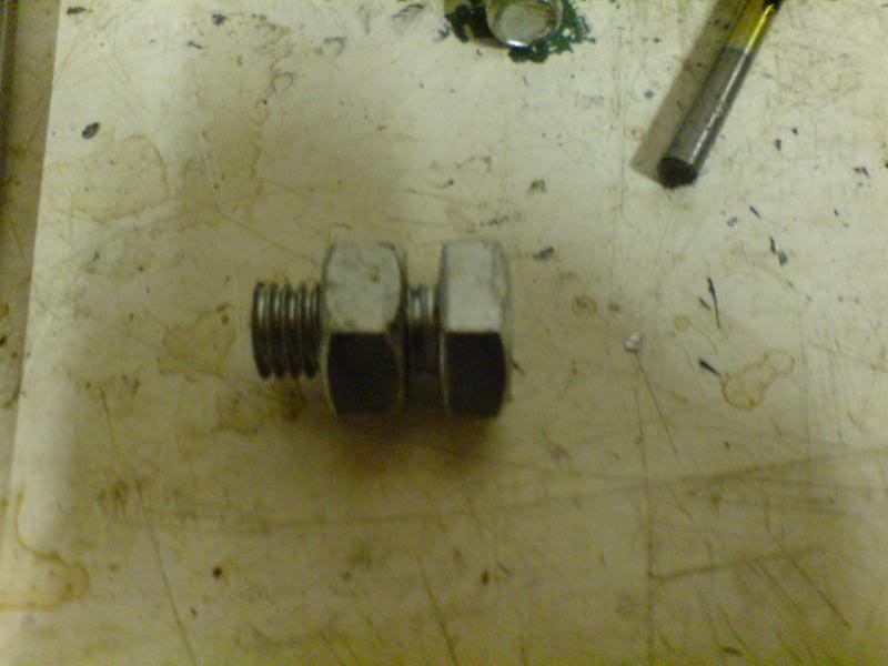

Also, one bit of misleading info I put in this thread about the brass bush: the bush itself is a sloppy fit in the hole through the subframe. The little clip is rubbish at securing it - it doesn't at all actually. Even with the modified brass bush at the top ^^ of this thread I found that after short time it too was loose.
I then decided to make a cruder but much more effective replacement bush out of a M10 machine bolt, cut short and with a series of carefully stepped holes through the center - the outside hole is large at 7- 7.5mm tapering down inside to about 5.6mm minimum. A pillar drill is used to drill the M10 bolt through.
This replaces the brass bush and with a M10 nut, it can be firmly secured in the subframe unmovable. Being a 10mm nut in a 11mm hole, you can also move it a bit to get it in the best position before tightening the nut.
You can see it in place in the subframe here just beyond the corrector. (linkage is not fitted in this pic)

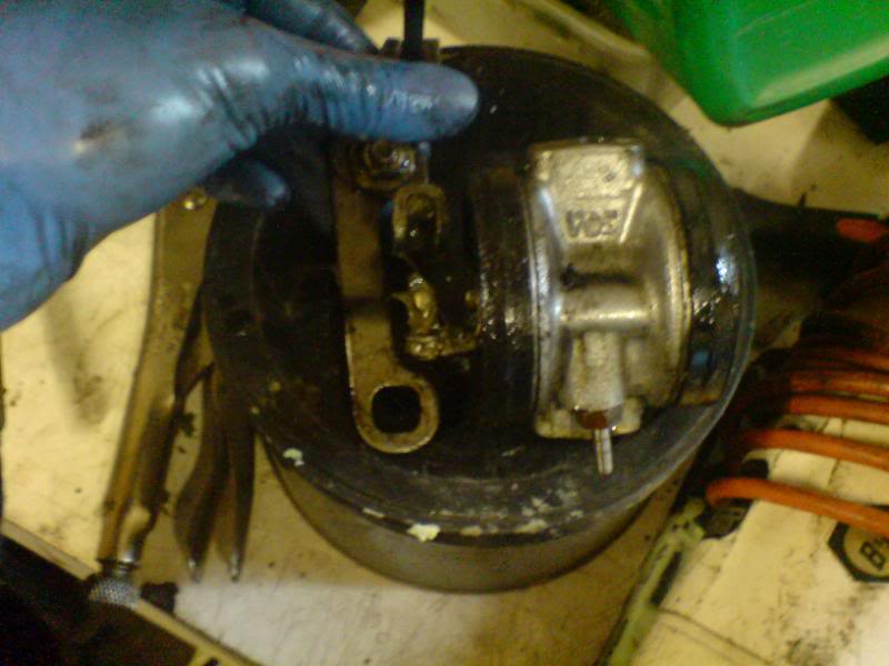

Also, when you do get the corrector off and it comes to dismantling it - be careful not to cut the inner rubber diaphragms when the clamp-ring thing is being prized off. If there is a hole in it it'll drip LHM!
