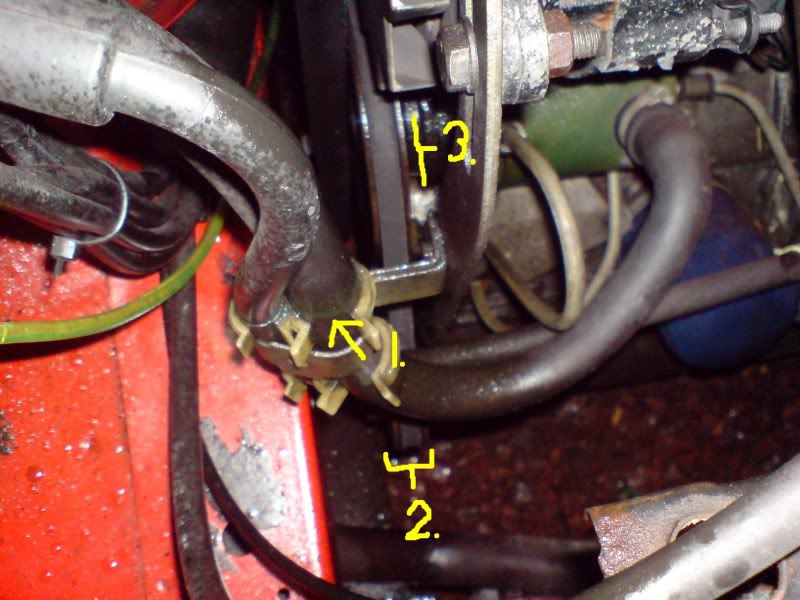

Well I had some time today after dark unfortunately, to look at the pump again. It's not clear where it's leaking from but certainly it's actually spraying up inside the bonnet! I thought it was coming out of the pump and dripping on the drive belt then spraying up - it is dripping on the belt but it's not cleat if it's leaking from the pump or the suction pipe.
If you look here, No. 1 shows an oozing of LHM at the middle of the suction pipe.
No. 2 is the part of the drive belt that's chucking it up.
No. 3 is the damp area of the Pump near the bearings that I thought was the leak source. It's never visibly leaking when it's running so you can't tell if it's leaking from 1. or 3. as the LHM seen at 1. could have been chucked up there..
Anyone know if the suction pipe is known to leak here at this (what looks like) join?
