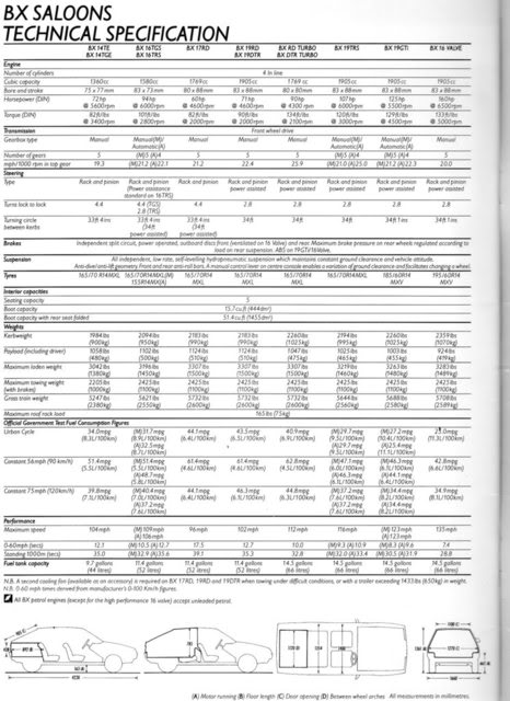

Scan from 1989 BX brochure follows...

Is it only 2bhp? I was under the impression that the 17TD was rated at 88 and the 19TD at 92? The torque figures are something like 132 lbft and 149lbft
AFAIK the garrett turbo boosts from lower RPM, and is definitely the one to have for low down torque. When they get to 4000+rpm, the boost is the same (as they are wastegate controlled now) and hence the power is the same, but the spool-up and low-rpm performance is definitely not the same!

I'm with the tourist young david, by general rule it should be classed as a 1.8.
By the same logic, the BX 14 should be the BX 13.
And yeah, I believe the BX TD is 88bhp/134lb ft and the 1.9TD is 92bhp/148lb ft. But from what I've recently learned, the turbo/pump combo will have more of an effect on the performance of the car overall.

As shown in the scan above, it would seem Citroen claimed 90bhp out of the 17TD...
Posts: 6437
They might have done, but I'm pretty sure that Peugeot (who made the engine) said it was 88.
Citroen always seemed to be a bit optimistic with their power claims IMO anyway.

Extensive googling gives the figures:
XUD7TE 90PS/88hp/66kw
XUD9TE 92PS/90hp/67kw
Posts: 6437
Ah, so its the old PS or BHP thing thats got people confused? In short, they all have not alot of power basically! I've been told the XUD7TE is better to drive as it's more flexible, but ultimately not as torquey
