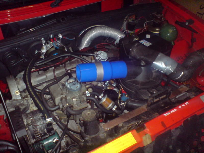

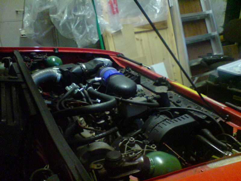

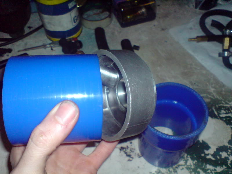

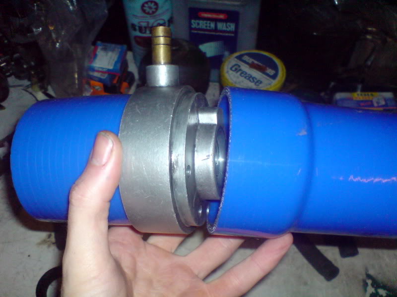

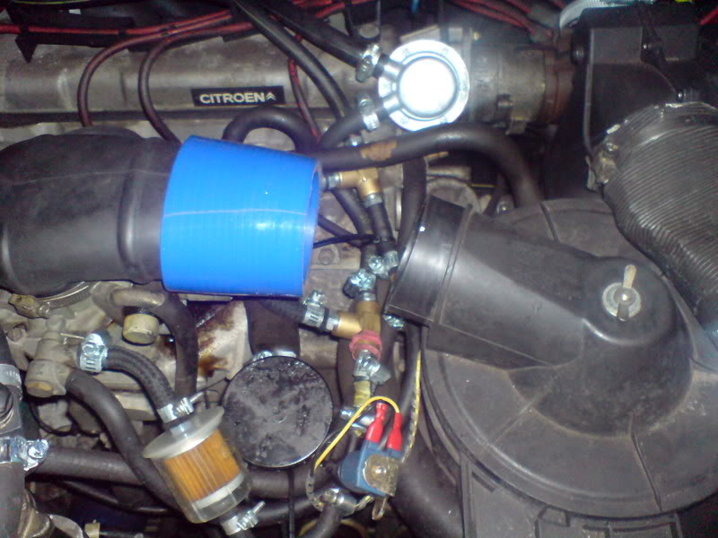

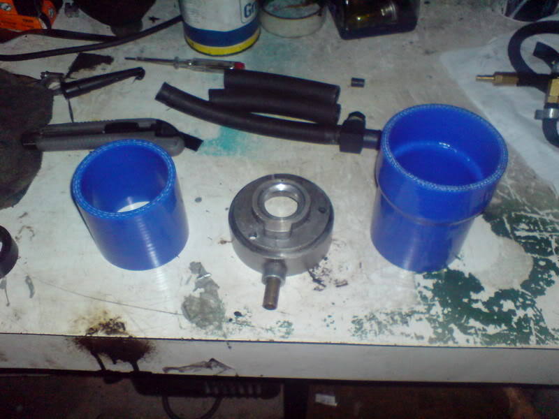

Mild update: after a long wait the adapters I needed to fit the 'normal' ring type of mixer arrived - they are barry boy style coloured silicone tubes! they were not cheap but actually fit very well and look suitably odd that pleases.
Packet had arrived:
The 70mm straight pipe, aluminium gas mixer and the 70-80mm reducer
Checking the fitments
Adapting to the intake
Fitted:
How does it run with the standard ring mixer (originally off an Astra) ? not very well! It does start and run but after some time the idling drops to a rough tickover and the driving is sluggish. It might be because the 2 adjustments on the evapourator have been untouched - you leave them screwed in for the BLOS mixer but with the ring mixer you need to adjust them - I don't know how to! I didn't get any instruction with my new evapourator and the one on the CX was S/H and I left the settings as they were. Unfortunately the LPG supplier is away so might just need to have a fiddle with the dials..
Will look into the ideas.
Packet had arrived:
Fitted:

mixer
Make sure the holes visible on the flat surface of the mixer are plugged, or you will not be drawing the right amount of gas through & getting a weak mixture. It looks like a mixer designed to sit on a carb top, with float chamber vents etc. I will try to find some instructions I have for tuning with this type of mixer/evaporator and send them on.

Cheers Huw, it was a mixer previously fitted to an Astra. I'd thought that the holes in the mixer were calibration holes - so they should be plugged? I think I'll give that a go this evening. I was concerned that plugging the holes would restrict the flow too much - the area of the 2 carb throats together is much greater than the diameter of the mixer center hole and the area of the gas slits together.
The tube is just pressed into the mixer and is a tight push fit - it's also held in by the air filter housing pushing against it (i'd made it a deliberate tight fit) but ideally the push in part would be on the other (airfilter)side of the intake as it's less critical but looking at the shape of the venturi in the mixer and the side the gas slits are located I concluded that the direction was right. However it DID come slightly adrift going up a hill! and started bucking - could be brought under control by reducing speed to 20mph and then I stopped and refitted it. I have made a mistake it seems! the air filter housing is seperate from the engine and there was a flex section on the air intake (I even included the flex part when using the BLOS mixer!) but somehow I'd forgotten about it.. I need to come up with a solution. Duct tape is helping just now.
I've been out in the car today and it ran ok but a bit sluggish - drives like an old diesel. It restarted after a park (<15mins) and when it started again it caught but was barely running - I turned one of the 2 adjustments on the vapo and immediately it raised the revs and smoothed out so I think I found which one does the idle! - still I'd be really appreciative of an instruction guide if you have one.
I'm tempted to just fit the BLOS thing back on as it worked so well.

In my fairly limited experience the mixers have to be small to get enough 'suck' on the gas supply. I think this contributes a lot to the loss of performance usually experienced. I found my 1.9 TRS was pretty dull after conversion, having been quite quick before. Probably the variable mixer is a better solution, as it will open up when you need a bit of power. Ideally, injection of course, but expensive+++. Megasquirt (home grown EFI) might be worth a look, although you would stil need to buy expensive injectors. I've found the LPG tuning instructions and can send you a scan if you send me your email.

Thanks Huw, got scans.
Also just returned from the garage: first thing done was to try the mixer the other way "just in case" but it ran like a bag of spanners.
Refitted right way and covered up the holes in the mixer and RUNS VERY WELL NOW!!!
thanks for the advice - not quite as smooth or flexible to drive as with the variable mixer but after a run (in the snow!) it now rolls pretty well - not like an old diesel!
Thanks again
