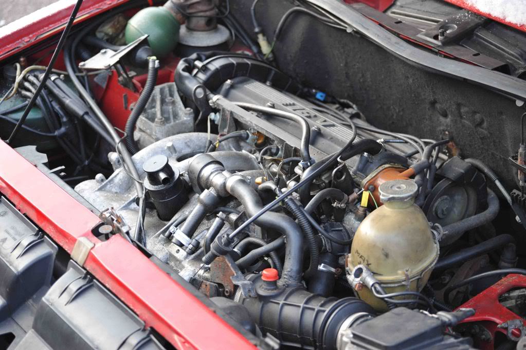

and here's the engine pic. the last garage found it more interesting to get it running without using all the parts:
Posts: 6437
The engine doesn't sound goosed and unrepairable to me, if it overheated and warped the head (causing a lack of compression through a blown headgasket and resulting in misfiring and general unwillingness to rev) then at worst it wants a replacement head and all the ancillaries switching over, as DFW's use different cams to most XU9J4's.
I can't see the block being no good, and thats good news.
ECU wise....they're so simple and basic they rarely fail. I suspect there are other problems with the car the garage are just not arsed about finding and have blamed the ECU. You can't really plug them in and read the info like modern ECU's, which is probably what they're used to....typing basically!
If I wasn't so far away I'd take a look. It certainly doesn't sound too far past it IMO.

I feel this car's certainly not past it - though I know next to nothing about the 16v engine and have only owned one fuel-injected BX. What it needs is someone who knows their BX16vs, or is prepared to learn. Many garages will run a mile: the only BX16v-running garage mechanics I've come across were in Middlesex (probably long gone) and South Wales.
However, I do notice something from the picture : I wouldn't expect ANY petrol BX to run consistently and happily for very long without any oil breather tubes in place.

DLM wrote:However, I do notice something from the picture : I wouldn't expect ANY petrol BX to run consistently and happily for very long without any oil breather tubes in place.
The pipe won't make too much of a difference to the running, if anything it'll only affect the oil pressure/breathing system. The other hose next to it is the crucial one...without that it'd run like a lump of shite (although it looks to have been bodged with sealant on the intake hose!)
My initial thoughts are that it's had a load of people unfamiliar to the quirks of the engine go over it and clearly fail to notice important aspects.
I've got plenty of spares here, so trial and error is always an option.
Poor running on a valver under load would normally be one of the following:
Spark plug chambers damp.
Intake manifold gasket perished (it's only paper!)
Breather hoses
Mickey-mouse dizzy cap/rotor arm or broken down leads.
Only time I've been stumped is on my own car, where it's developed a funny quirk of running shite at very light throttle only! Weird!
