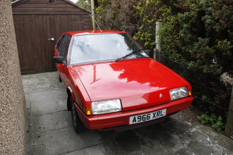

Cyril has been for sale of late as many of you might have seen - he's provisionally sold too but due to some problem DVLA are having in returning the V5 (it's been 3 weeks now!!) I can't -actually- sell him.

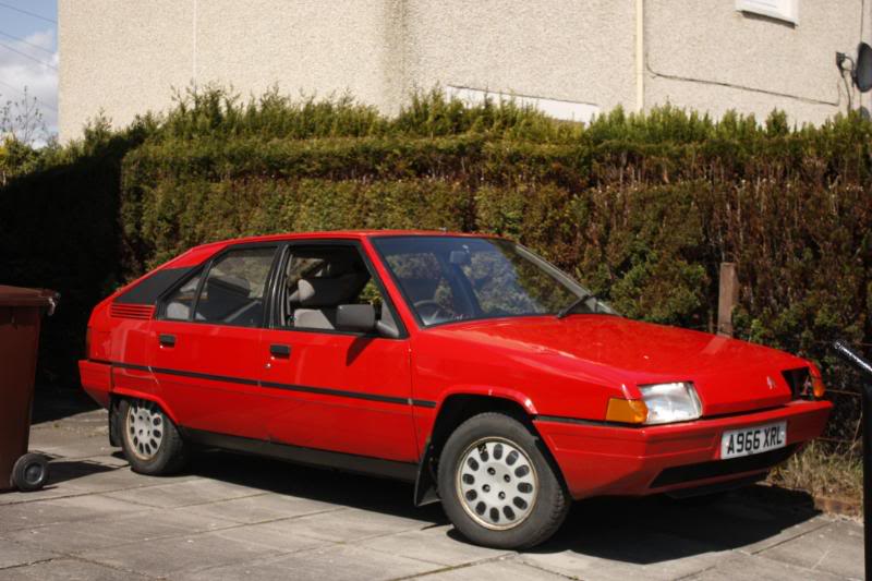

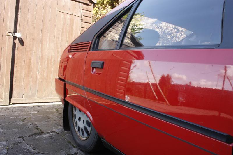

But at least I can go and take some photos of him - he's much happier than Aphrodite the CX was parked on my Grandad's drive probably due to the weather being much better now. Apologies for the following self indulgent collection..
The fabbyness of the Mk1.

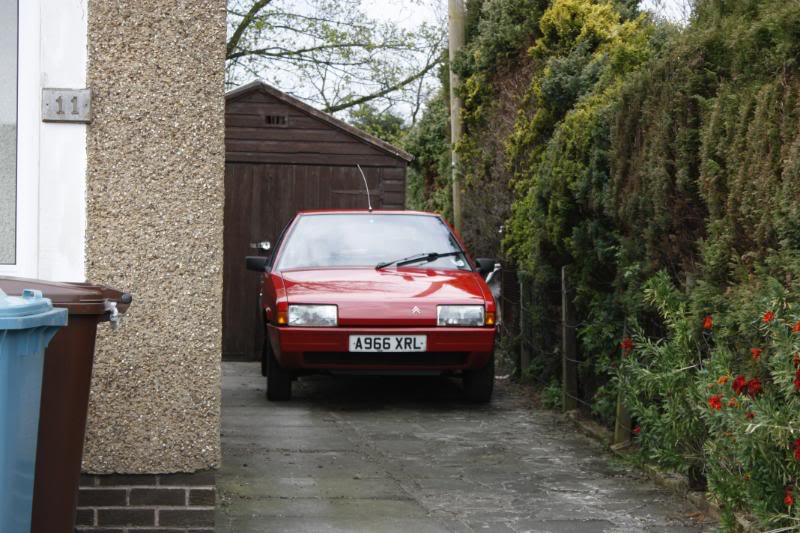

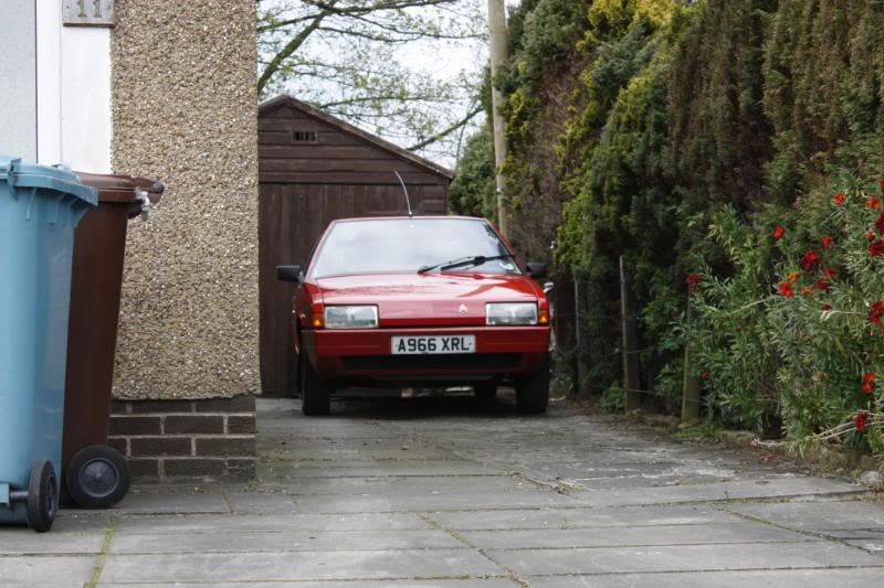

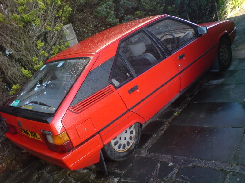

Cyril's (non) progress

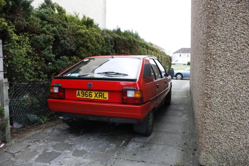

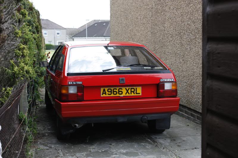

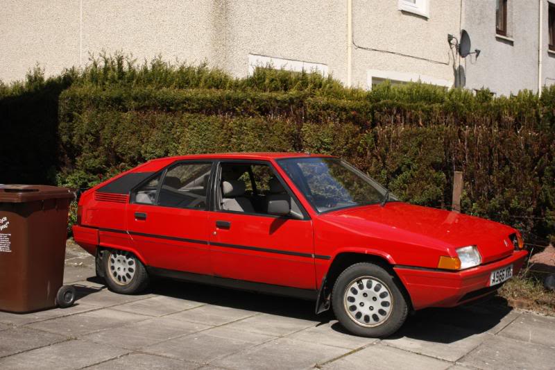

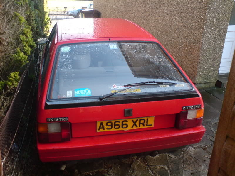

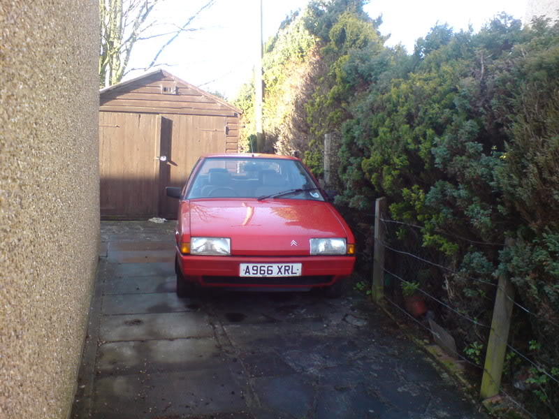

He's still just sitting there so I went over this week to get my monthly hit of BX fizz. I was going to remove a headlight because the glass had fallen off so I could take it away and re attach it. However I always start him up and give, if not a few laps round the block, at least back and forth on the drive. I noticed that after 4 weeks of sitting unused the suspension had as expected, sunk right down to the stops - at least the rear has - the front is still partly up.
Rear slammed:
Front still up a bit:
I expected the front to be held like this by sticky struts friction so gave it a nudge and to my surprise it was still rebounding with pressure! So after a month of no activity there's still pressure in the front suspension! I have never seen this on any Citroën I've had before!

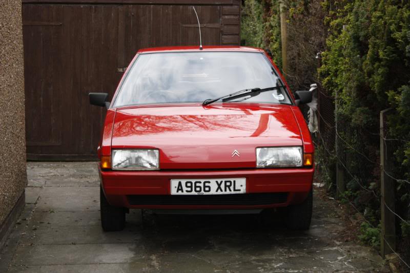

General snappage:
Basking in the sun

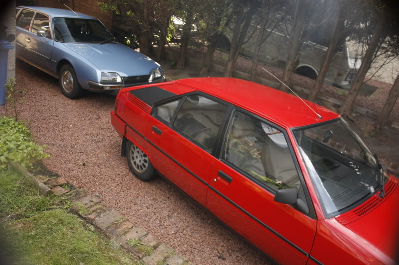

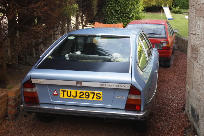

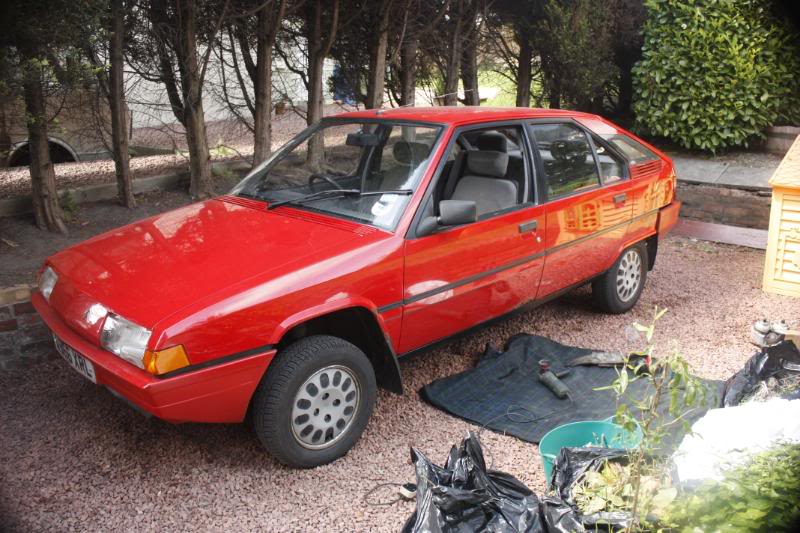

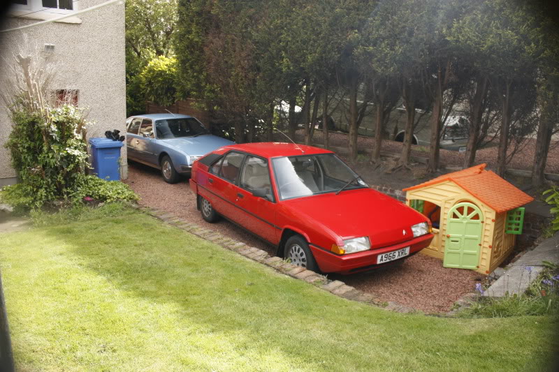

New MOT!! woo hoo
moved from my grandad's
next to CX

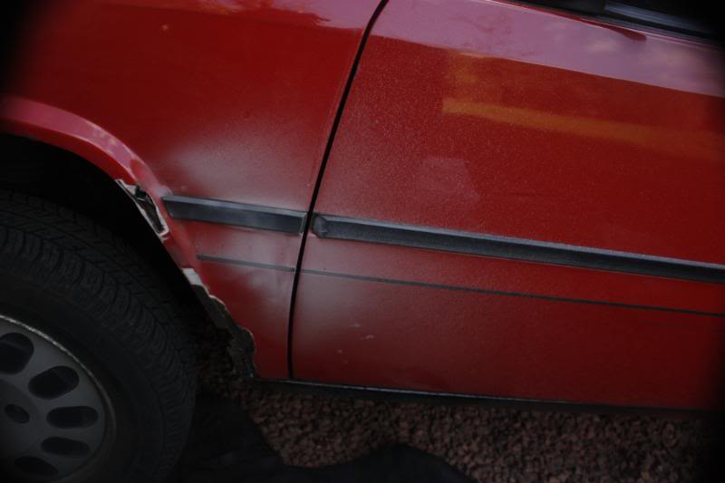

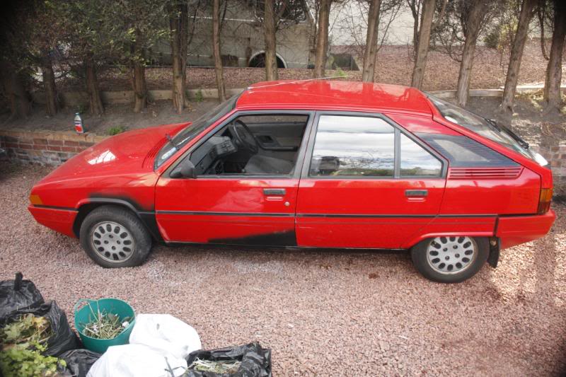

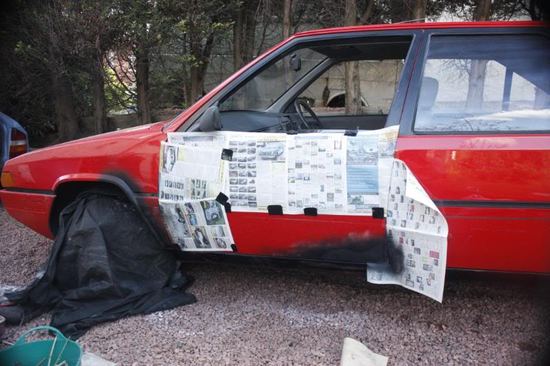

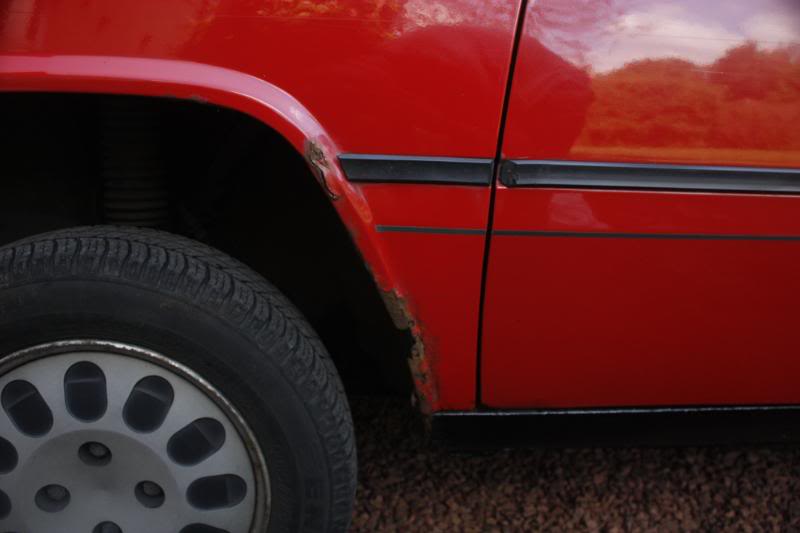

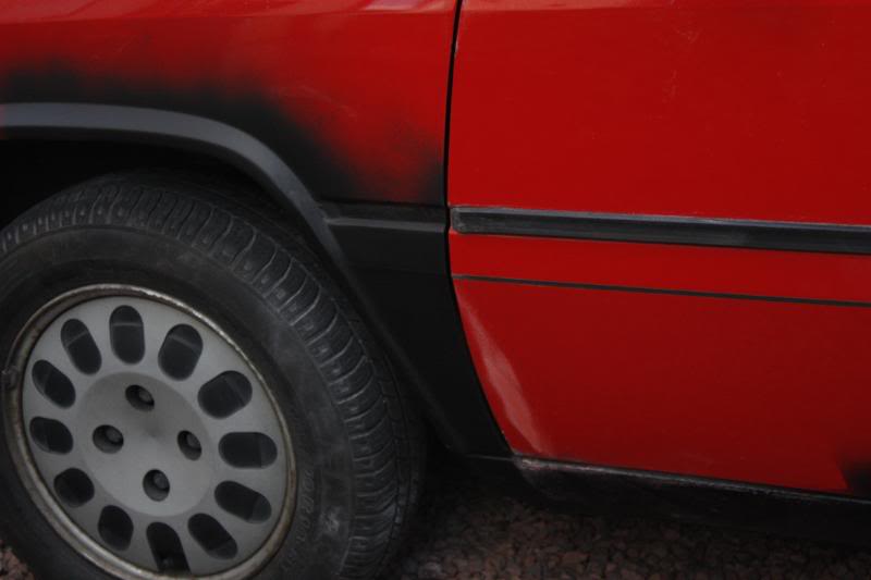

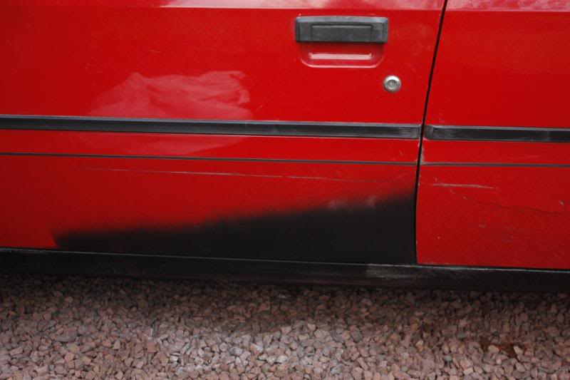

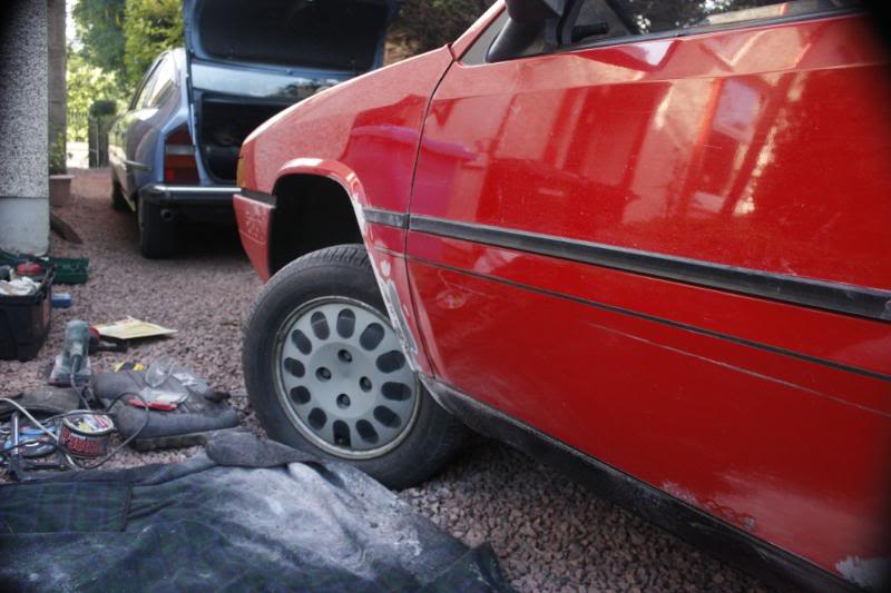

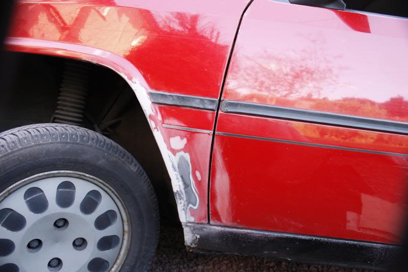

Some people would never use body filler! I can understand this but I can accept it as a temporary repair until I can get new body panels.

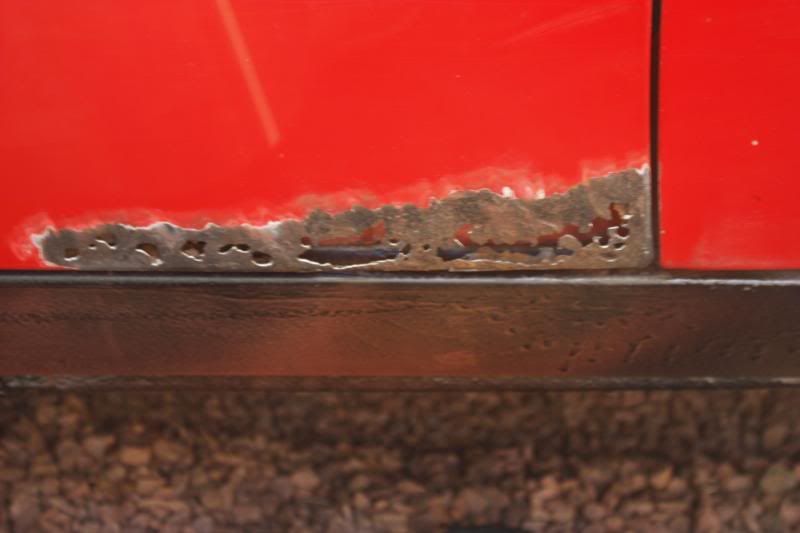

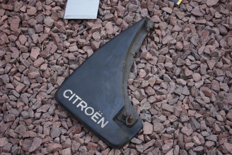

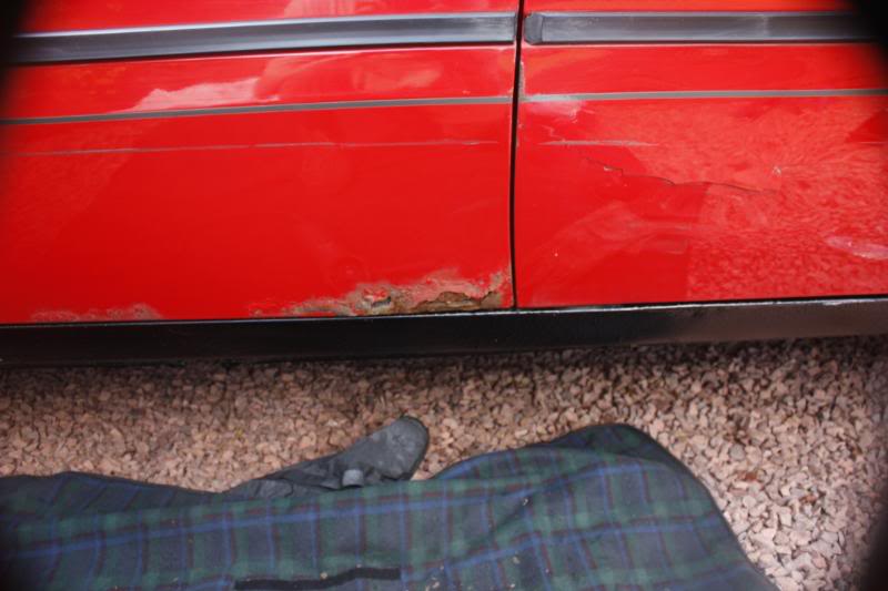

So! I decided to have a look at the big rust hole on the front passenger door of Cyril and the little bits of rust on the same side front wing that actually turned out to be 2 little bits of rust and one big hidden hole as a result of the genuine Citroën mud flaps.
the rust:
Ground the sh1t out of it:
Packed it full of the old plaster of paris
The mud guard off after a rusty old struggle
Great big hole
Grind the blot out of the rusty bits up front too
Got the old random orbital to work on the now set blat in the door.
And much the same for the front bit of wad
This of course, took several hours.

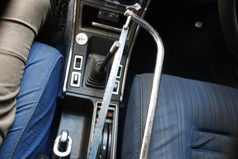

and in the 'drying time' i decided to cut the gearstick of the CX with a hacksaw.
Because I'm mental.
And shortened (please adjust your sets) this IS SHORT for a S1 CX btw.
Anyway, back to la BX.
Come on- this could be worse:

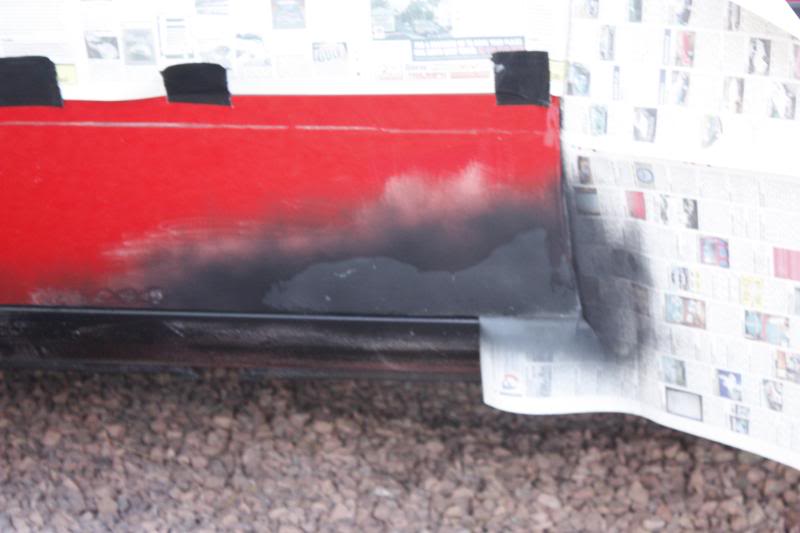

So, to make it worse, once it was all as smooth as my ass, I iz has paint on it.
Well, black primer. It now looks really shyte but is now free of flaky rust and holes etc.
First layer of rattle paint
So 3 layers of paint later and it looks like this:
So I really just wanted to make Cyril look worse lol

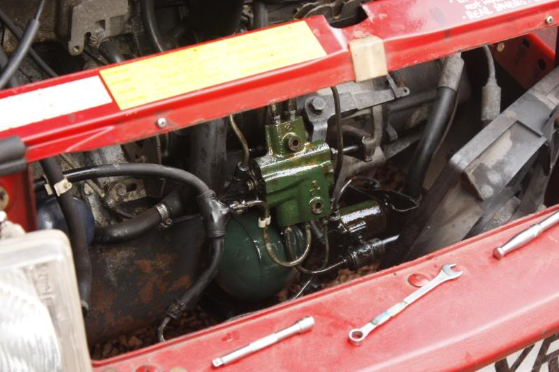

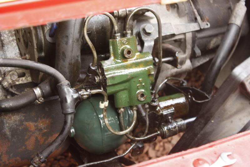

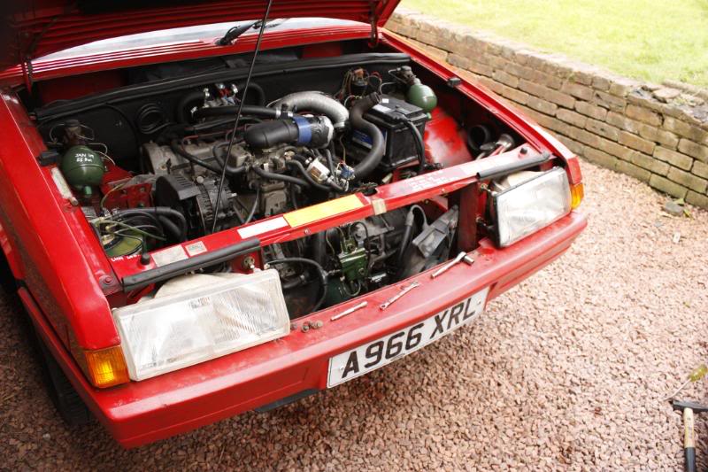

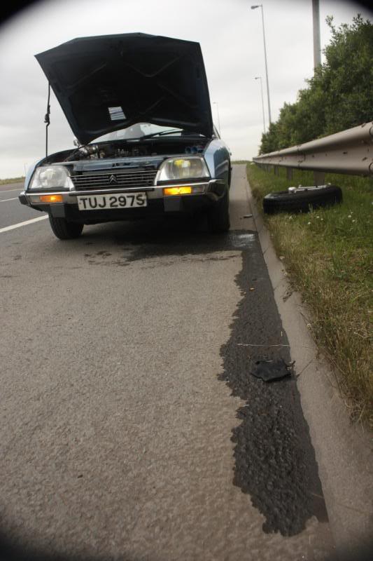

So it's looking increasingly like Cyril is staying. not least because the CX is giving me gyp - had to get RAC'd on Saturday after a cooling hose popped..
Hard shoulder heaven:
It's been having some boiling over moments and the RAC dude advised to watch out for the head gasket.. being a S1 CX and having only 5 columns in the mileometer, it's uncertain just how many times round the clock it is....
Anywayz, cyril has had some problems too - the PAS has been lacking and additionally, the PRV has been suffering from the old 'not cutting out' symptom.
Sometimes it'll just make the familiar dull hisssssss that seems to slowly bring the engine to labour (tho it never actually cuts out)
I decided that having replaced the HP pump some time ago and changing the LHM twice - still bad results..

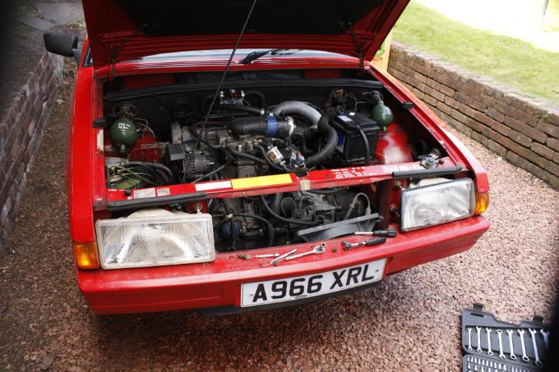

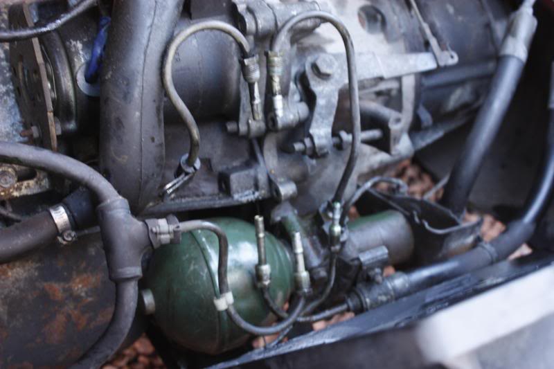

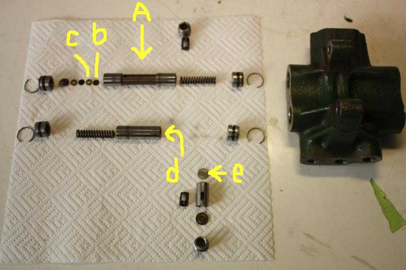

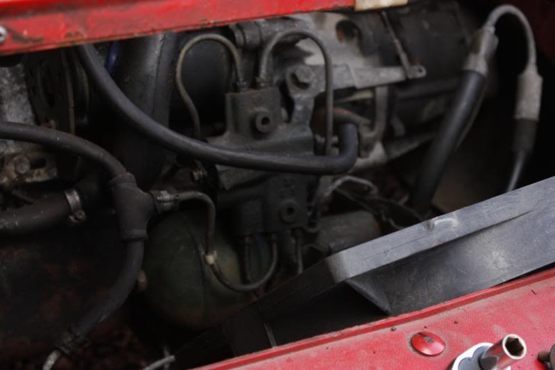

Next up then was the FDV valve. I've been wanting to attack this device for yonks - it fascinates me as it's one hydraulic device I've never explored...
So, to get it out I realised after reading the sticky in the tech. section that the radiator etc needs to come out first. So out it came.

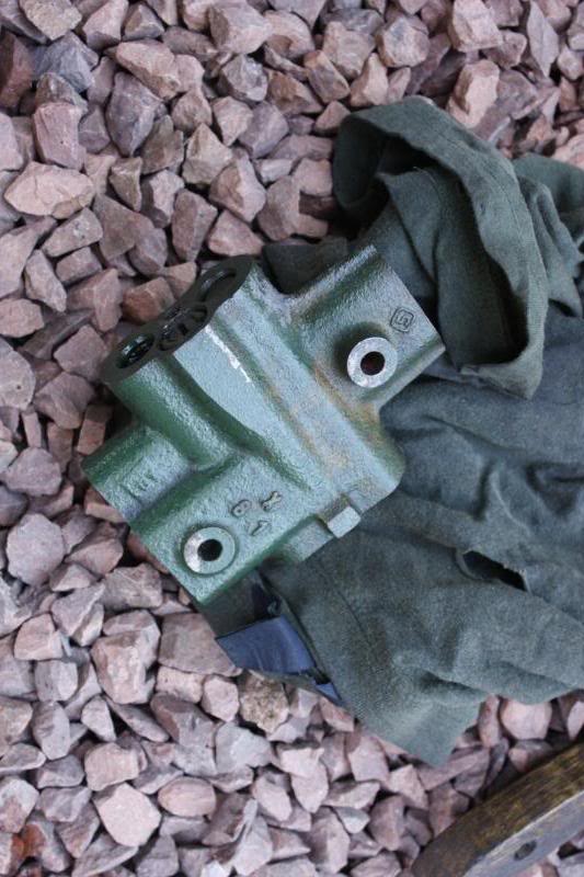

The familiar FDV
The beest out:
So wirds gemacht:
Heart bypass surgery:

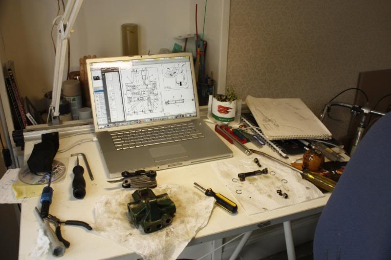

Indoors: there's something I really enjoy about revamping a component indoors.. I'm weird I know.

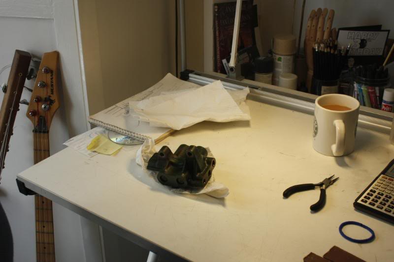

And me decided it would be even more satisfying if I had the .pdf of the FDv and the operating principle of the steering on the laptop
- you see! there's more to car maintenance than just car maintenance... er, yea - don't know what I even mean here..

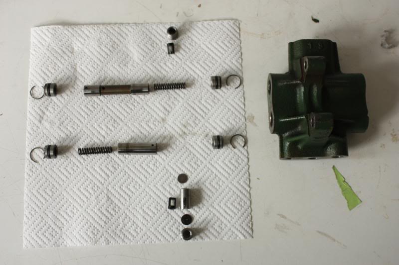

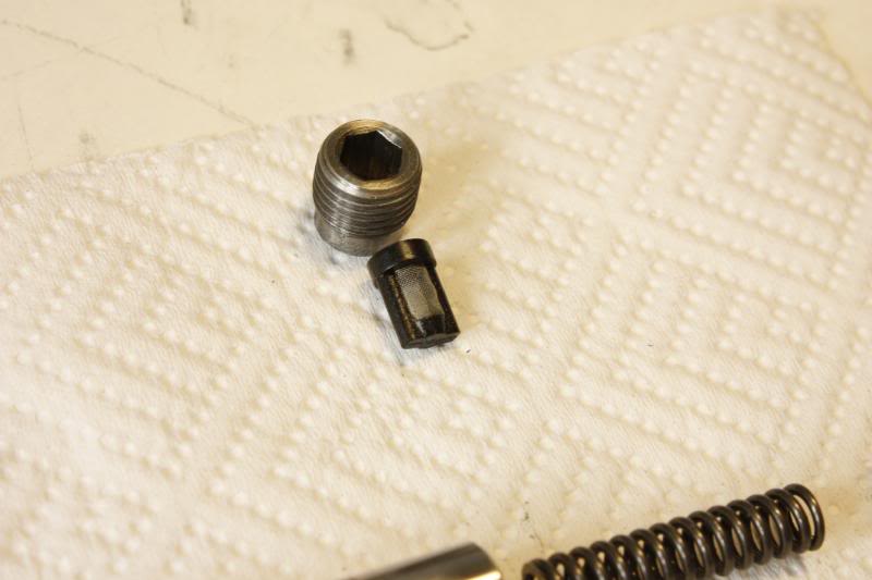

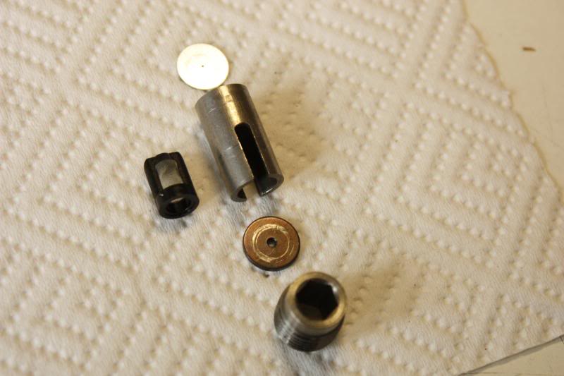

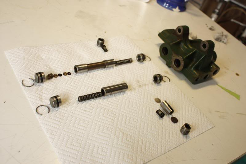

Next: the end caps and the 2 slide valves finally out after an epic 4.5 hour struggle with one of the four that JUST WOULDN'T BUDGE and I managed to slice my thumb etc. once all out I inspected the super finished slide valve bores.
With the slide valves, filters and metering disks out, you'll know this scene from the sticky
However, I wanted to have a look at the metering jets as outlined in the Citroën workshop manual. These are very fne disks with a very small hole in the middle. These govern how much of the hydrostatic pressure goes where.
So in addition to the photo in the Sticky about FDVs, the metering disks can be seen removed from the first slide valve:
A. is the slide valve
b. is the metering disk - very small, that divides (sic) the flow 1/4 to the steering and 3/4 to the pressure reg. valve.
c. is the brass spacer between the disk and it's twin brother - the second disk.. not certain why there's two in series but there are. I note that the disks and spacers are identical to the ones used in height correctors for the damper dash pot.
d. is the second slie valve used to prioritise the PAS pressure/ return flow when steering at PRV cut out. It also contains a single metering disk (not pictured here) that was different to the disks in b. Also there was only one disk.
e. is a single disk fitted in series with the filter and holder of the high pressure return from the PRV, the FDV uses this dupme pressure to feed the PAS when the PRV cuts out, the FDV decides whether this flow vs. the HP pump's flow is too much for the PAS and regulates it accordingly. The second valve also decides when the priority to the PAS is to be changed to 3/4 flow to the PAS and only 1/4 to the PRV (after cut out)
Close up
And of the filter and disk
ANYWAY
Here's the bits from a cooler perspective
-also note that both the nylon filters on my car are completely undamaged. The filter at the top that's in line from the HP pump did however, have a number of black chunks of rubber and some general shite blocking it - all removed.
Anyway, after some serious cleaning involving carb cleaner, pressurised air and some new LHM, the FDV was reassembled, cleaned, degreased and finally sprayed with clear gloss metal protector.
Slapped the bitch back in the car
A gleaming car part lol
Going back together
