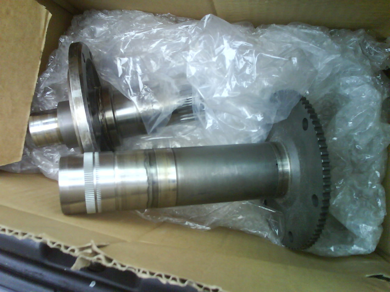

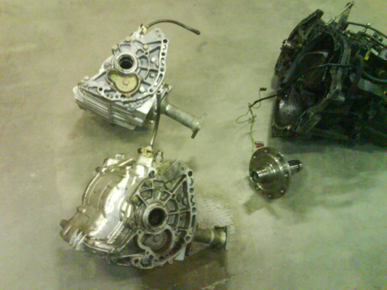

Here is some interesting picture who might interested they who own Bx 4wd
The first box on the picture is original Bx's TF box with better axels and behind is the box from Peugeot with better axels.
And here are the new axels
Let's keep 4wd's alive.. :D
