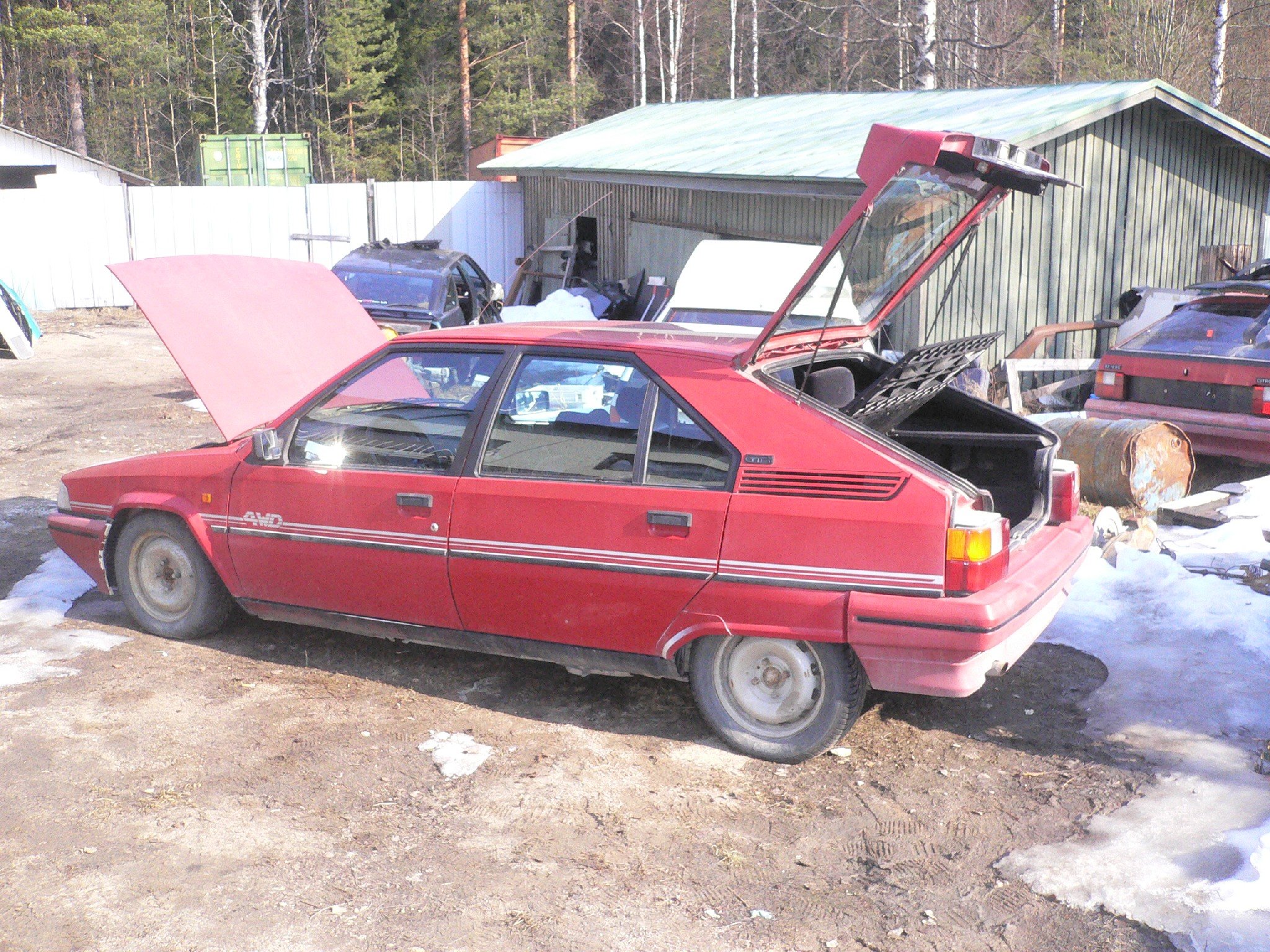

And here is starting point. I founded it from local yard of Citroen work shop. The axels in the original TF box had been wrecked and the rear axel had been collapsed and maybe colour had little bit discoloured?

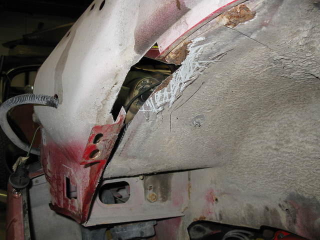

Before painting there is some rost which is so usually here in Finland. The condition is almost quite bad as Jeth's BX :(

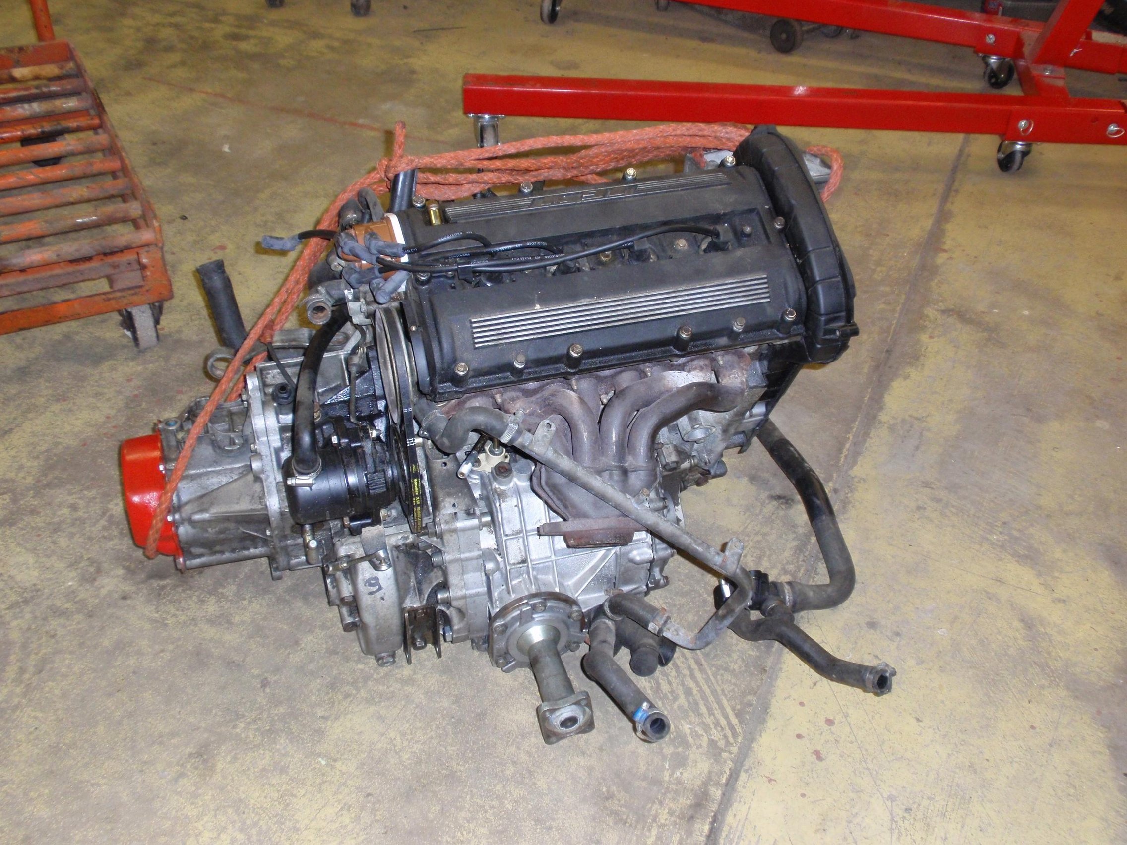

Let's put the engine and the gear boxes together

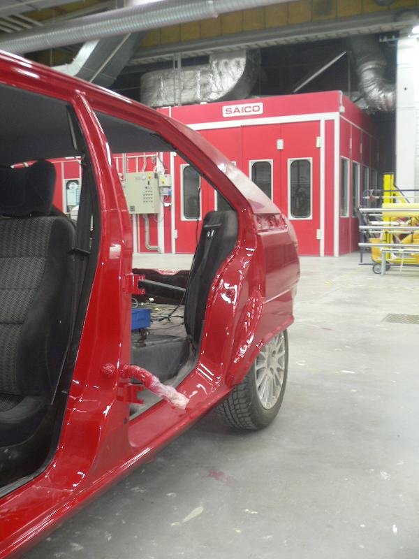

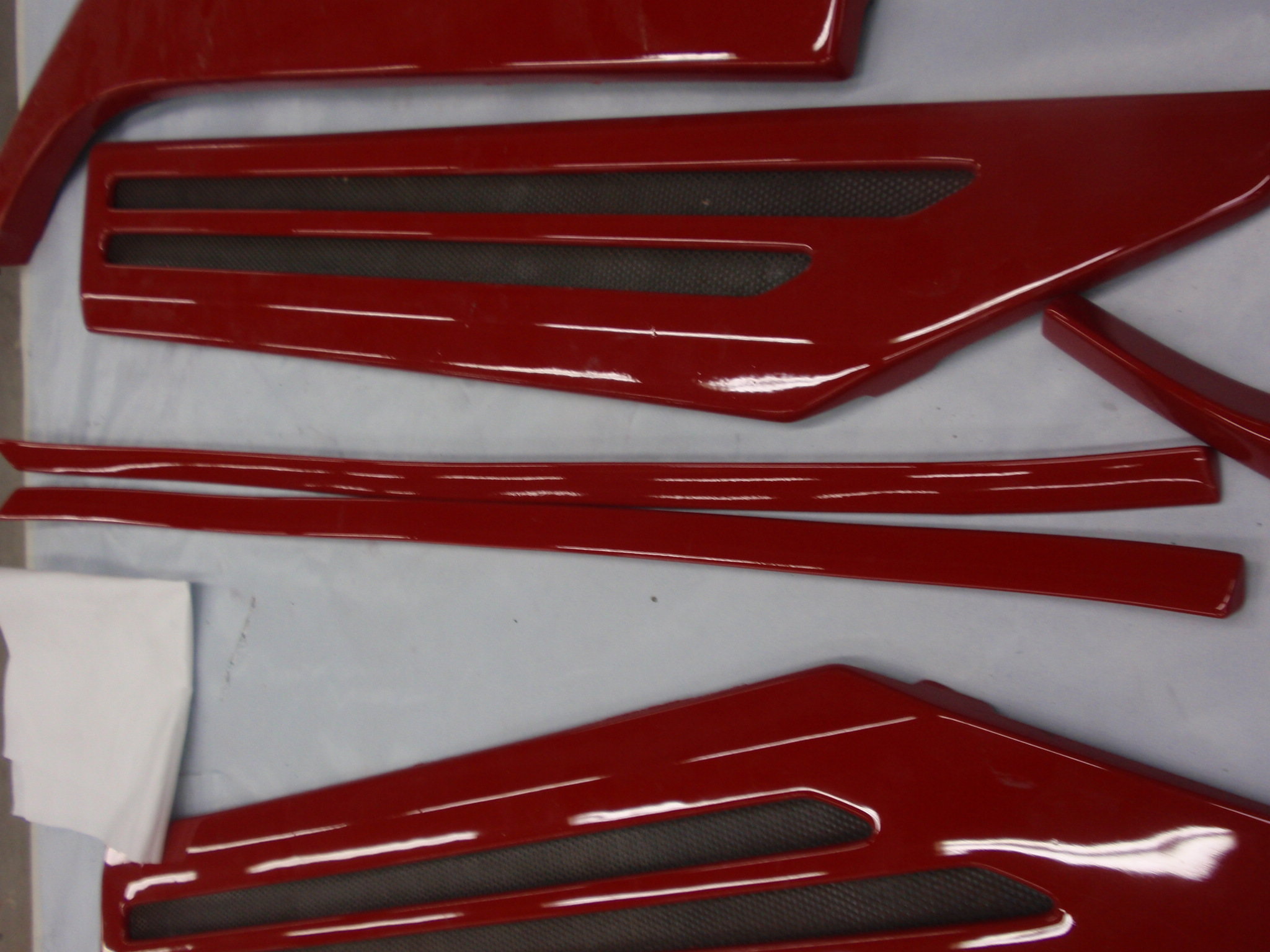

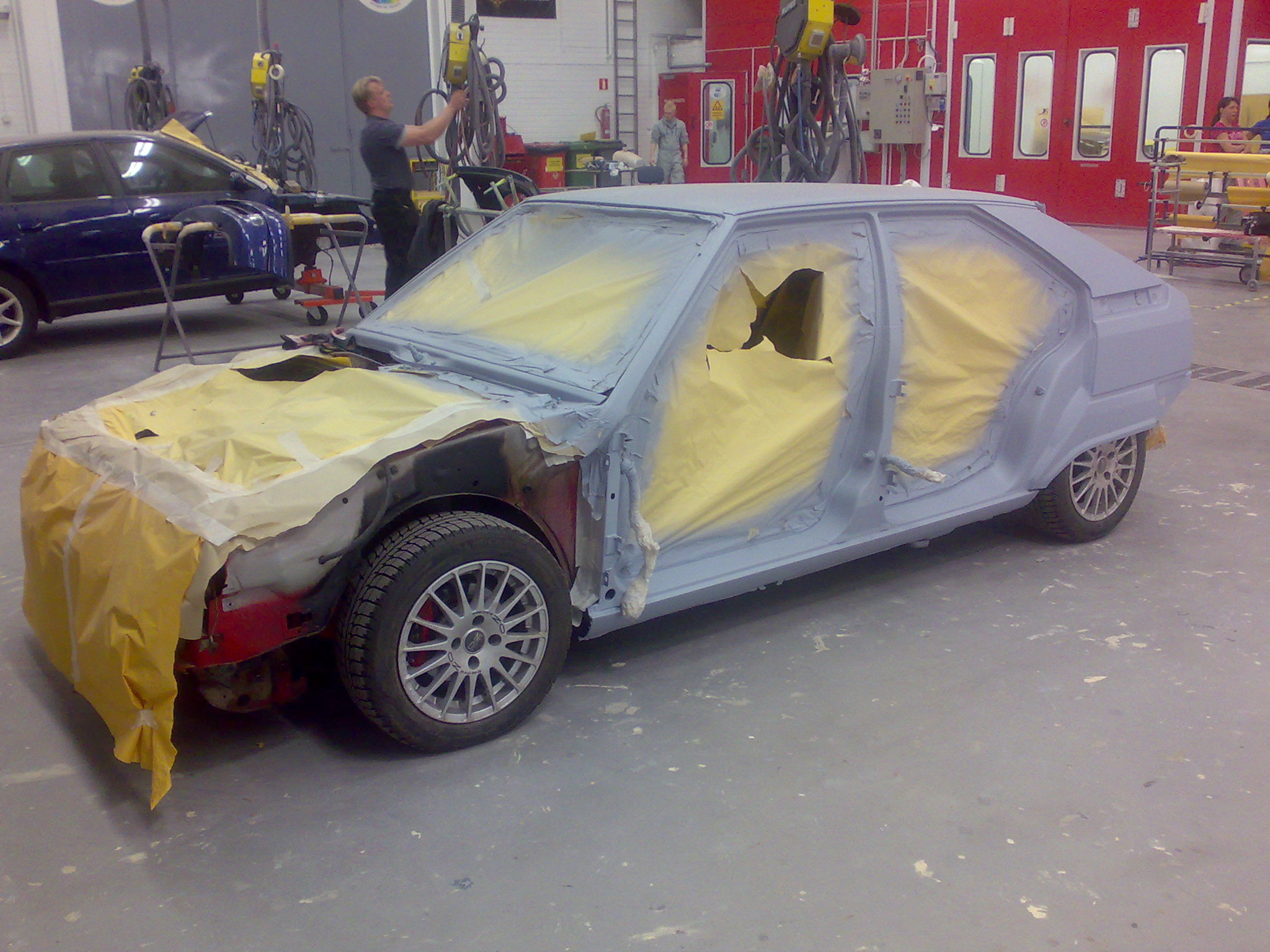

Some painting

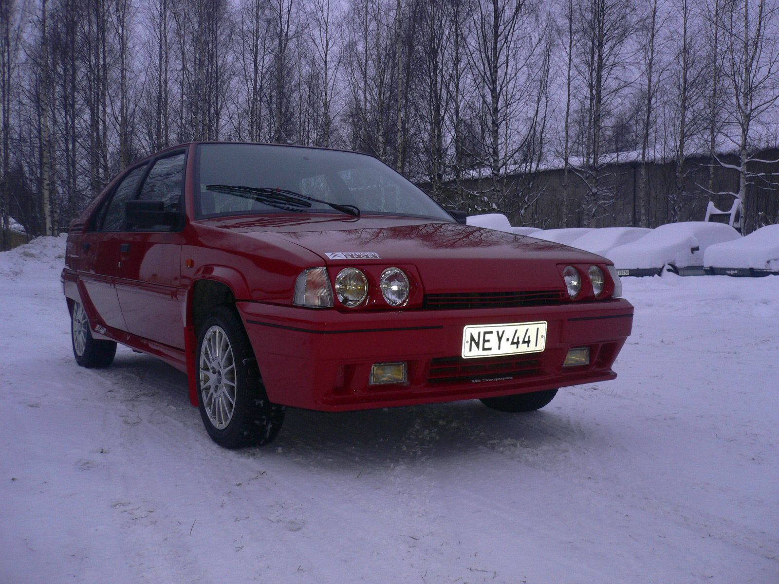

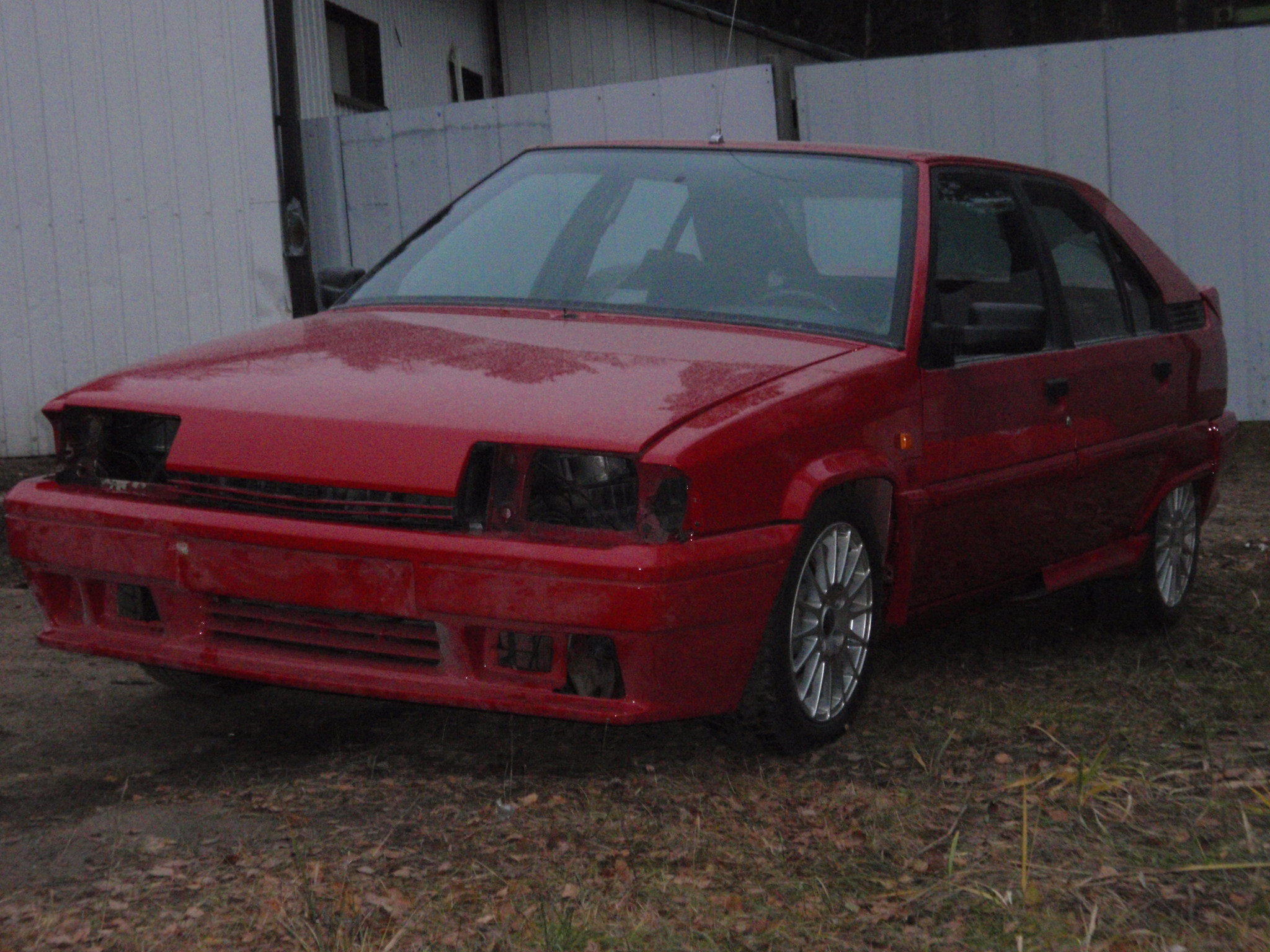

And now it is ready from outside and driveable.
Some work to do with the interior which will be changed to Monza black/grey and checking the engine and poor idle running. We have here in the southern Finland almost 30 cm snow and very slippery :lol:
