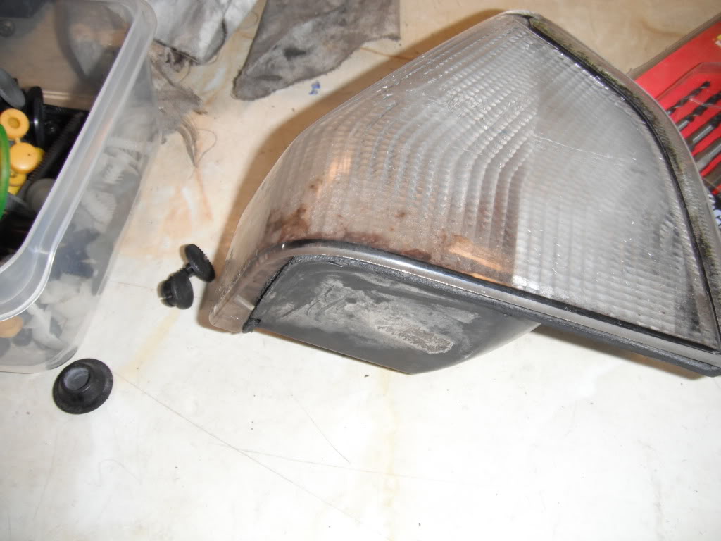

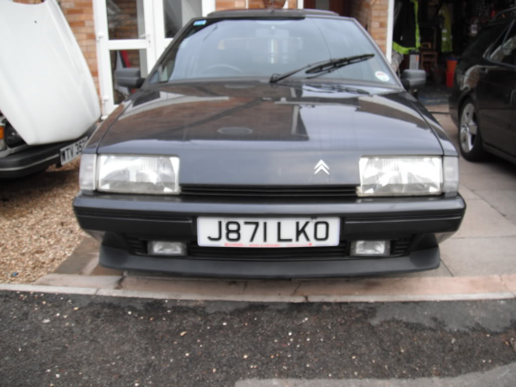

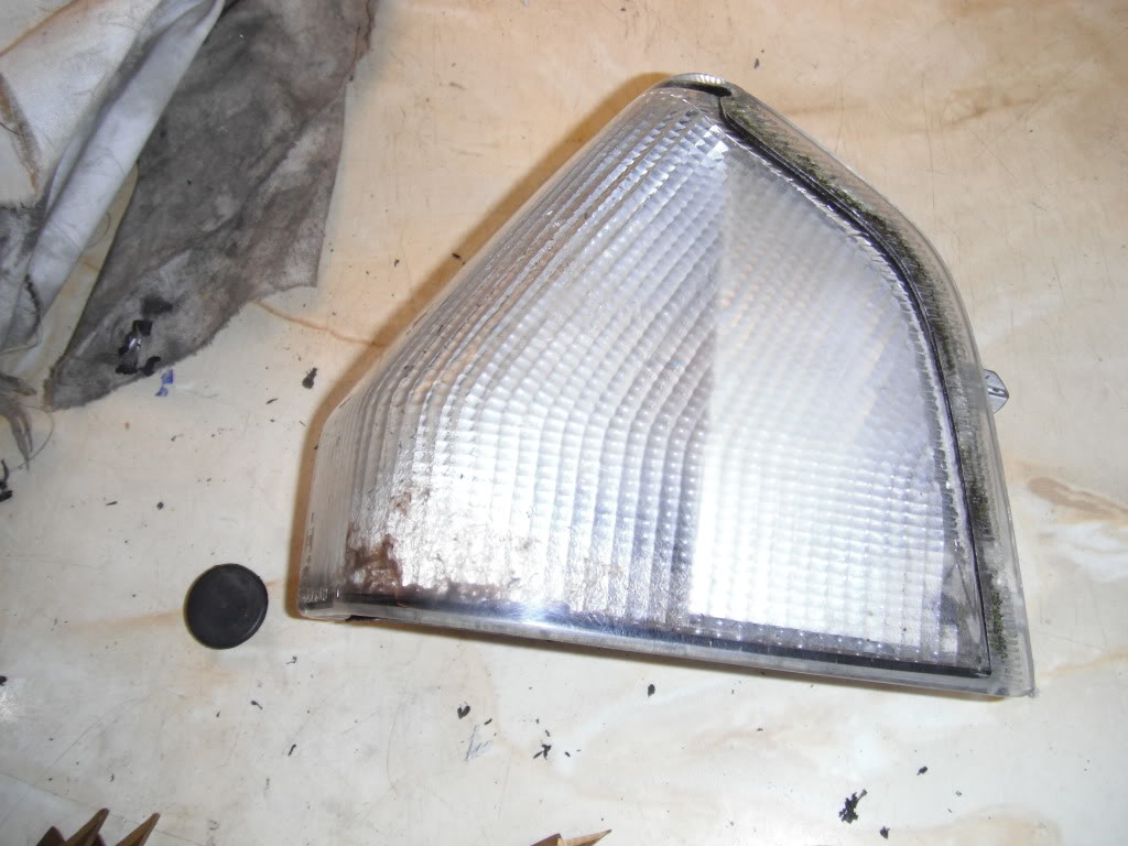

took the headlights out without too much trouble today.used a length of bar to push as i pulled.worked ok.

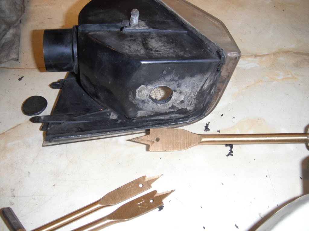

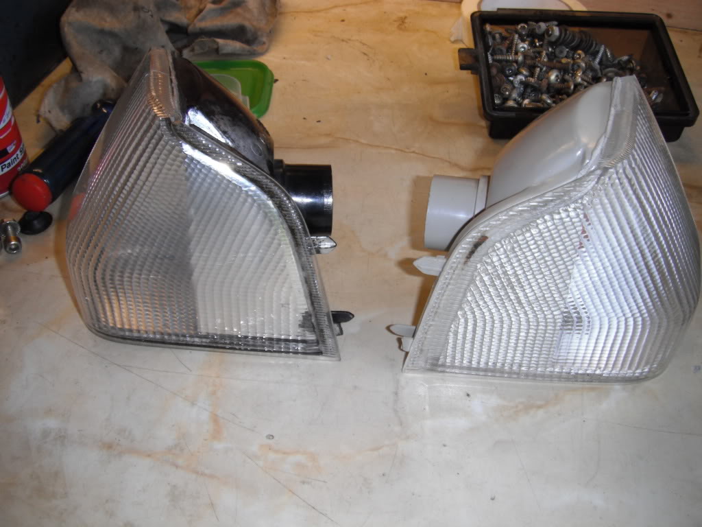

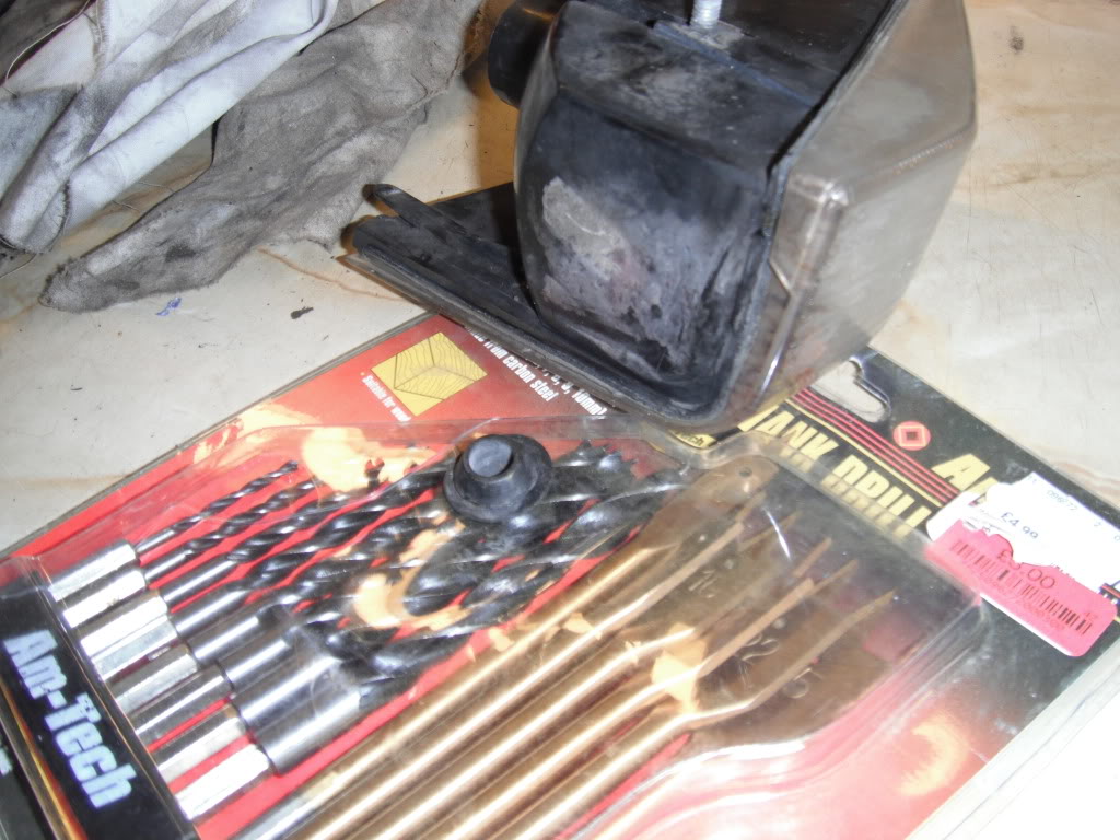

the lenses were awful in the indicators so they had the bathroom cleaner and hot water treatment with her majestys best pots long handle brush thing. took about an hour to get them reasonable.they will never be perfect though. i had to find a couple of rubber bungs and selected a suitable drill bit to make a hole in the base of each one in order to get the aforementioned bathroom chemicals and warm water into them. once rinsed i had them in front of the fan heater which is attempting to keep my shed warm enough to spray paint some engine bay brackets and the coil.
i copperslip greased the push on sockets before reassembly to ease the job for the next chap to remove the lights.
had to get some emery and wd40 into one of the bulb fittings to clean the contact and return normal service.pleasd with the result for not too much effort and hardly any cost-until she finds out i used the pot brush!

could you define cheap please? they are better but im not really happy with them.

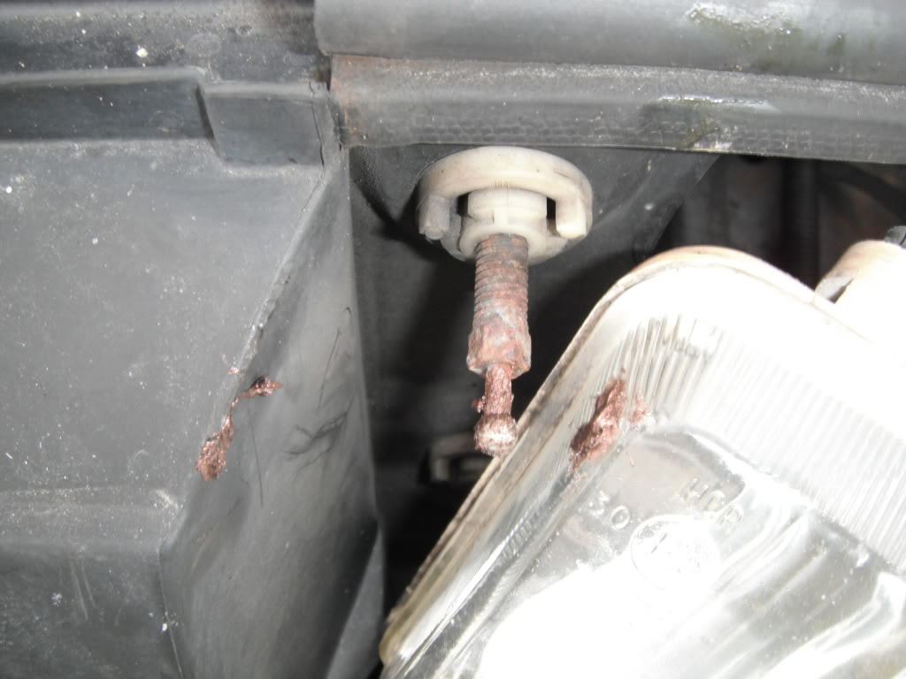

Just for completeness' sake, there's a couple of pics on re-installation of the headlights (in -25 deg C for no other reason than just for the heck of it):
"First engage the outer corner socket by sliding sideways."
"Then press the headlight backwards to engage the two ball/socket joints in the inner corner"

Great idea about drilling the hole to be able to get into the lens better so that the crap can be cleaned out. What did you use to clean them out with? perhaps you can use baking soda or something similar to really clean them out? It's a shame that the indicator doesnt actually come apart, but they appear to be glued together, so i think trying to get them apart would only break them, i think your solution is probably the best.
When you say you aren't happy with them, is it because the silver lining inside has degraded? If so, then i guess replacements are the way to go, just watch out for the cheap one's which don't have silver sides, just plain grey, they look crap.

the lense still have some algae in the join between the case and lense and there is some degrading of the silver inside. i used toilet cleaner-has anti limescale and bleach in it.and lots of warm water with her majestys best pots plastic brush.the hole was the only way to access the lense body so hole it is,rubber bungs were from the bits box! john.
